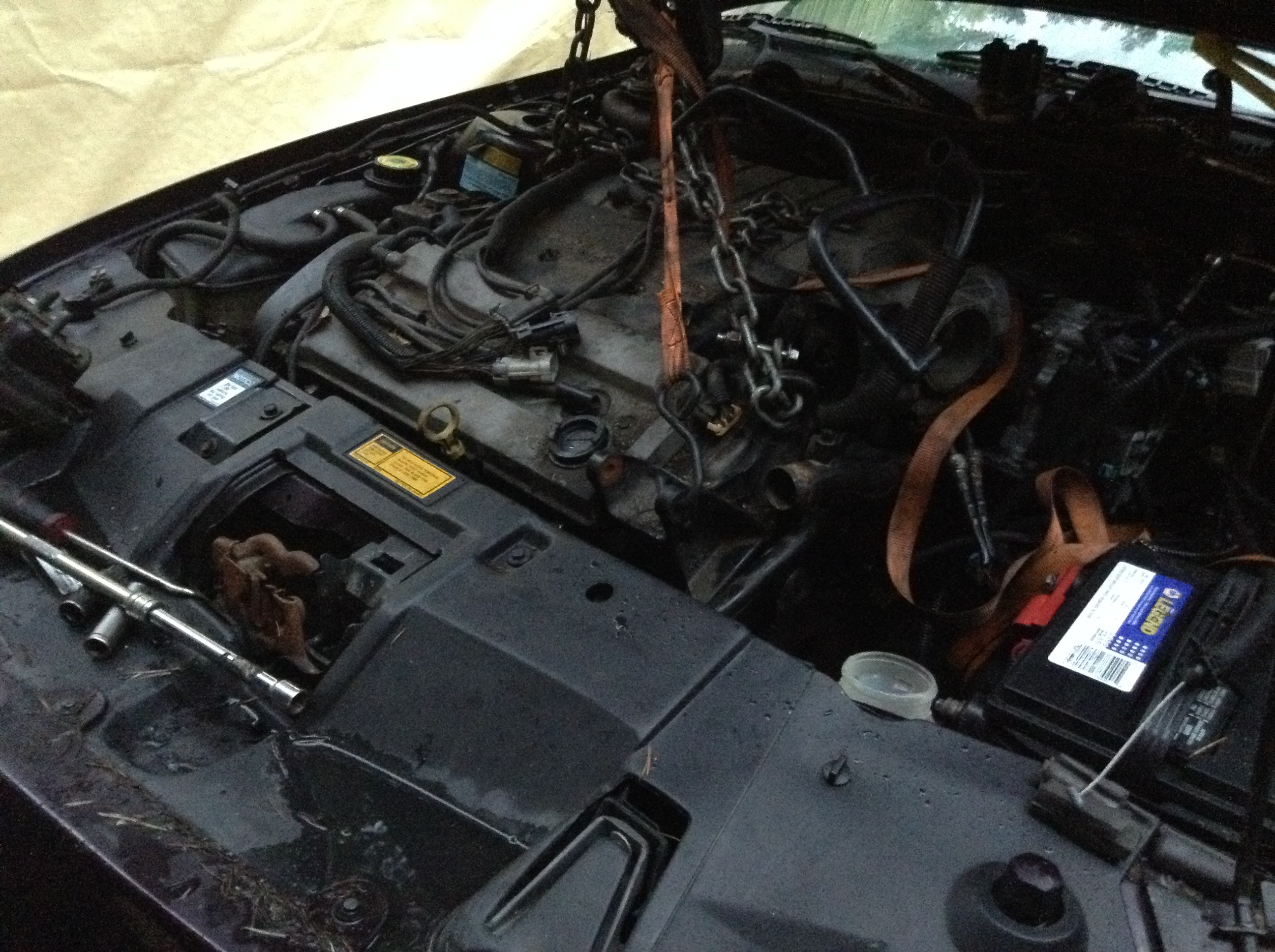

This is happening. FINALLY. :roll:

Look closer. 3.4 TDC. :D

I have wrenched and service-written for long enough now that everything starts looking like a repair estimate to me. I spent an afternoon test-fitting this engine, and looking over everything for real-world feasibility. The plugs (all six!) will actually be easier to change than a stock 3.1 MPFI or 3100, but my 3.4 DOHC is the last year of the older intake style too. The timing belt will be interesting to change, to say the least, but I'll put in a fresh one before final install of course. Considering that the belt does not go all the way down to the crank on this engine, it may not be that bad. I can't think of another timing belt engine that I would deliberately go out of my way to install, and I don't know if I would do it now if I didn't already have this engine, I really don't like T-belts overall. Water pump sits very close to the frame-rail, and yeah, it will be a PITA to replace that too. Same pump used on the other 60-degree Gen-2s and 3s though, so easily available and cheap to replace. Dito for the P/S pump. The T-Stat will be far easier to service than a 3X00, about the same as a MPFI engine. The accessory belt will be difficult, but considering that GM decided to make it necessary to pull the engine mount on the later V-6s to do that, a lot of our cars are harder than they need to be -I remember doing the belt on my old '90 'Retta in a parking-lot without any tools at all, thank goodness the tensioner was getting a little weak... Alternator will have to be done from underneath, but there is actually a good amount of room -an automatic trans would make it harder for sure. Clutch changes will be about the same as they are on the 3800 -I've written a procedure for this on my GTU, it is pretty straight forward (I don't even need an engine-support bar on the 3800 due to the excessive mounting braces I used on that car). Any other major repairs, the engine will likely have to come out. Not sure about radiator replacement -that might be removable from the bottom, some OE cars are that way too.
This isn't a weekend bolt-n-go swap, but so far it doesn't look too bad. Hopefully, I'll get more time into it this weekend, complete the front lower mount, start (or complete) the tranny mount (unless someone has a '95-era Getrag 5-speed mount they want to sell, cheap?), and begin the mid-mounts and strut-brace...

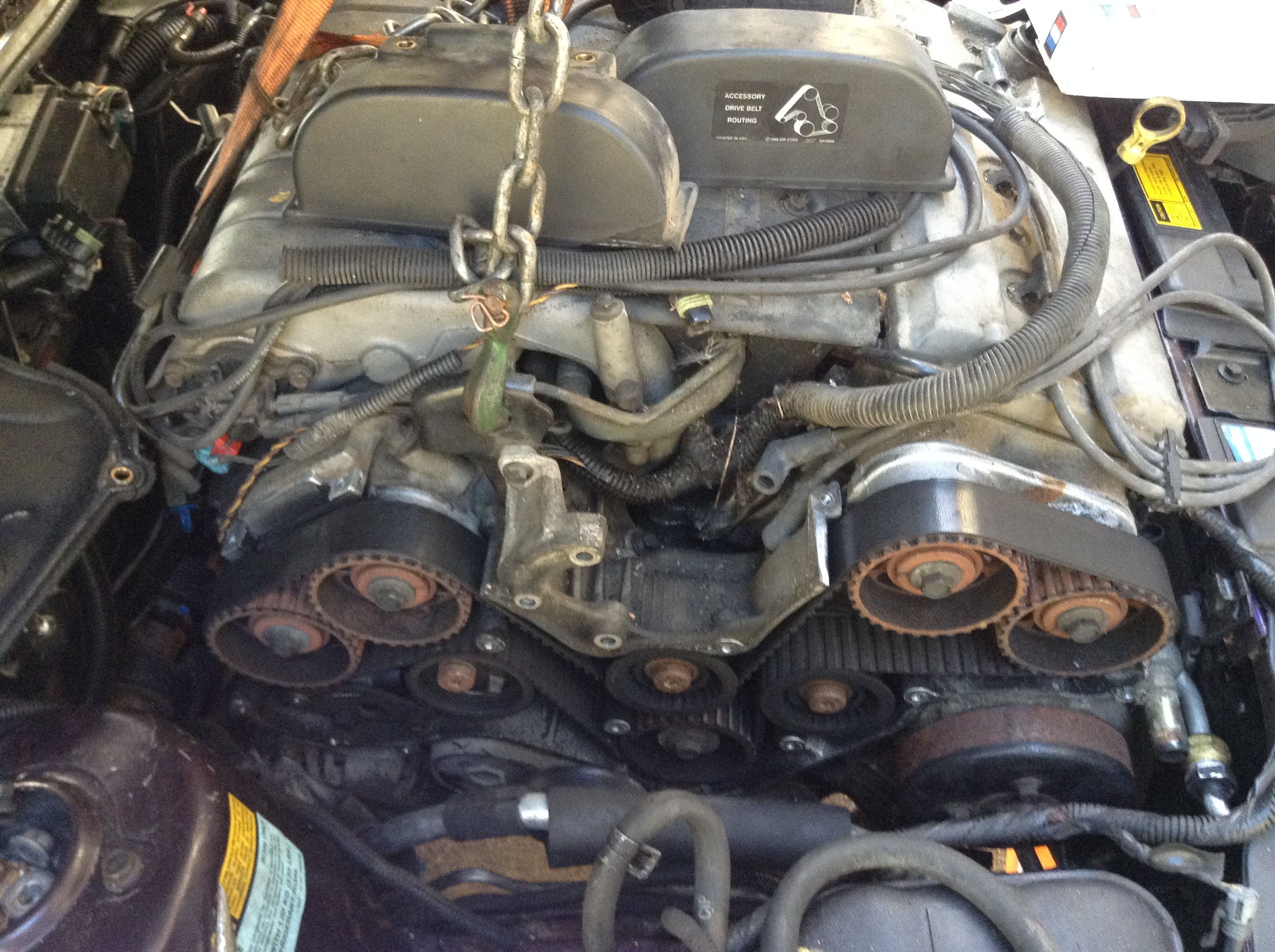

Got the timing belt done yesterday -used the short-cut method for now. Not bad at all, and although my engine wasn't fully installed at the time, I think it will be doable by dropping the left sub-frame to allow the top right side of the engine to tilt away from the strut-tower. The belt drives nothing but the cams, and does not reach all the way down to the crank, so in some aspects this is easier than most T-belts. The tensioner is beautifully simple and effective. I would do two of these over a Sienna T-belt any day, and three of them over a Mitsubishi DOHC 3.0 Eclipse... Later, I may retune it -this engine has infinite cam-timing option do to its' unique design (not the only one to use un-keyed slip-gear adjustment, but this was not common back then), and there is some documentation proving a 6-13 degree exhaust-cam retard and some intake cam advance improving low-end and mid-range, but it sacrifices some top-end performance past 6600 RPM (yep, past 6600). This may be with the newer, larger intake though, I will research that more later. For now, I am retaining original cam timing.
I also pulled the old spark-plugs, my engine has a LOT of corrosion in the front bank of plug-tubes. It shouldn't hurt anything, but it was sad to see -this engine has been garaged since I salvaged it about a decade ago -too bad it never went into a car earlier than this. The plugs were in great shape internally however, and a quick bore-scoping showed nothing of concern on the front bank. I poured some 5W20 into the cylinders and let them sit a little before turning the engine over, and it moved fine.

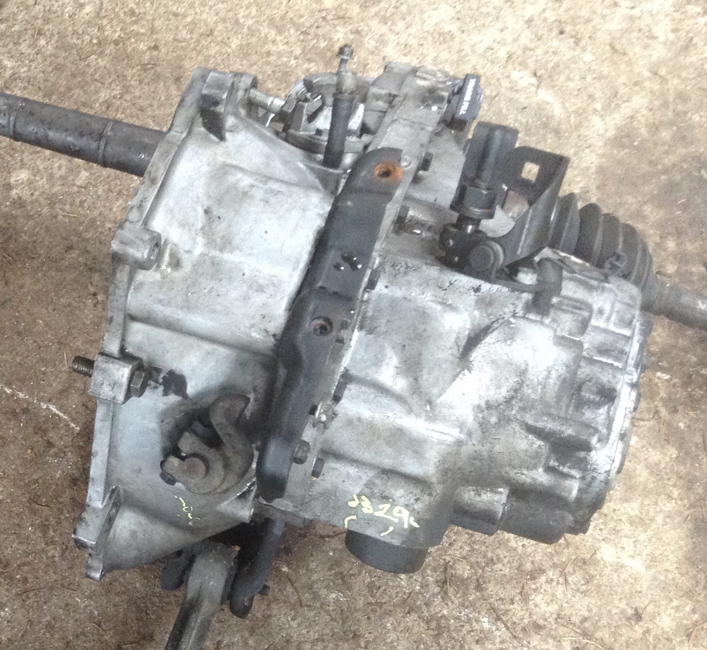

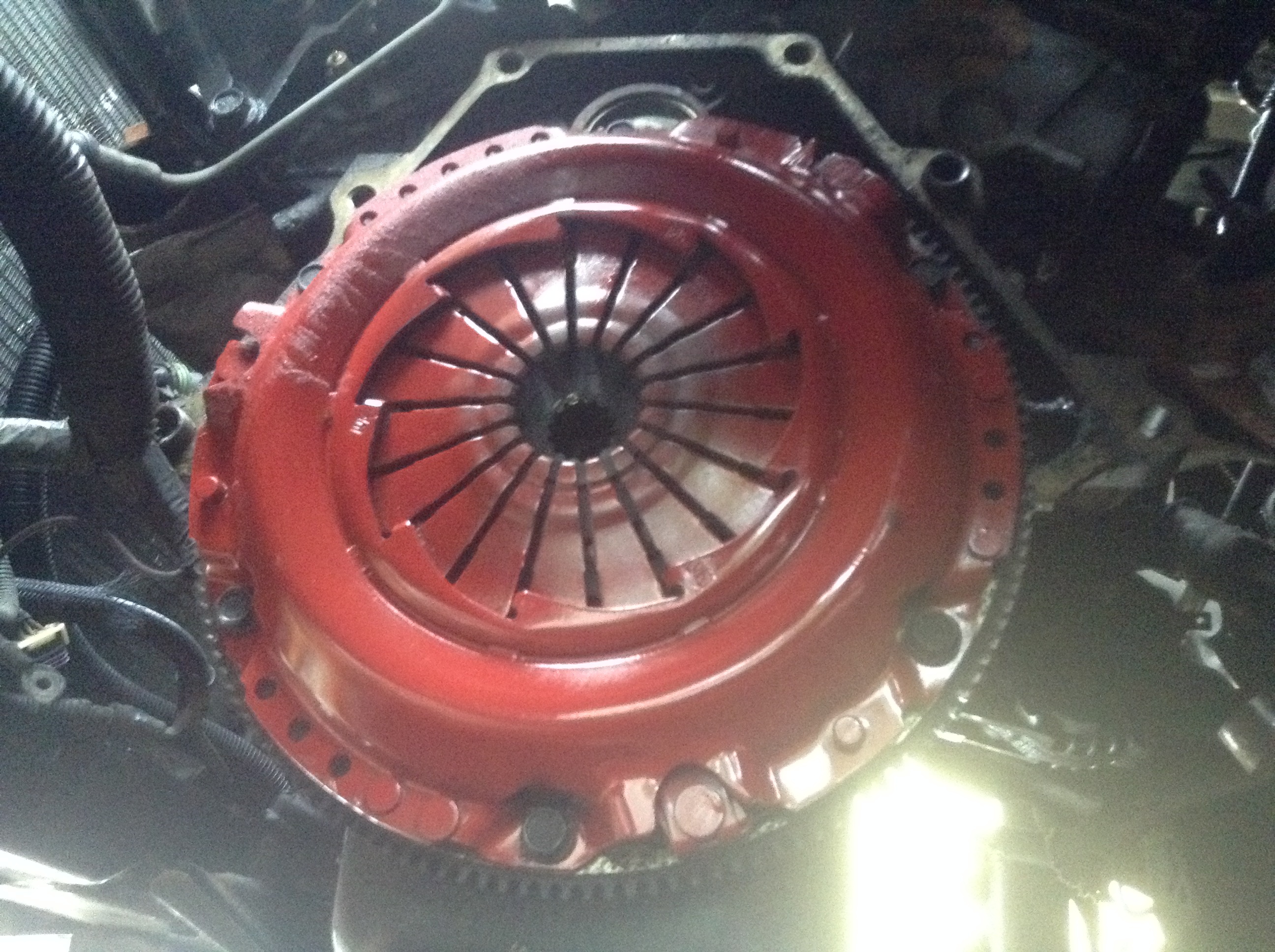

Clutch is in, an LUK pressure-plate, with a Clutch Masters ceramic Stage 3 puck-type disc (from the 3800 GTU's earlier MG282 -the first clutch I had in that car that could hold its' torque), and an original GM flywheel, freshly resurfaced. SKF throw-out bearing completes it. Everything (except for the ceramic disc) including the transaxle was donated by an '88 GT, which also gave me a spare Z51 setup... 8) Got the tranny bolted-up after chamfering the input-shaft splines with a Dremel for easier install. Front lower engine mount is in, might need some adjustment though. Looks like I can use the stock exhaust manifolds, the rear outlet will clear the firewall how I have the engine positioned (until I am ready to put in a turbo with custom headers... :twisted: )

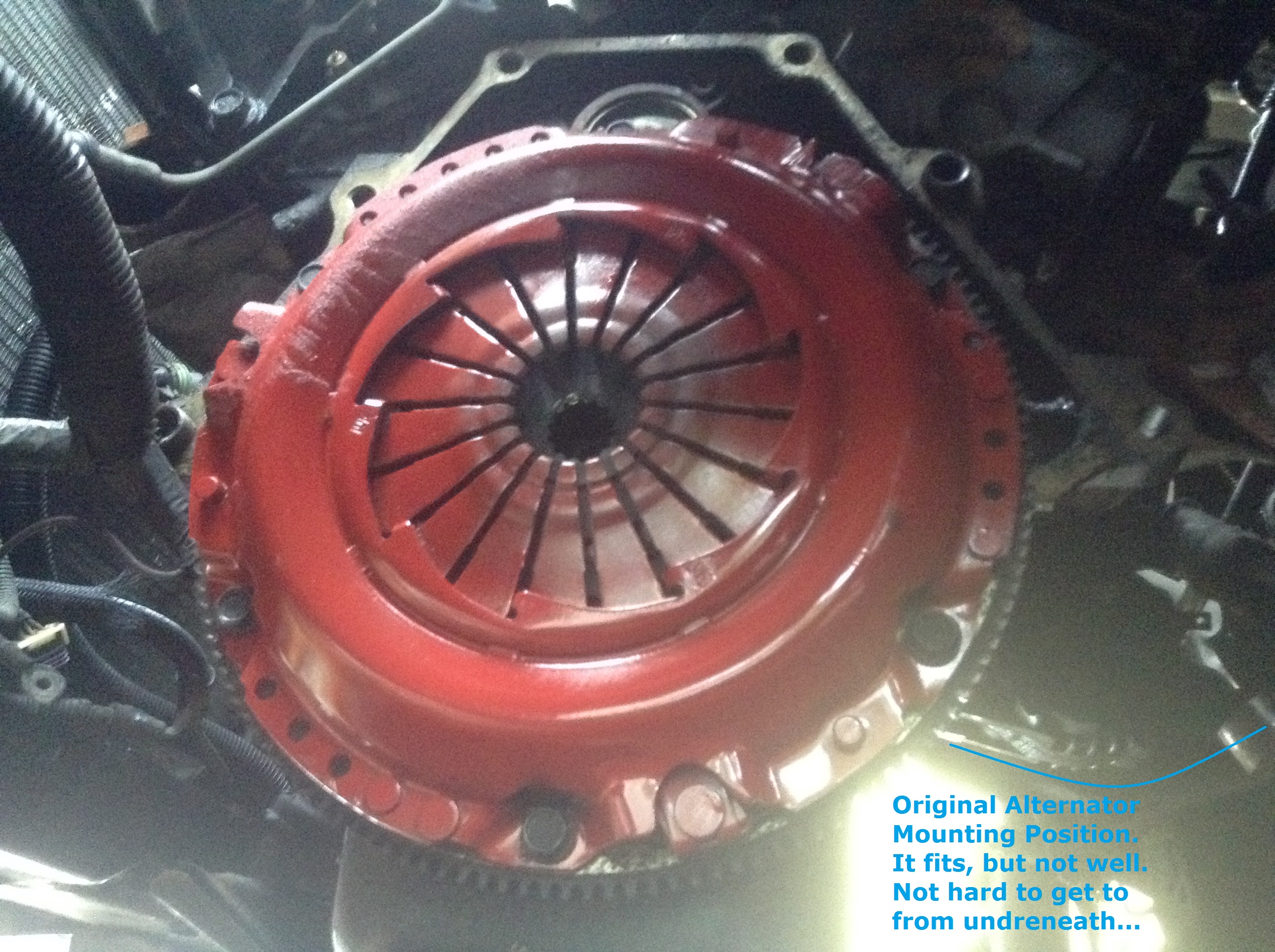

Another afternoon on the DOHC Z... I've been shifting the engine around in the bay, lowering the front, lifting the rear, pulling it forward more, putting it all back again. I really don't like how close the alternator pulley sits to the rear unibody framework as it arches down to the central sub-frame mounting point. I have maybe millimeters of clearance as it also angles inward as it arches down. I finally made the decision today that rather than hard-mount this engine in the bay as I did the GTU's 3800 to ensure that it doesn't hit things while shifting in the bay, I would relocate the alternator. The compromise will be losing the A/C system. Where I live now, the weather is pretty temperate, and A/C is really not necessary. I would have preferred to keep it in place, but I would rather delete it in exchange for a more functional engine install. So, now I will have to fab-up some adapters to mount the alternator in the A/C compressor spot, and take a little time to remove all unused A/C parts that are practical to remove. I will also re-align the tensioner assembly, and will have to measure-out for a shorter belt. Lastly, I will have to notch the plastic timing-belt covers for the serpentine-belt to drop down to the crank from the P/S pump instead of routing down and back to the alternator. As a note, pulling the alternator was pretty easy from the original position (more so than with this engine in the original Z34), so building this car that way and retaining the A/C would still be valid, just a really tight fit. Another plus is that I should be able to drop the engine a tiny bit more, thus lowering the center-of-gravity a bit.
Posts: 1843
Re: Finally...
Done with most of the alternator relocation work. Much happier with this as it sits now. The alternator will have to be pulled from underneath, but that was the same as before. Probably about as tight -not too bad. The front engine mount has now been changed-out from the stock Z34 piece to a Mopar big-block mount (an extra I had sitting around in case my '70 Plymouth needs it, once I finally get around to finishing its' build), and two tabs welded to the right sub-frame for the bolt to go through. I'll get pics this week. Still a long way to go, but it is at least moving forward. :pardon:

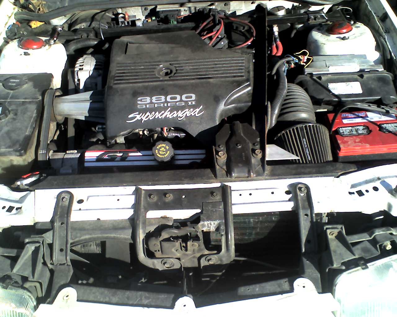

Here is the GTU, showing the H-brace that ties the radiator core-support and both strut towers together.
