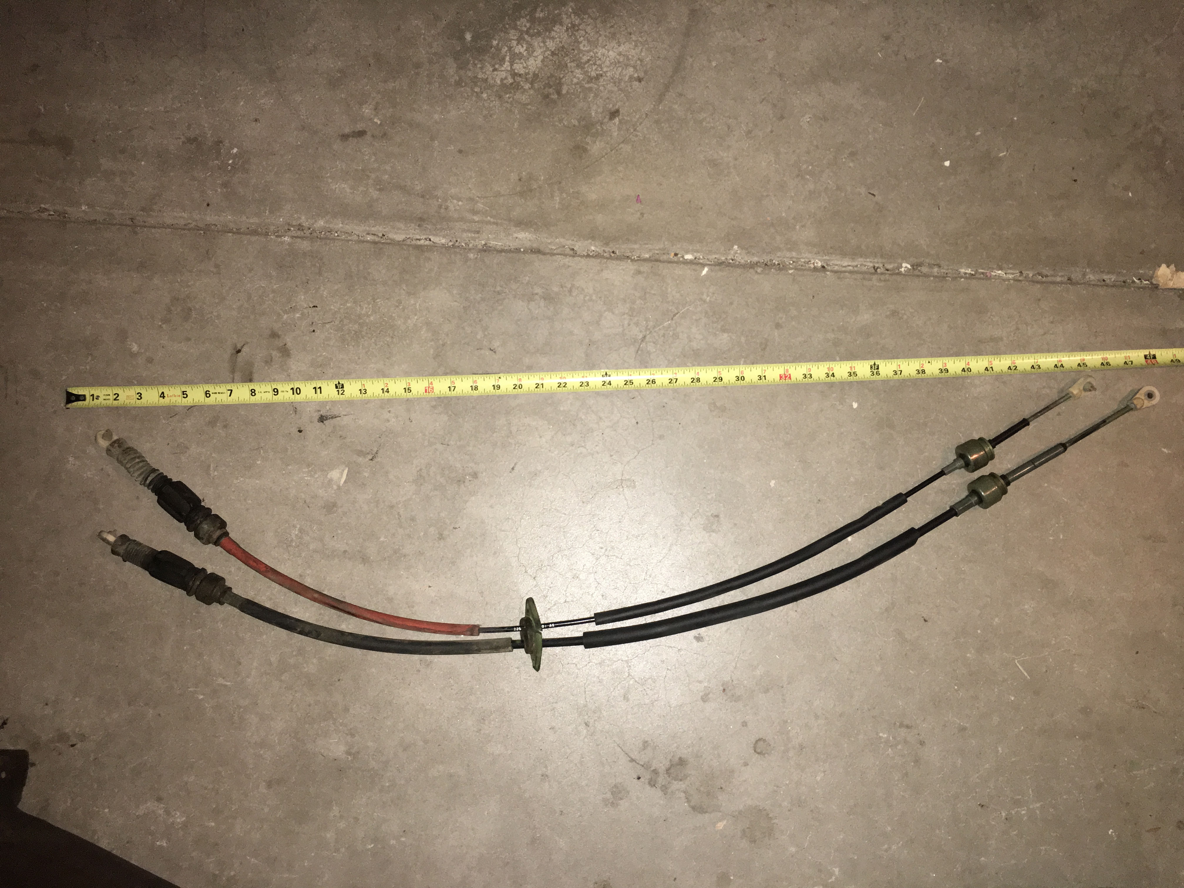

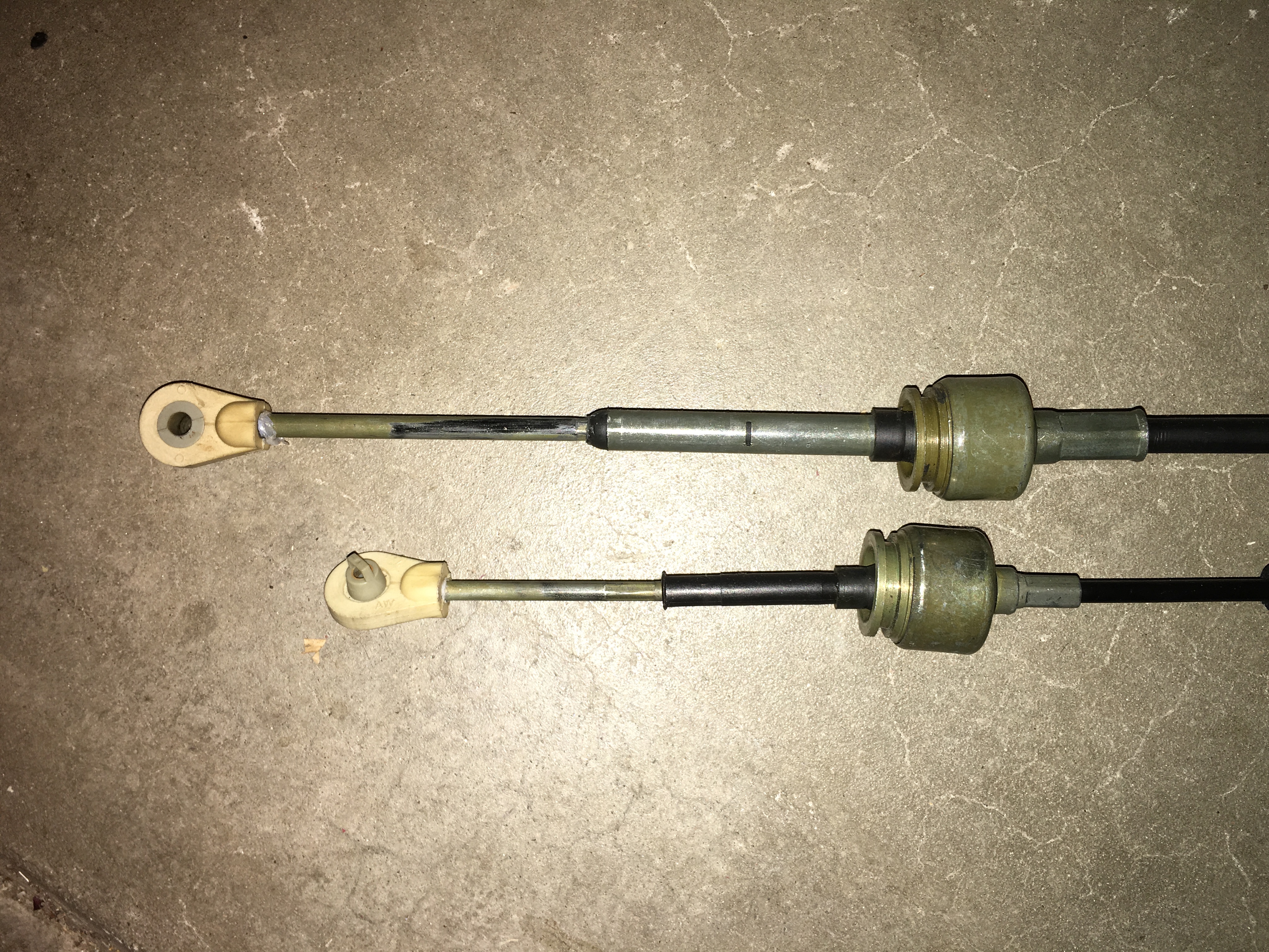

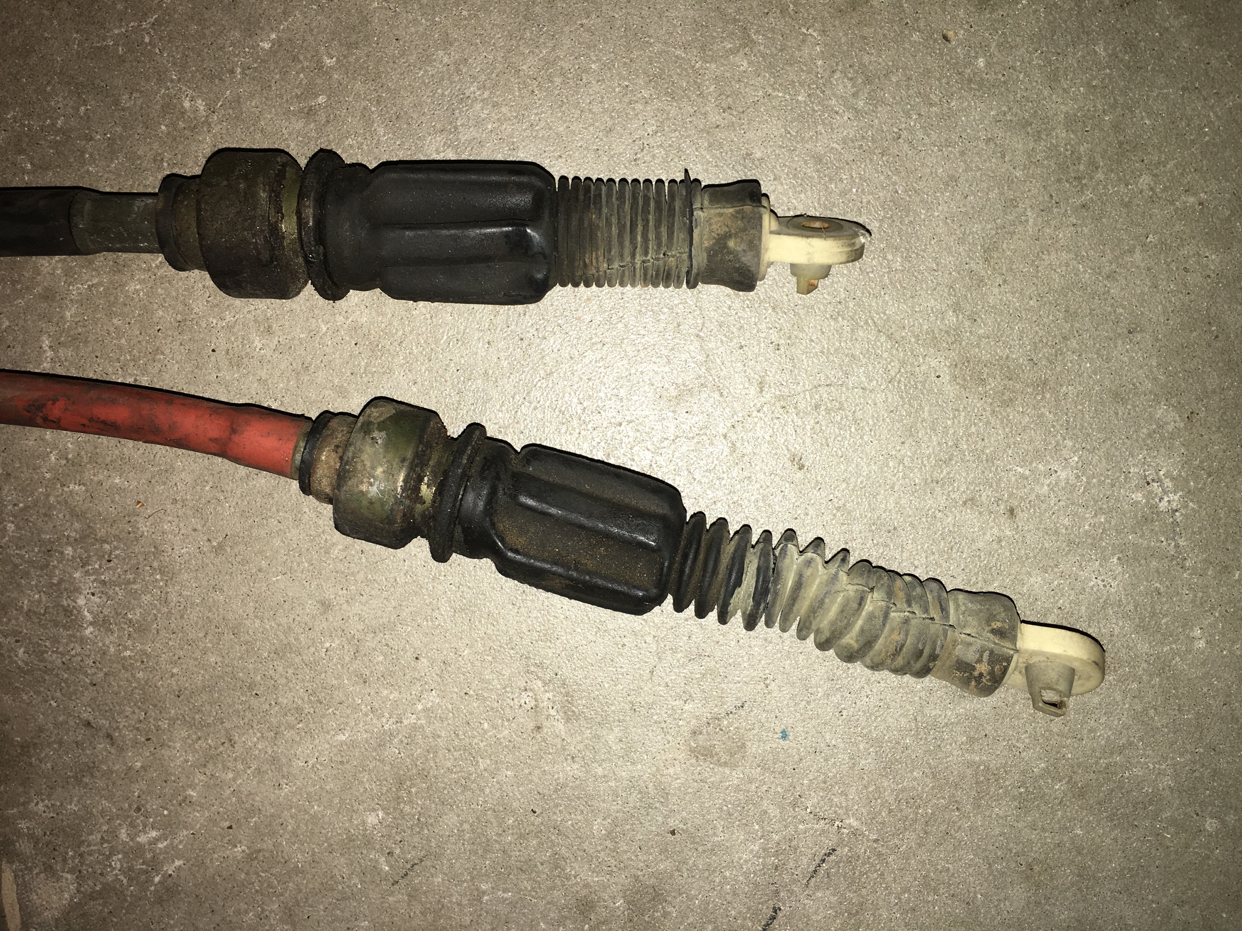

I dug up the old shift cables I still had,
All but one should be from 90-91 Quad4 cars, witch I have also used with a V6 with no issues.
The one with the thicker end is from 93 2.2 Isuzu trans.
I can provide measurements if needed, but again none of these is in a new condition.
Years ago one member had 3 sets of VERY heady duty cables made at California Push and Pull, I payed top dollar to get one of those sets for my car. I can tell you shifting still ain't smooth, I do also use Rodney Dickmans shifter rebuild kit. It's just the Getrag isn't smooth shifting design to begin with, but off course the cables made a significant difference to worn ones.
Edit: found a picture comparing the 90-91 and 93 shifters I had:
