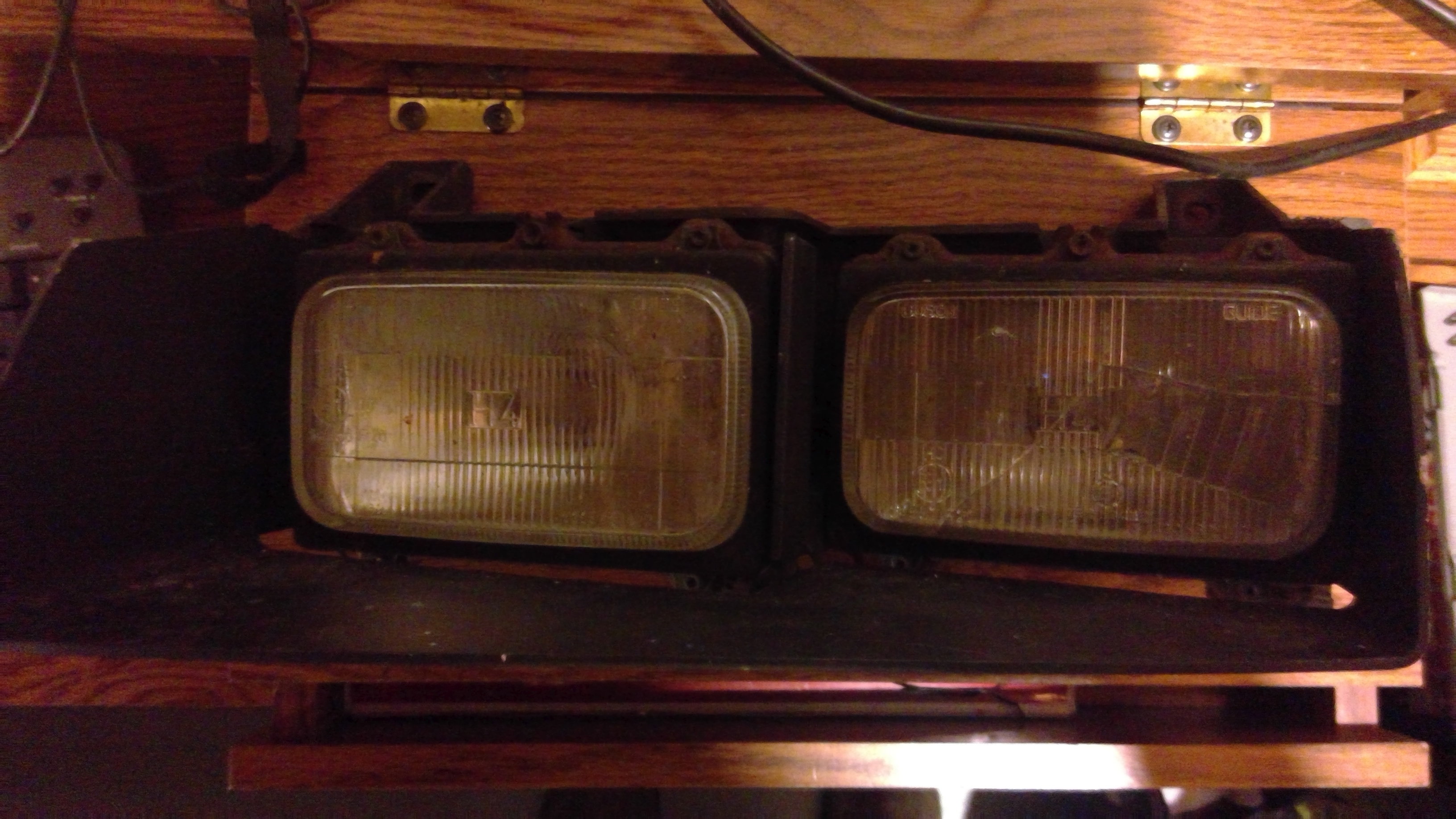

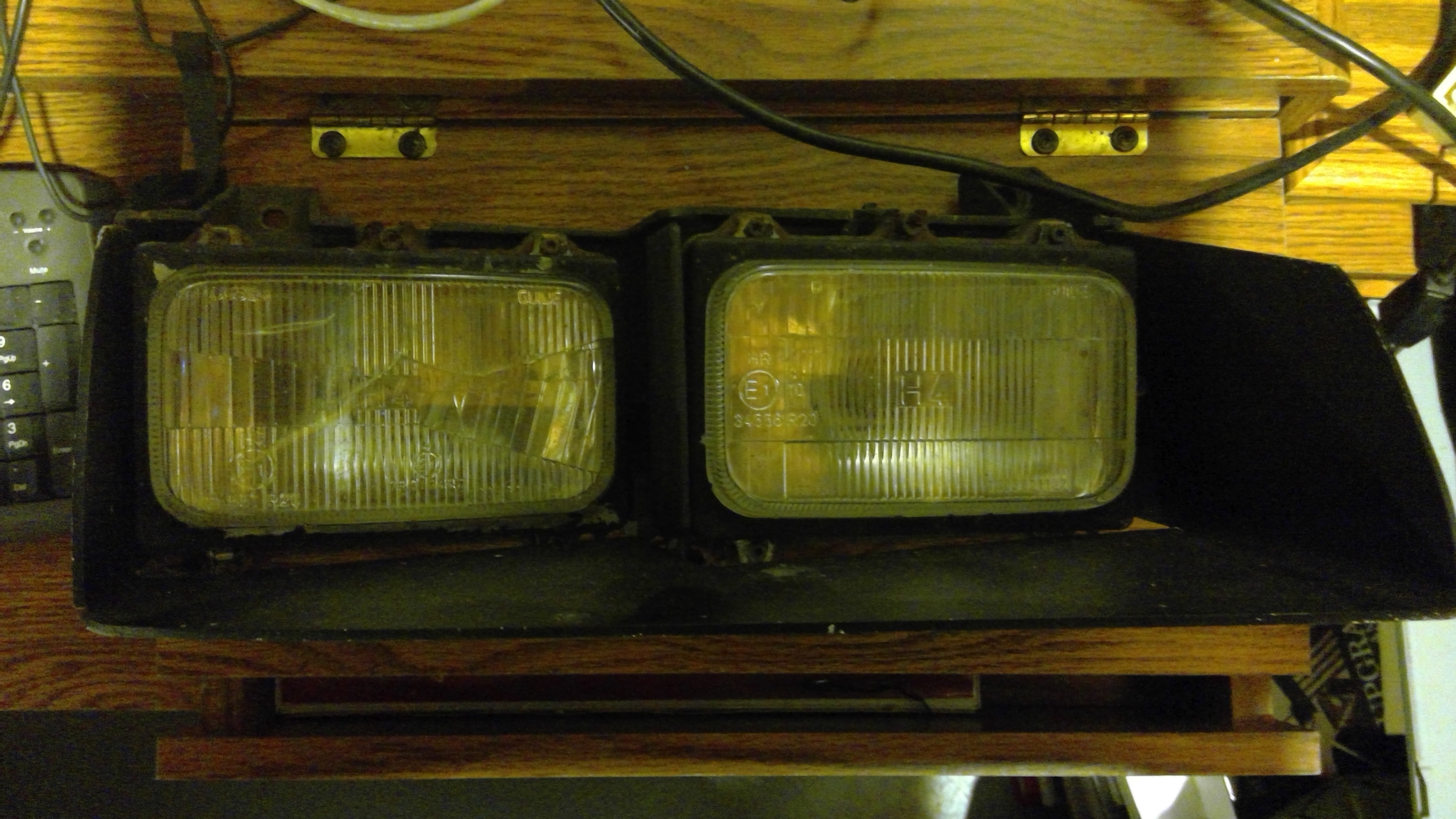

Time to rebuild my Aluminum Euros for my 96 Beretta! :)

I bought 4 capsules on the internet. Glass and reflector as a unit. They take H7 bulbs instead of H4. They also match my 02 Trans Am so its not going to be a loss if they dont work.
Measurments seem to match, they are still in shipping so I have to wait to try them.

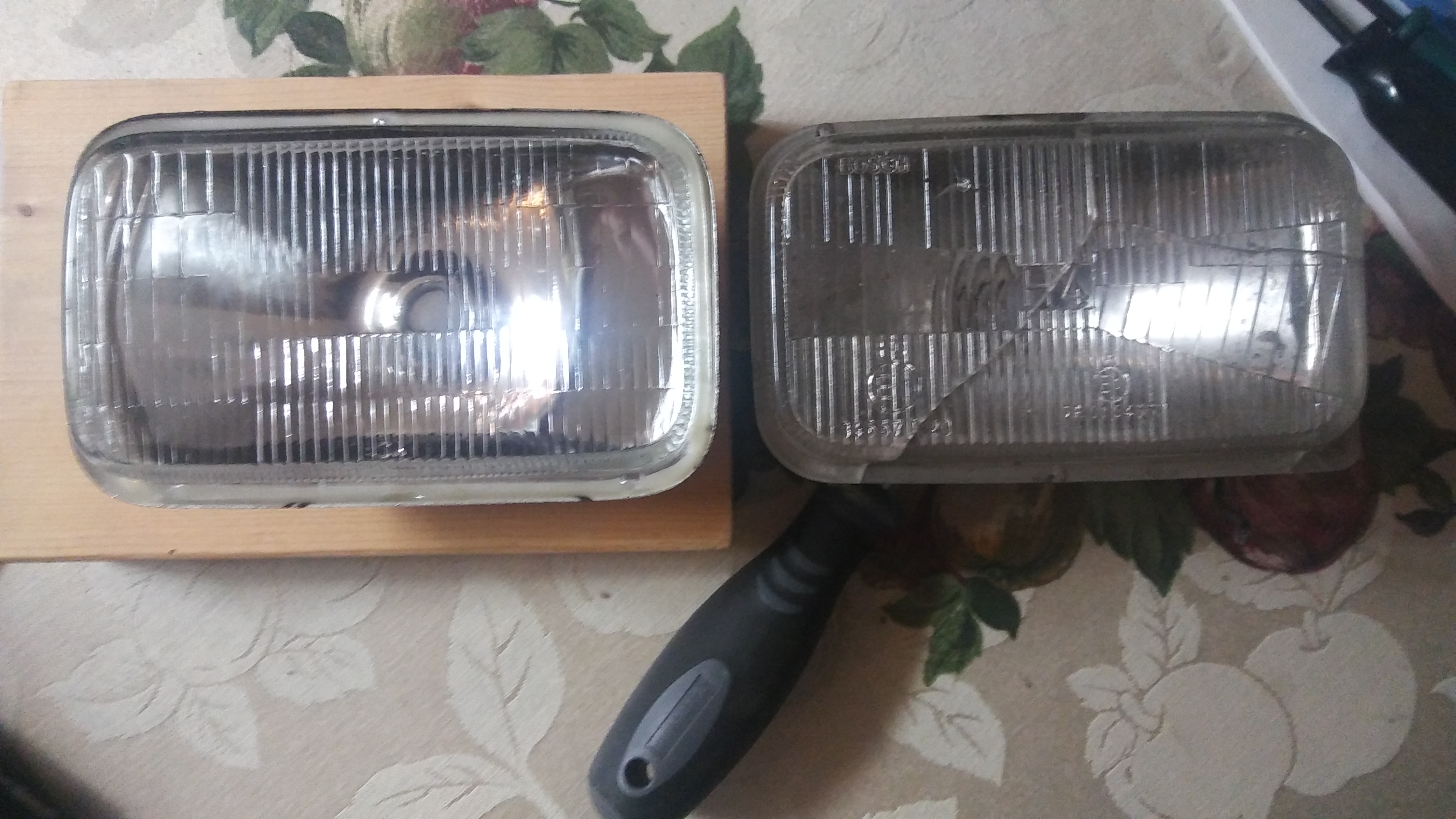

My new Trans am H7 capsules arrived today! :)
They match great for the euro lights.
Left new, right old for comparison.

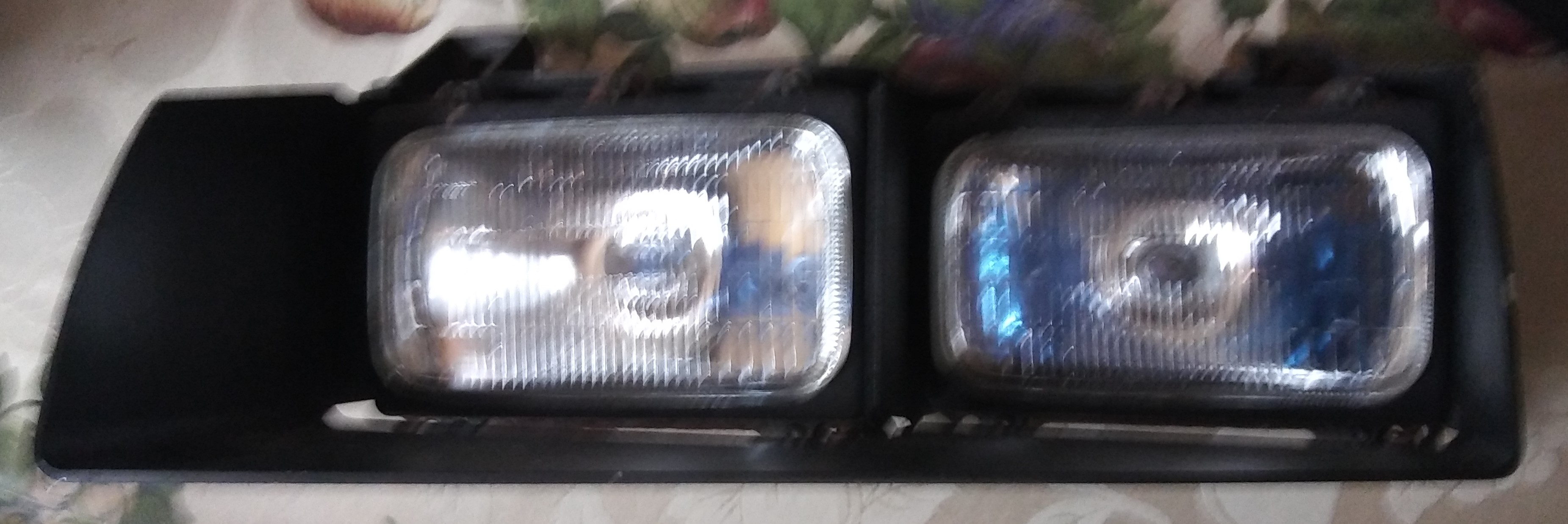

Photo turned out a bit blurry, but one side is done.
These were aluminum lights I got from a Bnet member, they are very good build quality, I'm happy I got them.
This is after I cleaned up the metal and put it all together. Looks Good!
