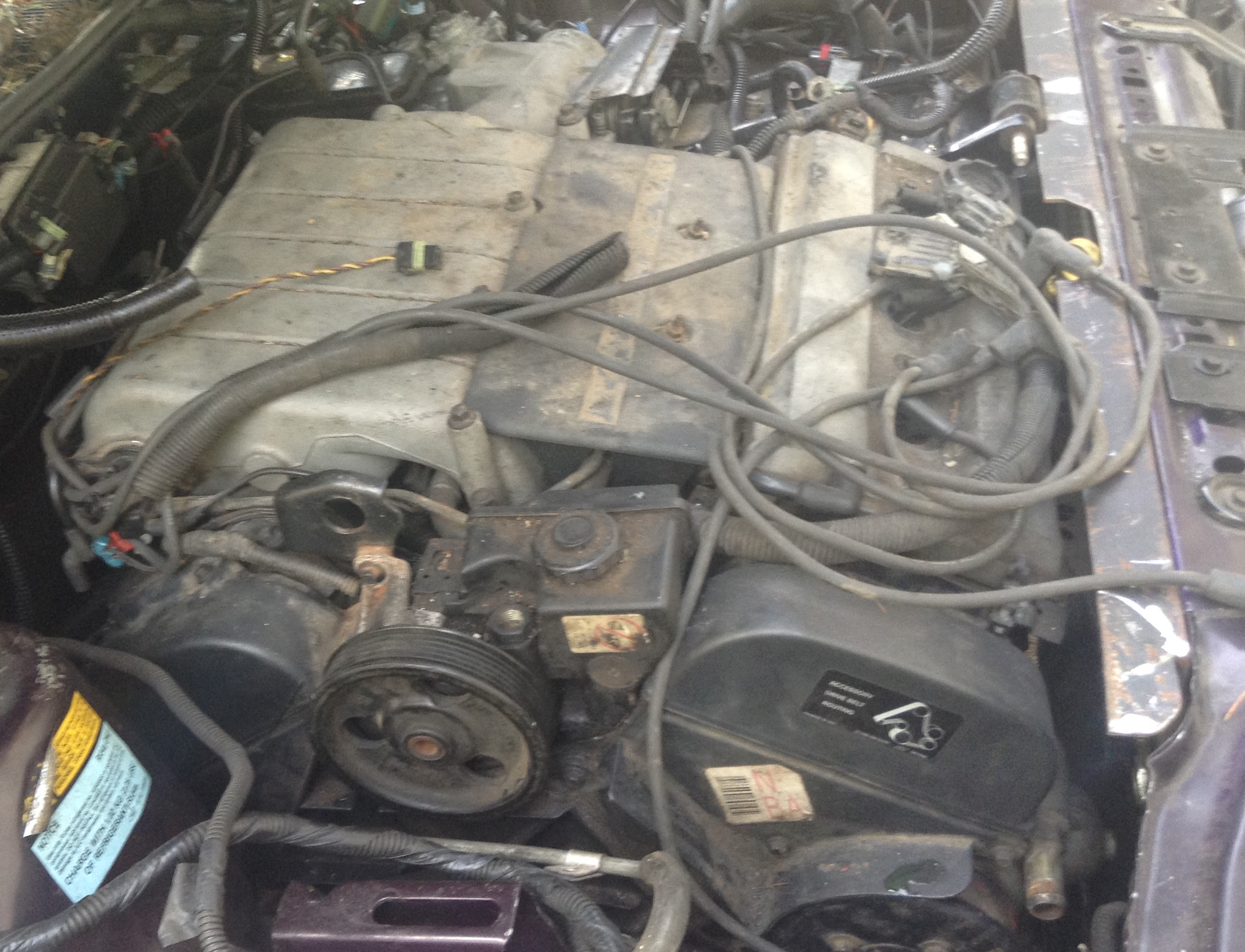

The Engine: 1995 LQ1 3.4L DOHC V-6, also known as the 'VIN X' 24-Valve H.O. Twin Dual Cam engine. This is a full SFI engine, MAF operated fuel management.
Sitting around for ten years will collect dirt, even in a garage.  I've replaced what is necessary, but will refrain from rebuilding a 60k-mile engine, unless it needs it.  This was complete, for $150.  Really good bang for the buck, if you can make it fit.
These engines were de-tuned by GM, rumors persist that it lost ~33% of its' initially design power, supposedly to keep the then-new 4T60E alive for the duration of its' warranty, and in '95 it was rated at 210 H.P. (add five more for the manual transmission models) and 215 foot-pounds of torque. The most interesting note being that the red-line was set about 1,000 RPM higher than the engine's push-rod siblings had. This was a High-Output RPM engine from the start. '95 was the last year with a lower CR (Compression Ratio) and supposedly the last year this timing-belt engine remained non-interference.
I pulled this particular example around a decade ago, intending on swapping it into a Fiero GT, but never got back to that car. The donor was a Chevy Lumina Z-34, wrecked at only ~64k miles. The engine cost me $150 at the local yard, complete from intake to oil-pan, accessories to flex-plate, even included the PCM (the W-Body Luminas placed the PCMs under the hood in '95) and wiring harness.

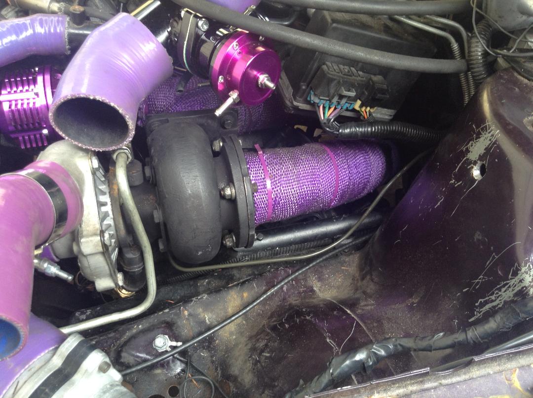

Boost? Yep: The Turbocharger is a Garrett T-04,
T-04 installed.  The waste-gate and the bypass valve (MAF prevents me from running a super-cool BOV, too bad, with 9-pounds of boost and that size intake, it certainly would be heard unloading!) match.  Eventually, the AFPR will too, they are available with the same color anodizing.
Here is my basic 'kit' I put together for the Turbo and exhaust.  This was a good chunk of money, even though I already had the Turbo.  I've done enough turbo projects to know about what I need though, so this was about 95% of the whole thing.
externally waste-gated unit, sourced from my '90 Turbo 'Retta -the pushrod 3.4 in that car had some troubles spooling that big turbo, so I moved it here. Before that, the turbo was brand new. The intercooler is another Blackstone unit, a very compact one that fits under the hood, where the battery usually sits. A full 3-inch mandrel-bent exhaust system runs back to a dual-out Flowmaster muffler, which then terminates in Twin Dual (see what I did there?) Z-26 exhaust-tips. A high-flowing short cone-filter keeps it fed on the 3-inch inlet side, again, still kept inside the engine-bay. A silver-faced backlit Vacuum/Boost gauge installed at an angle to the side of the instrument cluster clearly displays the 9-pounds of boost the wastegate is currently dialed in for. It will look more at home once I swap in the silver-faced electroluminescent gauge face from my other '95 Z-26...
