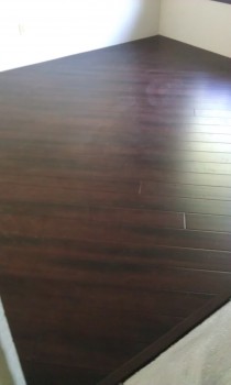

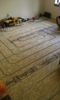

Although this isn't Beretta, or even car related, it is what has been keeping me from doing anything car related for a while now. I finally drove my 'old' '95 Z a bit the other day, and may get the Yellow Indy back out again tomorrow, but for the last month or two I've almost exclusively been riding either one of my bikes or our 3-wheel Spyder unless I needed to make a run for materials with the van.

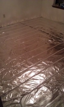

This was the first room I did, I'm just going room-to-room redoing as I go. The living-room has three separate loops (pretty big room, but I could have gotten away with just two) and is 2/3 done now with the sub-surface stuff. It is taking a lot longer than I had hoped, but it will all be worth it in the end, I think. I've been learning the fine art of making more spare time in the day, so I could use it on this. So far, I am up to about 25.7 hours in each day,

The electrically-heated pads that get used in front of bathroom vanities and such only keep your feet warm, and are a comfort item that cost a lot both to install and to operate. I don't really get those either -put some socks on for crying out loud!
But, a full hydronic system (hot water or other fluid) like this actually IS the primary heat-source for the room (or whole house). They are considered one of the most efficient heating sources currently available, and the technology has come a LONG way recently, making them even better. I am installing a 7-loop system, so each loop (or 'zone') can be individually adjusted for need. One catch on hydronic systems is that you can't just flip a switch and turn it on and off -especially with hardwood floors you can do some damage to them that way, but since this will be heating 90% of the house, I don't want it getting super cold at any time anyway. Each loop can be controlled thermostatically with electrically-operated supply and mixing valves, I'm not sure I am going that route. Right now, I am setting-up for a mechanical system, the distribution manifold I have is adjustable for both pressure and flow-rate, so I can fine-tune it for need with a heat sensor. I am in a pretty temperate climate now, so the system won't be over-worked at all, and can use a low temperature fluid-supply that won't be able to hurt the floor even if I 'forget' to monitor the system for minor changes. If it is too much effort, I can easily retrofit the electronic 'zone' controls.

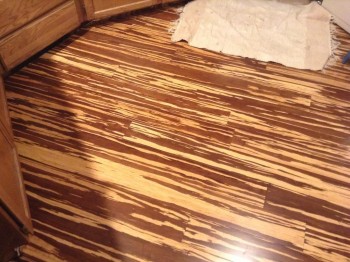

Well, most of this project is done -I had to step away from it here and there as life continued outside of my project. I am currently operating five of the seven available loops (I haven't done either bathroom yet -I am not trying for complete remodel there, but each one does need to be stripped-down, any water-damaged subfloor replaced, then everything built back up, Hardibacker panels installed over the routed second sub-floor layer and our chosen porcelain large-format tiles installed. I am taking a complete break from it for a week or two while I catch up on other things. The short-plank solid bamboo we chose for the living-room fought like hell going in -would have been fine as a glue-down, but nailing was tough because the planks are relatively thin for a solid construction and the bamboo material is so incredibly hard and unyielding -the tongue-part would get swelled-out by the force of the nail driven through, and would bottom-out in the groove part before the edge-gap was properly seated. Not every time, but frequently enough to cause serious delays -I recut CASES of the stuff on my table-saw to deepen the groove and even knock a little off the bottom edge for the planks that also swelled-out UNDER the tongue. I had a lot of hand-nailing along the edges too where the pneumatic nailer couldn't reach, and every last one of those had to be pre-drilled -quality bamboo flooring is too hard and the nail will literally bend 95% of the time rather than go through. PITA, I wish I had just used the same stuff as the dining room, but it is basically done now, except for the back hallway. Eventually, I will come back around to our pantry floors too (we have two of them), but as they weren't getting any heating loops, they are able to wait and should be separate sections anyway, and they are getting the same flooring as the kitchen, which was much easier to work with.
As for the heating, I've actually had to turn everything down a couple of times, it was getting too warm in the house. I bought a high-efficiency three-speed circulation pump, and everything is being regulated mechanically at the manifold valves -no electronics needed. It hasn't gotten really cold here yet, but we still have our fireplace if we need to boost it up a little, and I've got safely at least 20% higher supply temp I can go on the heater, and watching the cycling, the heater isn't being stressed at all. So far we haven't wanted to go even near the fireplace after turning the floor on. I got a great deal on a Watts accumulator, and found a good company that sells brass plumbing fittings for a good price, so virtually the whole system is made of aluminum-layered PEX tubing and brass fittings, no actual 'pipes' anywhere in the system, and as few fittings and joints as I could manage to minimize leak potentials.

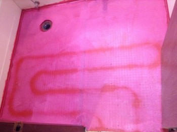

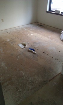

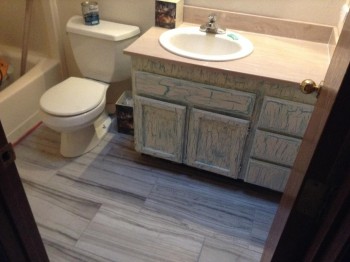

Just a quick update to this for anyone who may be curious. After comparing our electric bills for the past few months to those from last year, our heated floor is costing us about $200 per month to operate in the colder months, but is SAVING us nearly $100 per month in propane heating costs. Our house is overall a little warmer feeling (it is actually quite cool, but doesn't feel that way at all due to the more efficient heat transfer), and when we visit other houses without heated floors, we find we are spoiled rotten -everything else just feels uncomfortable and cold, no matter how warm their house is.
Here are a few shots from when I did the first bathroom floor back in November... I can't say I am crazy about the operational cost, but the effect is worth it.
