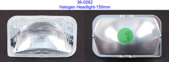

I contacted a website http://www.lmctruck.com/
I found that the H4703 and H4701 match the 36-0263 and 36-0262 numbers. However they look like sealed beams in the photos.
This may be another option if any members are interested. The ones I found on ebay should be the H7 capsule versions of these. I'm still waiting on shipping to find out how they work.

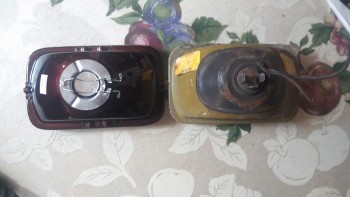

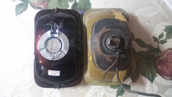

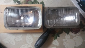

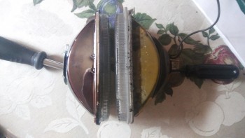

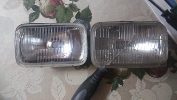

Adding photos for reference.
The H7 capsules work, they arrived today.
The only downfall is the clip on the capsul is bigger than the opening in the back piece. So If I want to change a bulb I have to remove the capsule from the front.
They are glass. And look to be well made.
I took photos of them with the euro light for comparison.

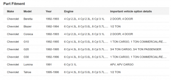

Bump for thread. Have to order also new elements, but I remember that someone suggested these for Beretta
Correct or not?
https://www.lmctruck.com/1973-91-chevy- ... dual-150mm
36-0302
36-0303
Or should go as mentioned in this thread?
Correct or not?
36-0302
36-0303
Re: Euro Headlight Info for glass, reflector, and bulbs, possibly more.
Yep, looks like the correct fit. Nice they seem to come in pairs too. I just went with new sealed-beams H4701/H4703 for now, I got a good deal on a full set and they work fantastically. But if you are looking for the housing-style "upgrade", it looks like you found them.
Those are the ones! Someday I want to do a HID retrofit into mine, but I've got other fish to fry...
As I get it, then the price is for 1pc or for pair? REQD means required?
