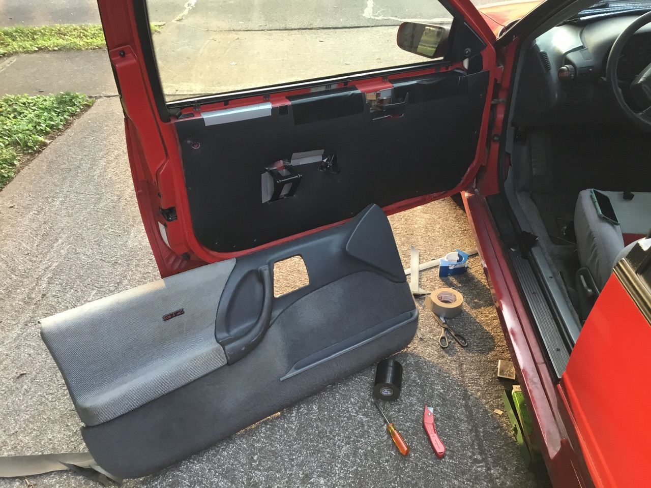

This test cost me $200 and several days time. I have a lot of time into this. 3hrs typing this just today so draft is what it is and I need to get back to the garage! I used a stock 91 v6 auto gtz for this test.
I bought more material than I needed because I believe that this will work for more cars. The purpose of this post is to give you a further-than-factory decibel reduction level for price paid in actual weight and dollars.
There is a lot of information here so bear with me as I try to summarize everything that I’ve taken in from reading many hours of forums and company-owned scientific data and testing results for all types of installs. The one thing lacking more than anything else is before and after results! Here for our little spot on the internet is a BERETTA forum post that reflect CHANGES before and after sound material was added! Here is the experiment and my results!
The changes from what I mention above are that the experiment car here tests DOOR PANELS ONLY, so the HH-66 glue for mass load vinyl is not needed. Melamine foam is not needed (well, not used) - it’s purpose is to separate the mass load vinyl from substrate (under carpet / the floor) to use it’s characteristics to the fullest.
However the same MAIN CONCEPT (3 layers) has stayed the same:

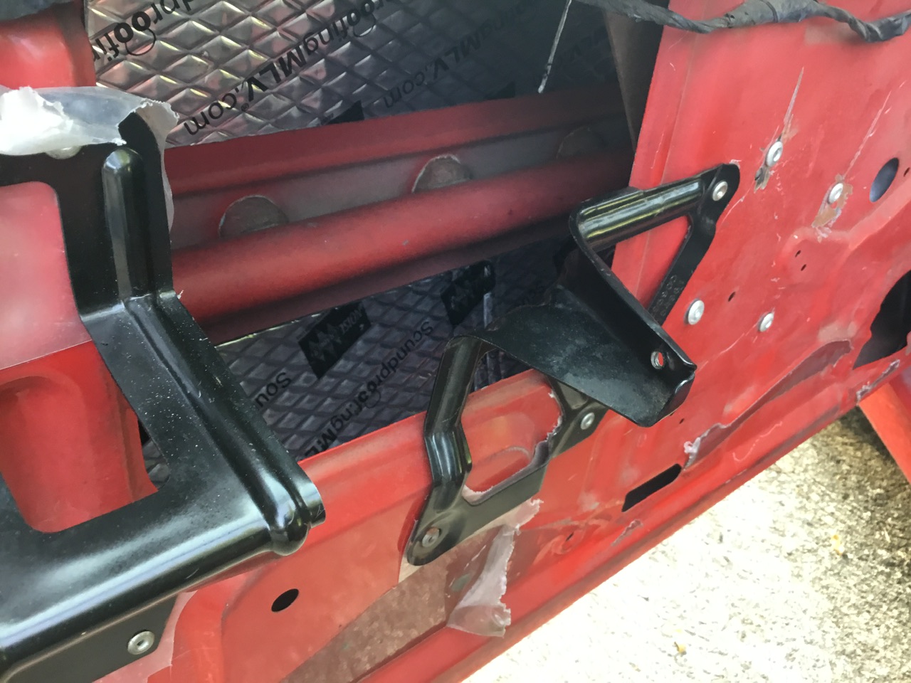

1)Cover big metal panel with Constrained Layer Damper. We see this also as “CLD tiles” or what we see when we close our eyes and historically see DYNAMAT. The new thing is to recognize a bell curve to use way less than covering the entire panel and making your car heavier.
2)Decouple layer using foam. Eric Wood’s pic of the door panel with the flat foam panels above should have been in my experiment to do this right THEN put the darker MLV over Eric’s foam. Separating the MLV from the base metal is required. To sound proof a house, soundproofingmlv.com sells clips to hang this stuff between studs like towels drying on a rack in the bathroom. The foam layer doesn’t appreciably do anything to block, damp, reflect, or otherwise stop sound. It only supports #3…
3)Mass Load Vinyl. Known as Limp Mass Barrier in some circles. This is vinyl as we all know it expanded to 1/8” thick min and about 1lb per square foot. Hence the mass. Barium Sulfate is often used. It’s non-toxic and has density (see below that mass is needed to block sound)
Of course lead is best…
The hardest part is shopping for material. Let’s use the “Dynamat” stage for example - that rubber-tar sticky tile stuff that we’ve known to define SOUND DAMPING for years is called Constrained Layer Damper. Forget Home Depot and asphalt-based material for cheap because it’s not worth the opportunity cost that it saves in dollars. Where is it’s data sheet? Doesn’t have one and it’s probably not thick enough. If it is, and I was looking at a door sill seal at the beginning, not the best material for the job.
My skepticism rose when I saw summit, jegs, and all other sellers battling price, but then I saw DEI price theirs way hi (more than Dynamat!) Saving you a weeks of reading, I have found out that DEI is 4mm thick, Dynamat a little less, and 2mm the standard minimum and the “other guys” like everything on Amazon, jegs name and summit name brands, and made in China, is 1.6mm thick! There in lies their cost savings and now this is debunked. Real quickly, I got out of the masses, and stayed with made in USA material because I am so tired of inferior EVERYTHING in my daily life that im now taking it as a personal insult when offered China anything. No need to experiment with tile thickness. It’s been done! DEI’s 4mm tile im sure is the best, or we can double up some thinner layers but two layers of 2mm is more complicated and pricey than just buying the 4mm to start! This post is a measurement of the value in sound damping. I almost bought DEI and almost bought stuff thicker than 2mm, but instead casted out the inferior 1.6mm thick material and called it good. This made 90% of my shopping easier. Also let’s quickly cover heat-insulating material that moonlight as sound dampers like lizard skin. They reflect thermal energy like they are supposed to, damp vibration, and block sound. Air-filled glass beads mix with paint goo. Air is the best insulator so it works. However MASS is required to dampen sound and sprays are light. Light stuff blocks heat, heavy stuff blocks sound (still want that cheap 1.6mm stuff from Amazon?).

What I did with the doors is put on CLD tiles 25% coverage top half and bottom half. That’s one strip up top and one strip totaling 295 sq in for 1 LB 7 oz per door. That’s adding 3lbs total to the car!
What are the results?
First, the STOCK slate
Eng off, in driveway ambient sound 29db
Eng on, idle in driveway …………………51db
45mph on designated road segment 64db
(Note Road smoothness worth 7db)
ADDED CLD STRIPS in the doors (put door panels back on)
Eng off in driveway ambient sound 27db
Eng on, idle in driveway………………..51db
30mph…………………………………………59db
45mph…………………………………………61db
52mph…………………………………………63db
60mph ………………………………………..69db
ADDED MLV!
This weighed more than I hoped. 4lb 10oz per door, or 9 lbs total to the car just in MLV. Moisture barrier also put back on. MLV is NOT moisture barrier.
Eng off, in driveway ambient sound 27db
Eng on, Idle in driveway ………………..51db
30mph………………………………………….59db
45mph………………………………………….59db
52mph …………………………………………61db
60mph …………………………………………65db
Success! TOTAL weight added is 12lbs.

ADDED MLV!
