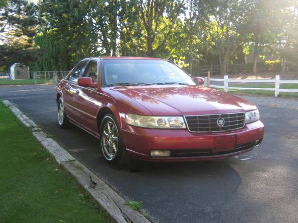

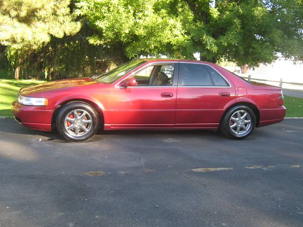

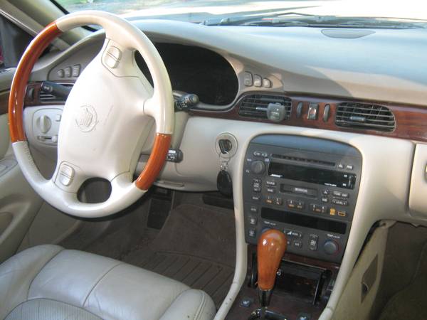

Finally this year, I began seeking out such an animal, a head-gasket-failed Northstar, to test my wrenching patience on. And found one! A beautiful relatively low-mile STS Seville, well equipped, that needed a new home. I've wanted one of these cars since before the late-nineties remodel, and have finally determined that I now (surprisingly) like the newer ones better. Which this one is...
Unfortunately, my Summer has gotten completely away from me, and I'm still finishing up the 2nd Audi TT we adopted into the family (yes, ON PURPOSE! BE NICE!). So I have yet to pull the engine from this car to repair it. But it runs great, drives great, and sounds great (the exhaust was damaged by the previous owner, a hole punched into the resonator, and it sounds like an old-school hotrod -no mistaking that this is a high-compression V-8!). I just can't drive it very far without finding a hill, and just watch the temperature gauge climb then! Yikes! But, part of the positive offset of having to wait for this car to line-up as an active project, is I've been able to open my eyes to the fact that I will never be truly happy with this car, so long as it remains an automatic... So, I've had my eyes open for another F40 Six-Speed transaxle, but so far I'm unable to find one near me for a price I am willing to pay (I SHOULD HAVE bought more from Schram back when they imported the last of the N.O.S. from Germany 10+ years ago, instead of just the ONE I put in my GTU! They were $400 plus freight...). Most likely, this car will get a Muncie/Getrag 282, one of the spares I have in storage from a Beretta. Possibly, it may get the rebuilt 284 I have instead, but being essentially irreplaceable and the pull-type clutch also being utterly unavailable absolutely everywhere, that transmission scares me just a little. Is it stronger than a 282? Yes. Is the 282 strong enough for a more or less stock H.O. Northstar, in a heavy-as-hell Seville? Hmm, YES. Sigh. Well, I suppose, I mean, I guess so, from what, you know, NO ONE ELSE has EVER said...
