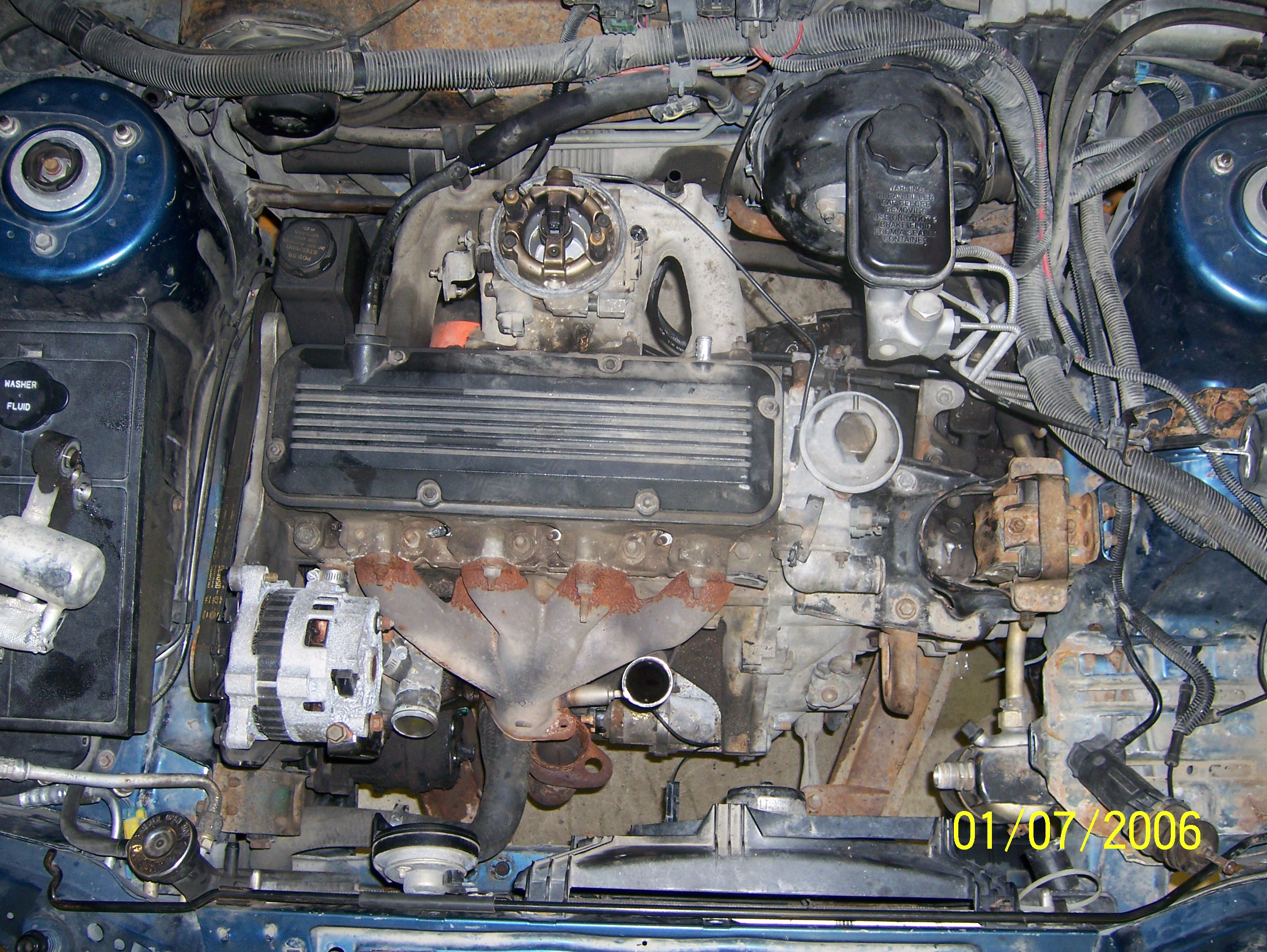

I am needing some pictures of the mounts for a 1991 style mount on Getrag (Muncie 282). I know there is a top driver side mount. Ill still like to have a picture of it though. And Also I have heard there is a lower mount. Any info will help.

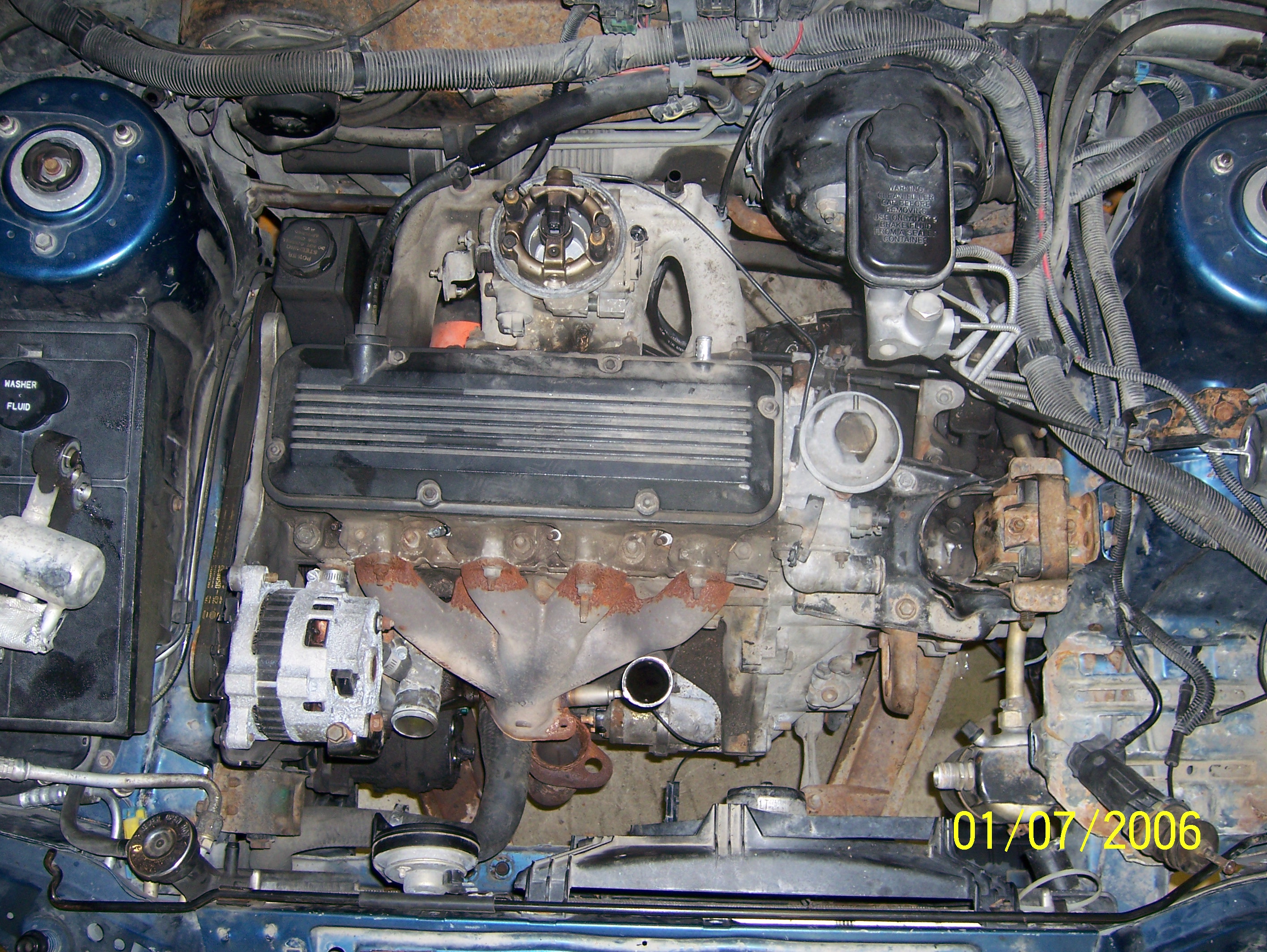

I got the billet upper mount from white88gt on bstuff, but unfortunately they have been discontinued... as well as all the FFP stuff in my pics. Some of it is now available from MRZ Performance though.
Here's a good pic of the upper:
And the lower:
And the lower:

Hey thanks a lot! I needed to be sure before I start painting the engine bay. I got both dog bones from MRZ and that upper mount is what Im lookin for. I heard there was a rear mount but I have not found any info on it. Rumor?
