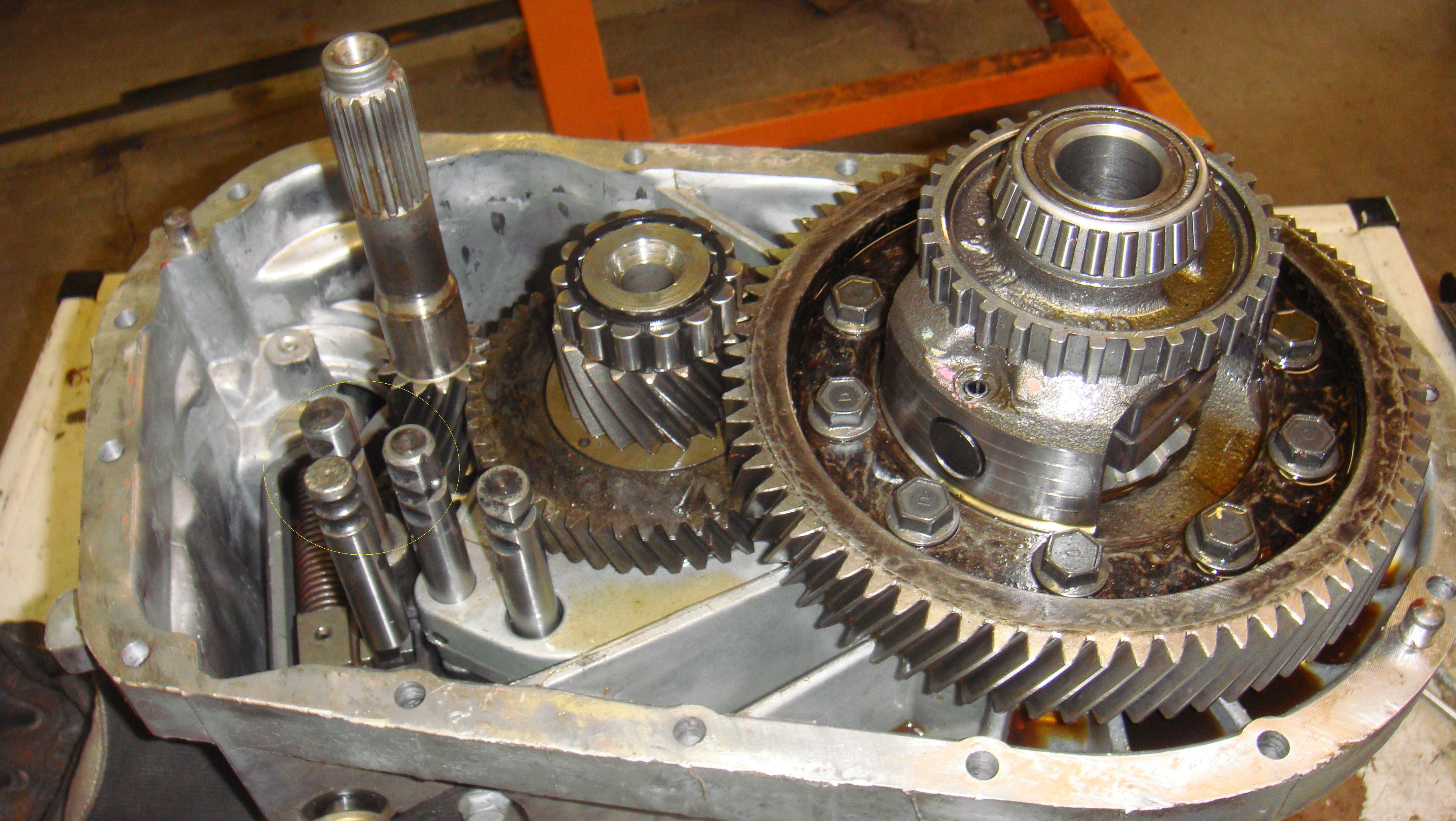

Well I have a problem here. I am in the process of painting my engine/tranny and I was tryin to move my shift linkage around and well I found it was stuck. I did a LSD Green install on it. and to tell you the truth i don't remember when I did it. As far as I know it did shift.
Anyways. I could not get the shifter into N. I messed with it for a few hours. Oh I should say its a Getrag/Muncie Hm282.

Now the only problem I am having is its stuck in reverse. So I pulled it back apart. And I F'ed with it for an hour or so and may have found my problem.
Im going to start from that start here. View Pic below:
1, 2, and 4 should be even and 3 should should be a little lower when the tranny is in N.
Now when I put the top case on 4 goes down. That would be reverse. I could not fig out why this is happening. After a million tries I think I know why.
Now look at the rod that is on the left. That is part of 4. When 4 goes down that does to. That rod is part of the reverse gear.
That is a dimple from the V6 case. The dimple is small because of the cross shaft for the TO Bearing.
Now look at the inside of the case:
This is the dimple from the non V6 case. The Dimple is big because there is no TO Bearing cross shaft forks. This is the inside of it.
One a scale on 1 to 10 how much have I confused you. Its not you its def me. Im not sure how to explain this.
Now I think that left rod is to long and it hitting the case when I put it down and it locks it into gear. Am I right. I really need help on this.

When I start to put the cover on it in is N. I can move the shift link around. I start to put the case on and it does not go all the way down on its own. So i wiggle it and it goes down and its stuck in reverse and binds up. So what I did was i shifted it in reverse with the linkage and that made the left rod go down. I put the case on. It fell on. So then I try to put it in reverse and it moves but i can hear that left rod hitting the case and again stuck in reverse. Im just thinkin if the tranny is made for an internal slave then I have to get a V6 case that is Internal. Now if the tranny was made for an external it would not matter. On your GTZ was it internal or external slave?

Note: Position shift rails so the 5th gear shift rail (197) is 1/4" BELOW the other three shift rails - that MUST be at the same height (neutral position).
That is all right before I put the case on. But as soon as i put it on, and I am carefully not to push the shift rail in, the reverse shaft is pushed in.
I was doing some lookin at the SS project and I found some pictures and to me it looks like that rod is way to long.
I am assuming that the tranny is in N. Woody?
That damn rod is even with the case.
I know that my rod is about an inch and a 1/4 above the case. I know this cause I thought about cutting it.

Cutting it was a joke. I was wondering if there is a way to adjust that rod down. I have looked in the manuals and found nothing really. Im stumped. Now long shot but maybe when they rebuilt this tranny they put in a longer rod? Im just shooting in the dark. Im going to take another look through the manuals.

Well I did some more looking around. Did some searching. And I guess you do have to cut the rod down.
I called http://www.midwesttrans.com/index.htm
I told him that I have a 282. Org. the tranny came with a case for a 4 cyc and it was an internal slave. And the case i want to use is a V6 external. And everytime I put the case on it gets locked into reverse. As soon as I said that he said well you got to cut the reverse rod down a little because the tranny is made for a internal and has a bigger indent for the rod. And the external has the cross shaft in the way so the dent is smaller. i asked him about much to cut off he said about 3/4 of an inch.
What do you think about that. I am trying to just buy a new case from the dealer. Well Price it out.

Im glad I wasnt going nuts telling you to cut it on bstuff.
It would be cool if you take a measurement for us so theres no guess work next time someone wants to swap to quad gearing.

My dad looked at it and said "crap Scott you might have to cut it. Ha ha." Im am thinkin that his is right. I still cant find anything that would cause this but that rod. Im not to thrilled on cutting it.

Mod if you can find one for me I will swap. I have looked and all I can find is overhaul kits. And they dont make the front covers anymore so a new one is out of the picture. I am seeing more work if I dont cut it. I need to talk to my dad and my bro inlaw and get some better ideas on how I am going to do this.

Well I bought the case from a Beretta guy from one of the sites. Forgot the person. We do have a local JY but like you Im busy for the most part of the day when its open. I do most car work from 10:30pm till i need to sleep. I know I could cut this right. I would take my own measurement, the only reason why I asked the 3/4 is because I had already measured the rod and the dents and knew how much I should take off. To justify why I thought it was the rod. I wanted to see if the guy was blowing smoke. I will ask my dad and my bro in law to take a look at the JY.
