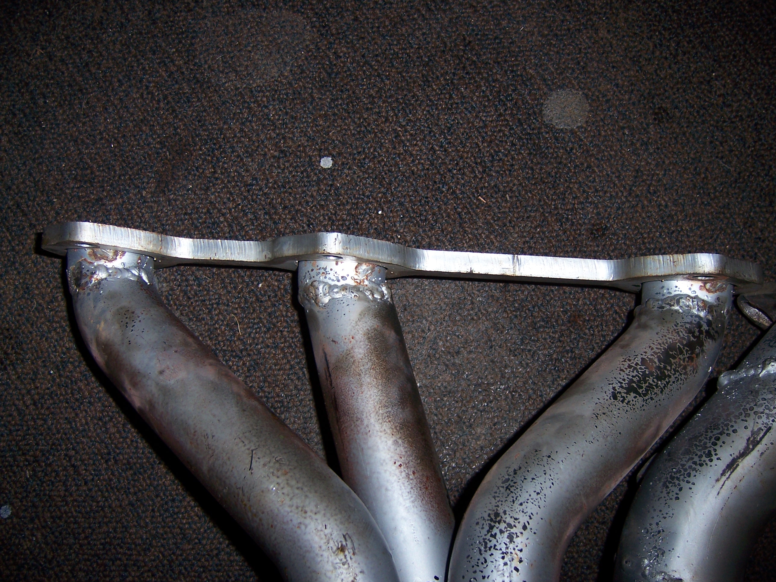

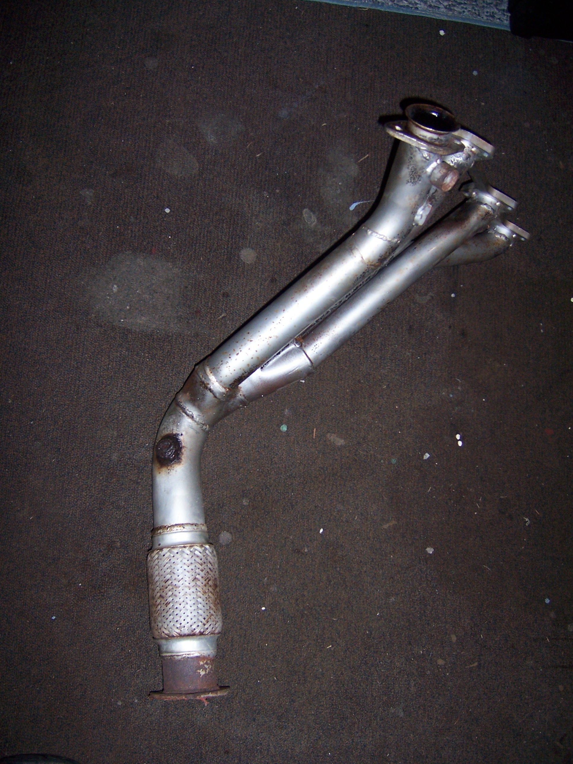

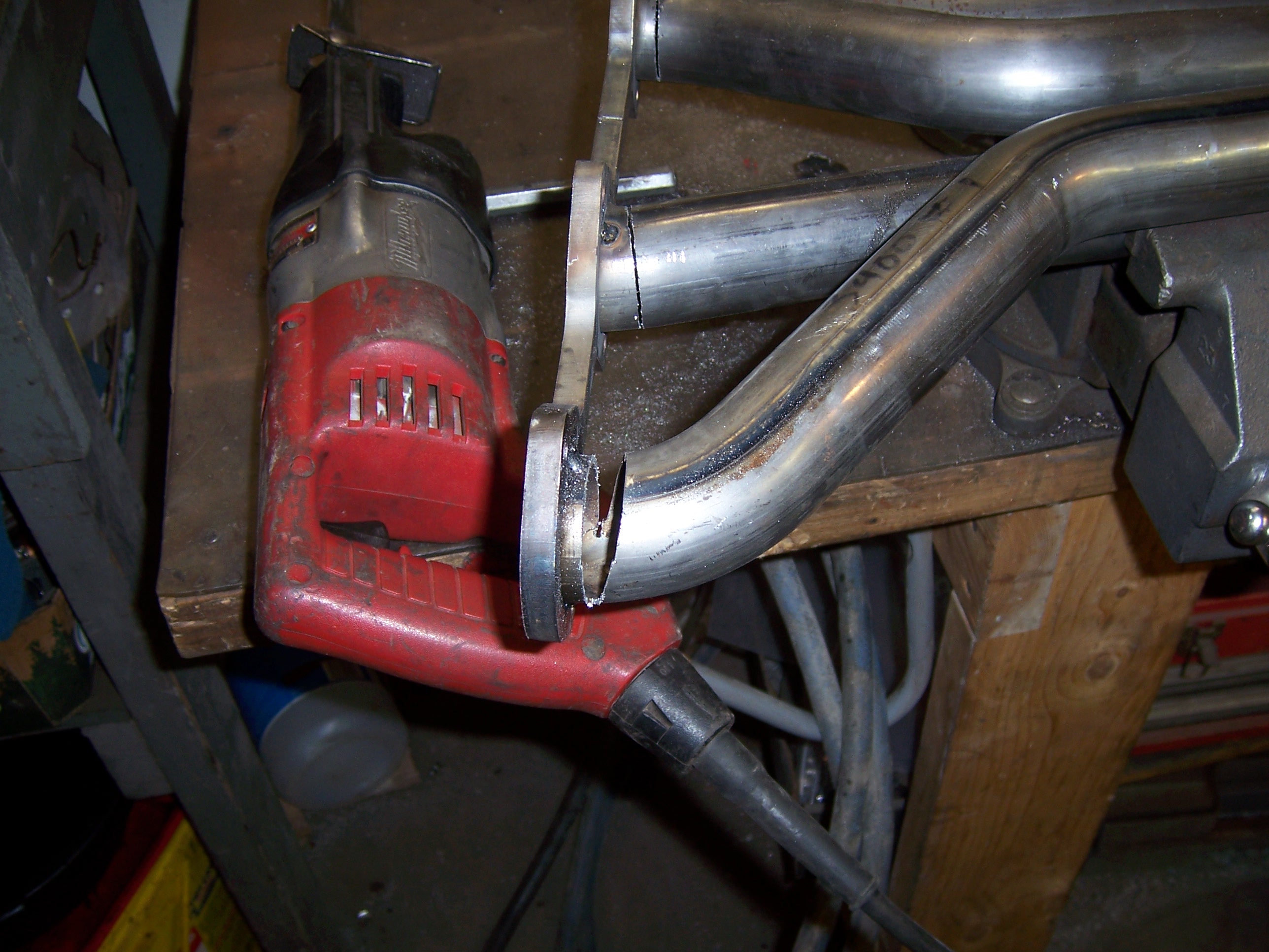

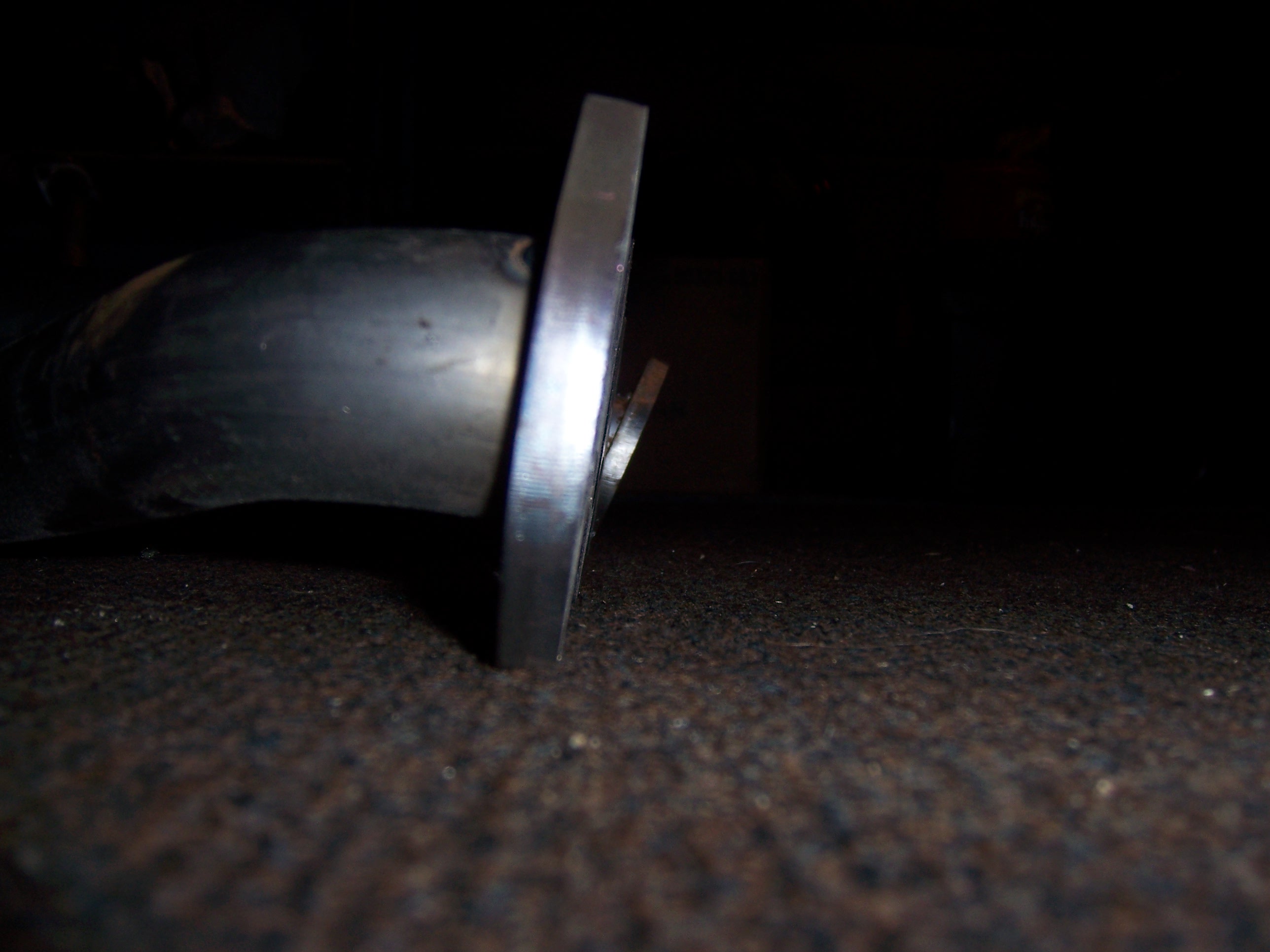

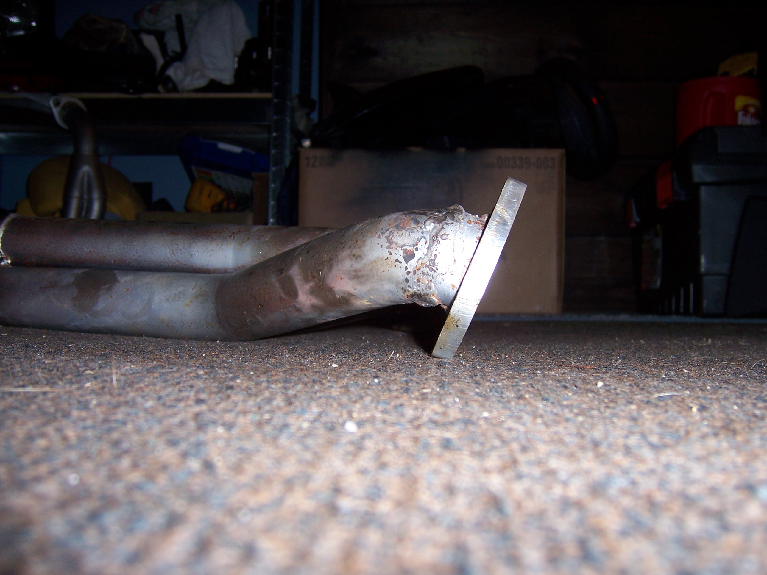

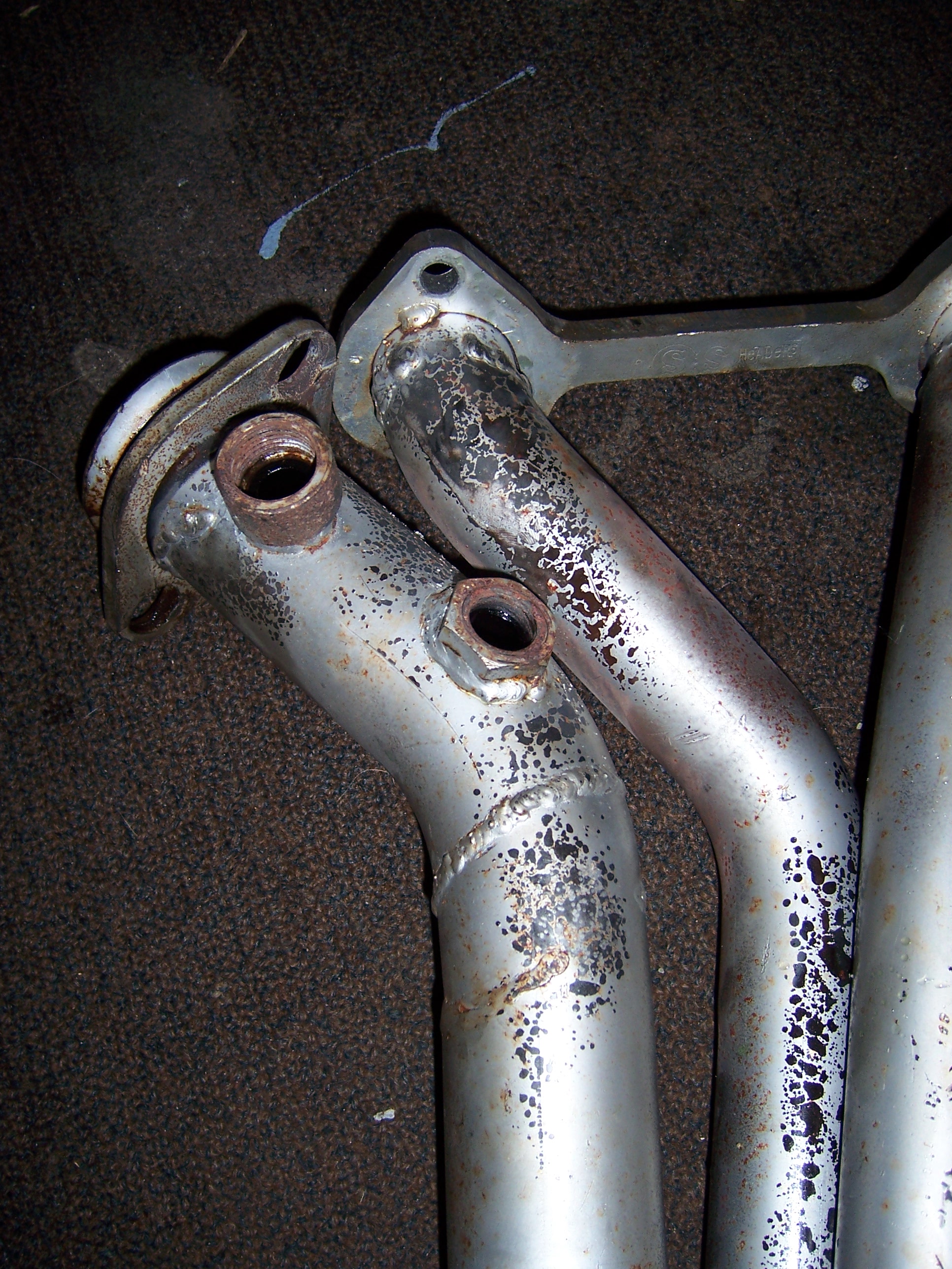

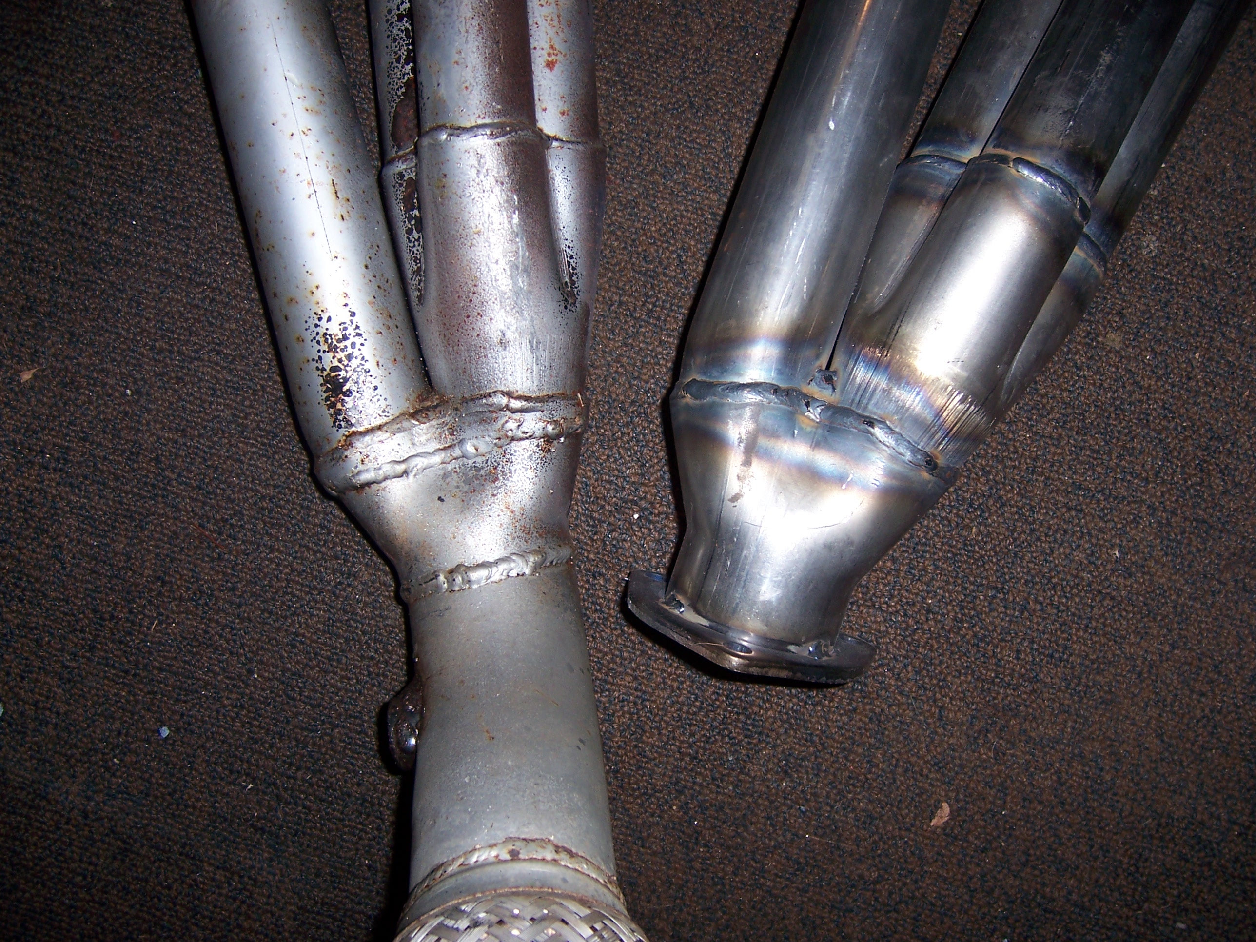

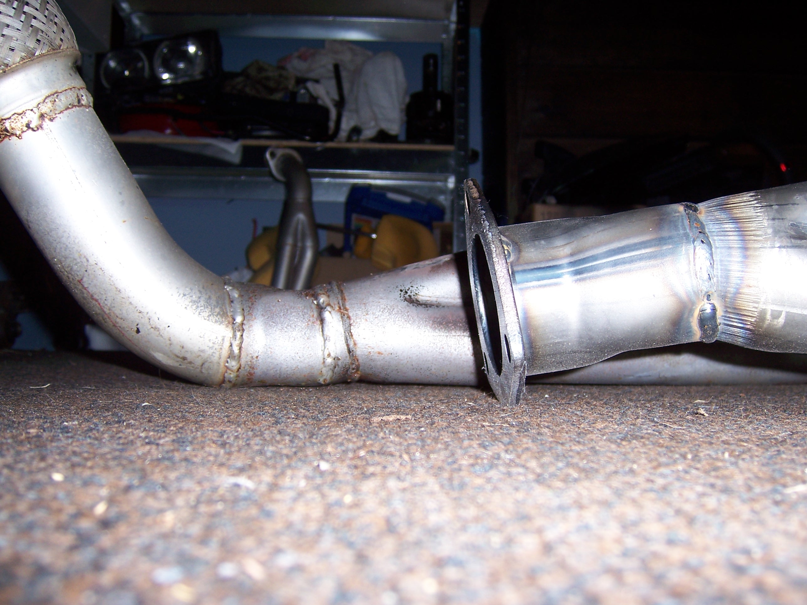

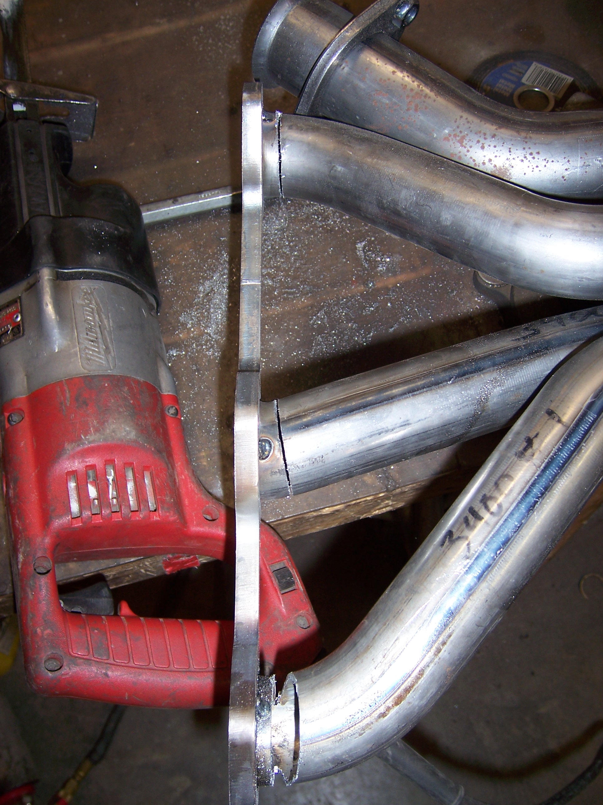

Here are some pics of the modifications I had to do to the S&S headers to get them to fit my car... Also pictured is Erics unmolested set... which will soon receive the same treatment.

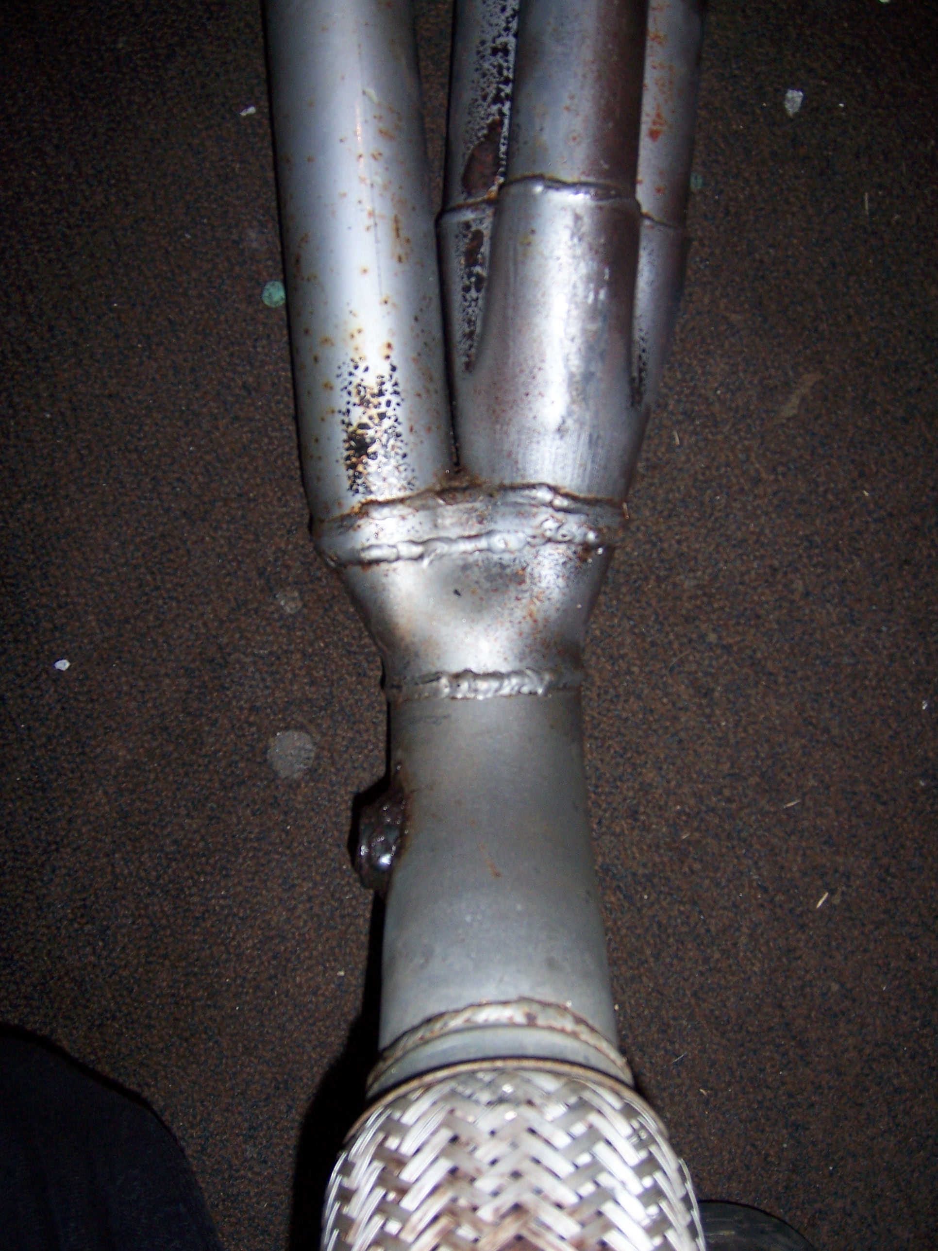

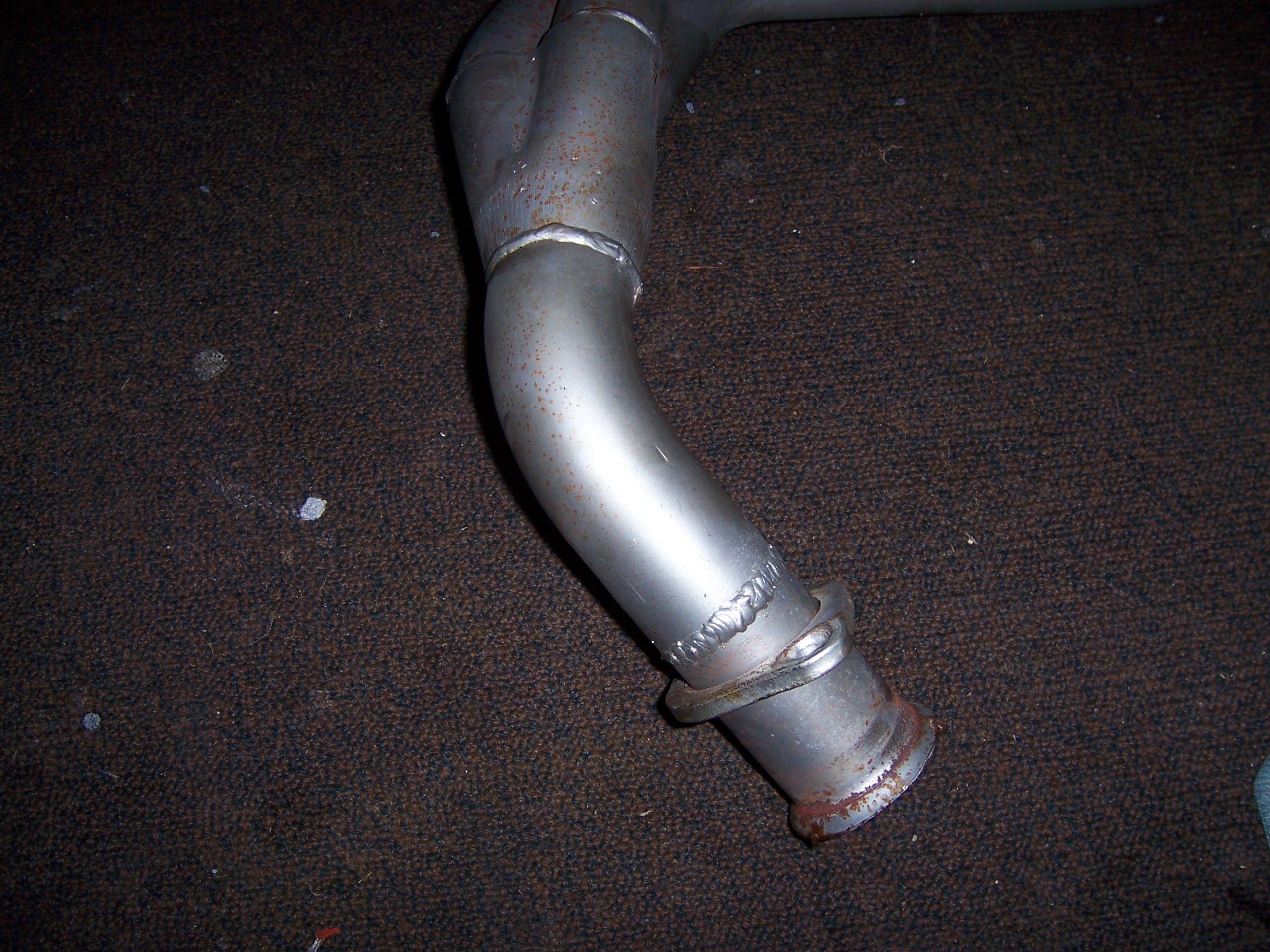

A few notes of things I did was cut all three tubes at the back flange and bent the main header down further to give it a sharper angle, then shortened and angled the last collector in the opposite direction so it wasn't aiming so far down. And lastly re-aligned the cross over pipe again.
Completed header Last collector cut and weld. Cross over hacks, It could have been done it one cut on each side but since I didn't have both on the same motor it took me two or three shots. Bottom of rear down tubes. Angle of mine Comparison to unmodified... the rear flange does angle it a little more too since its not flat. Collector comparison collector flatness comparison.
The 3t40 needs some more work on the #1 cylinder.

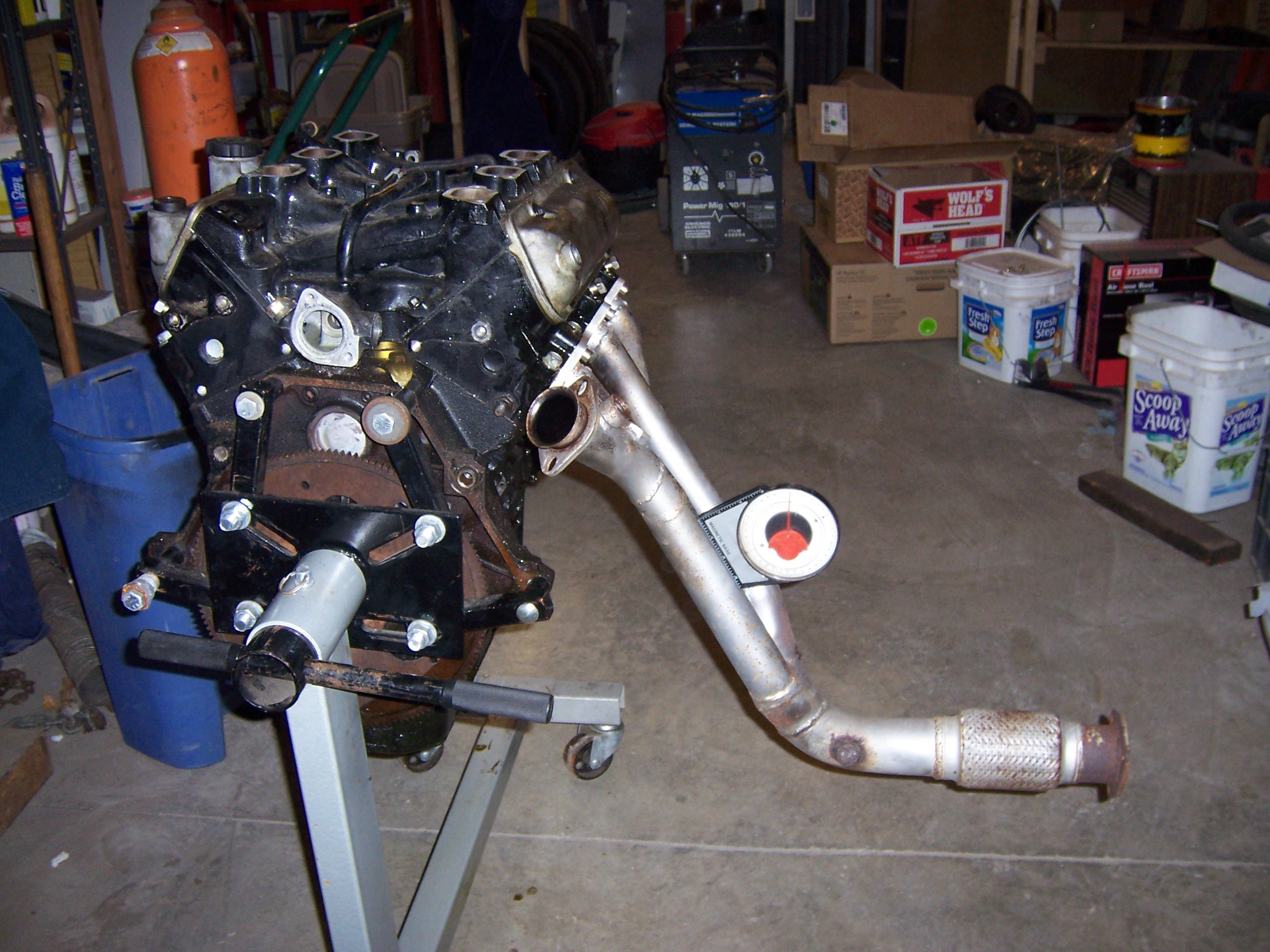

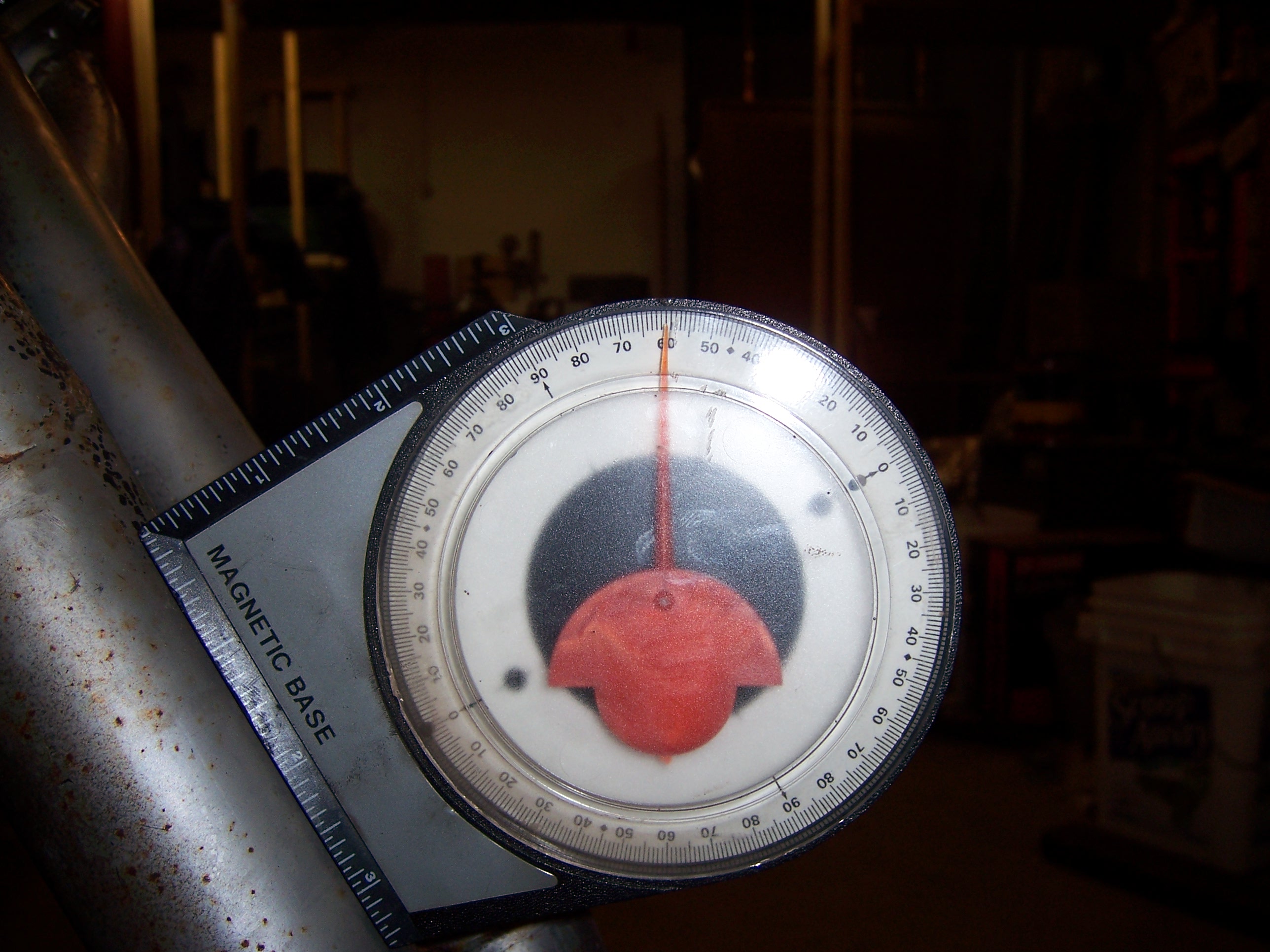

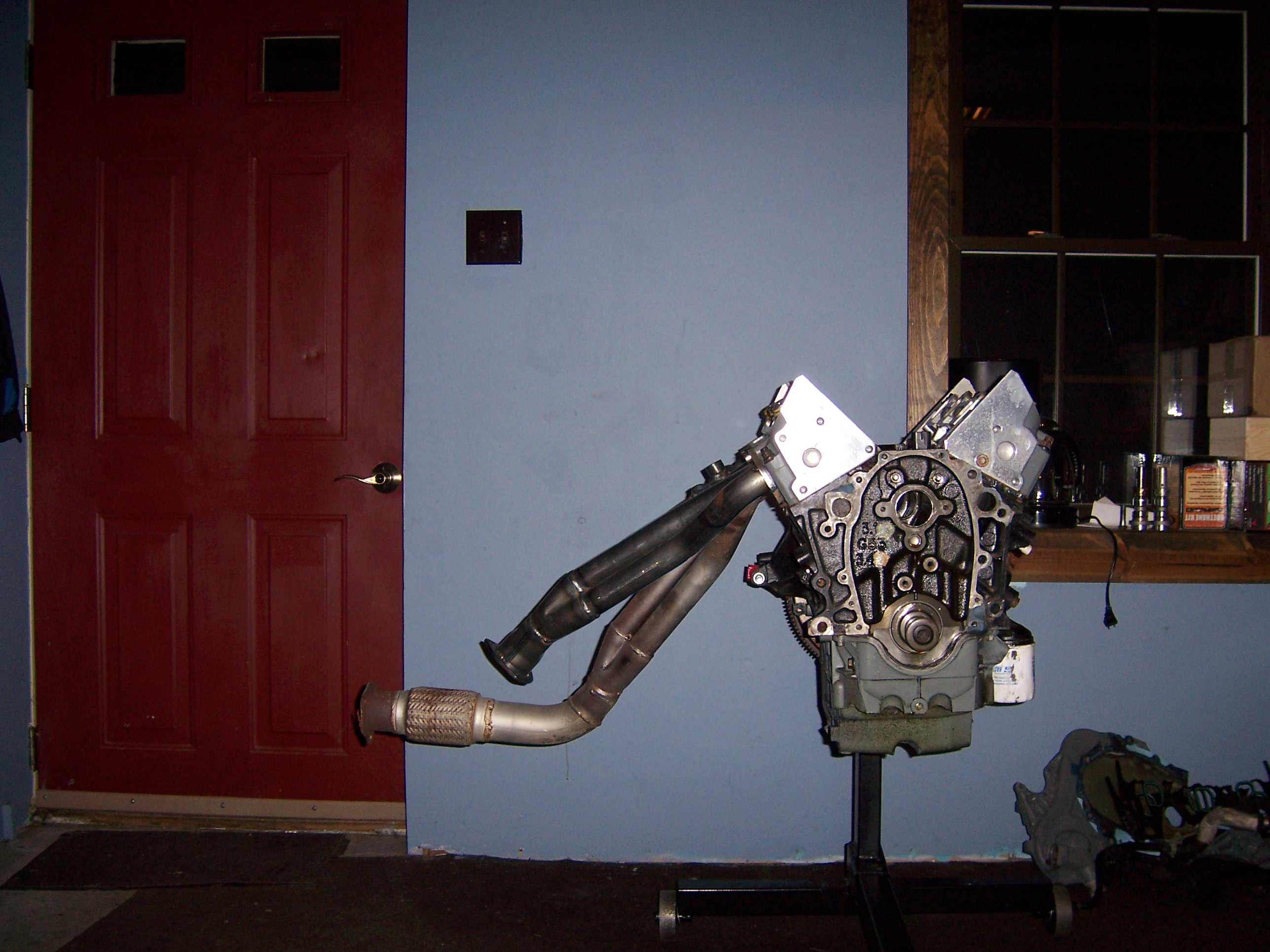

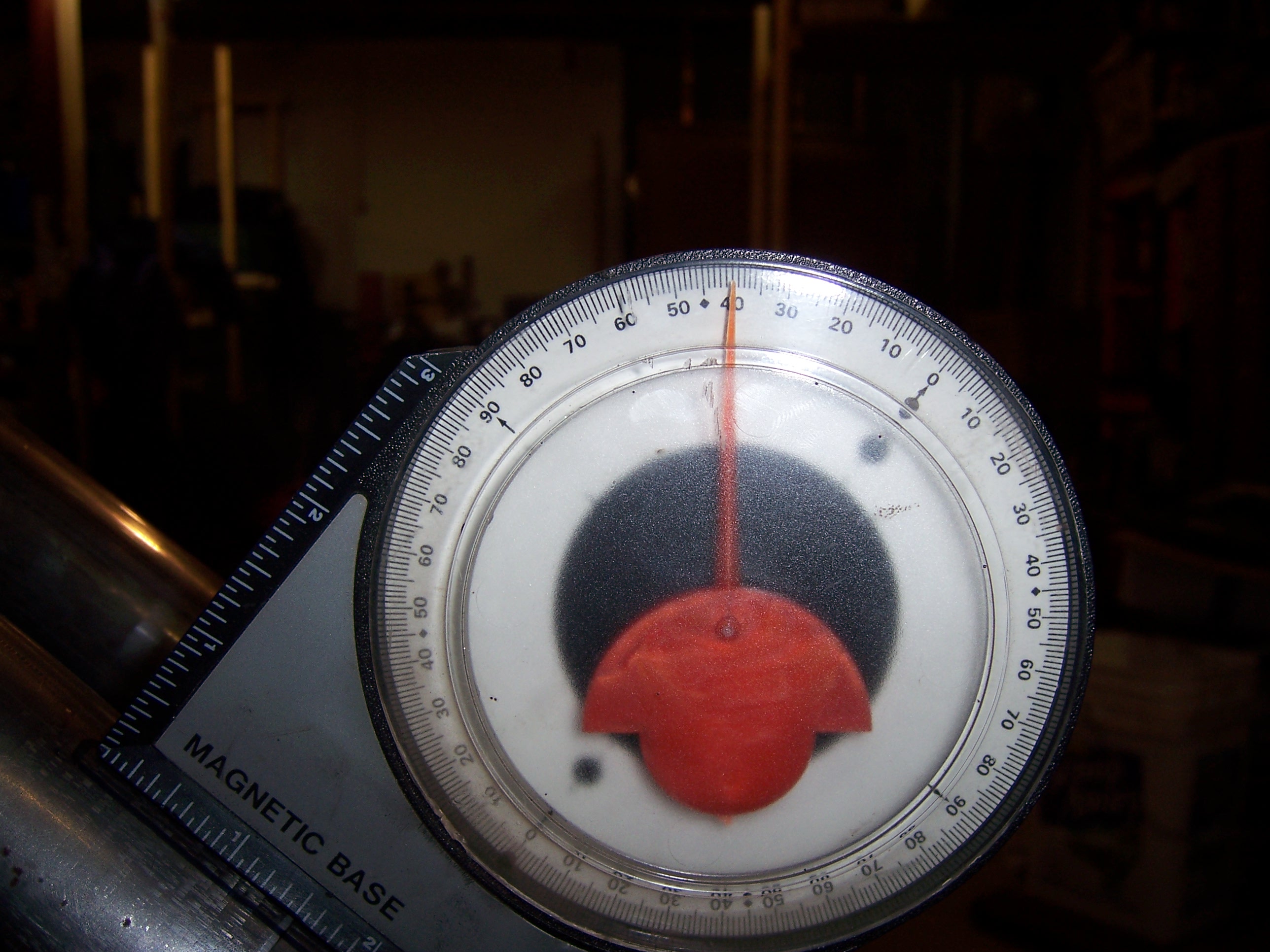

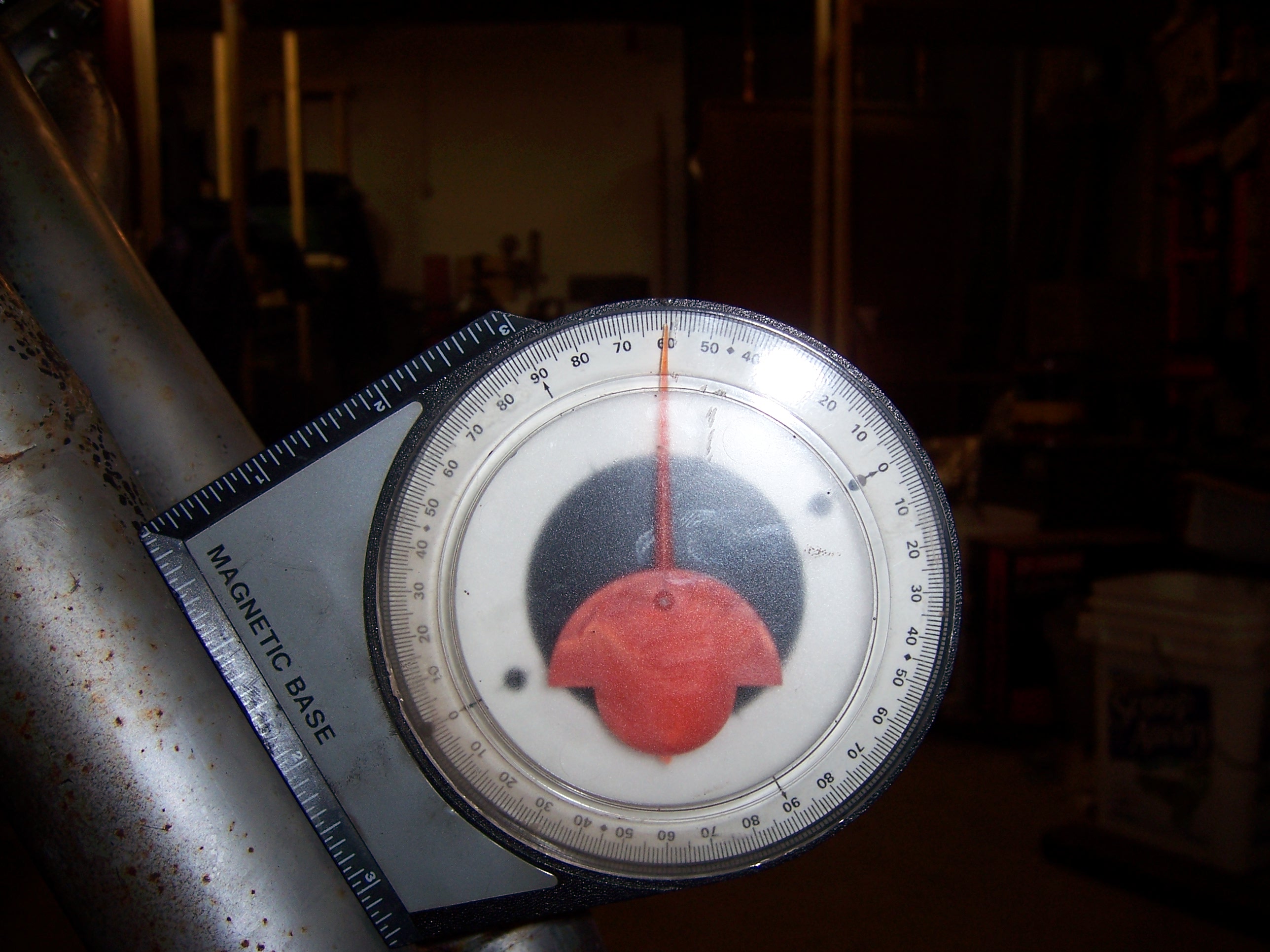

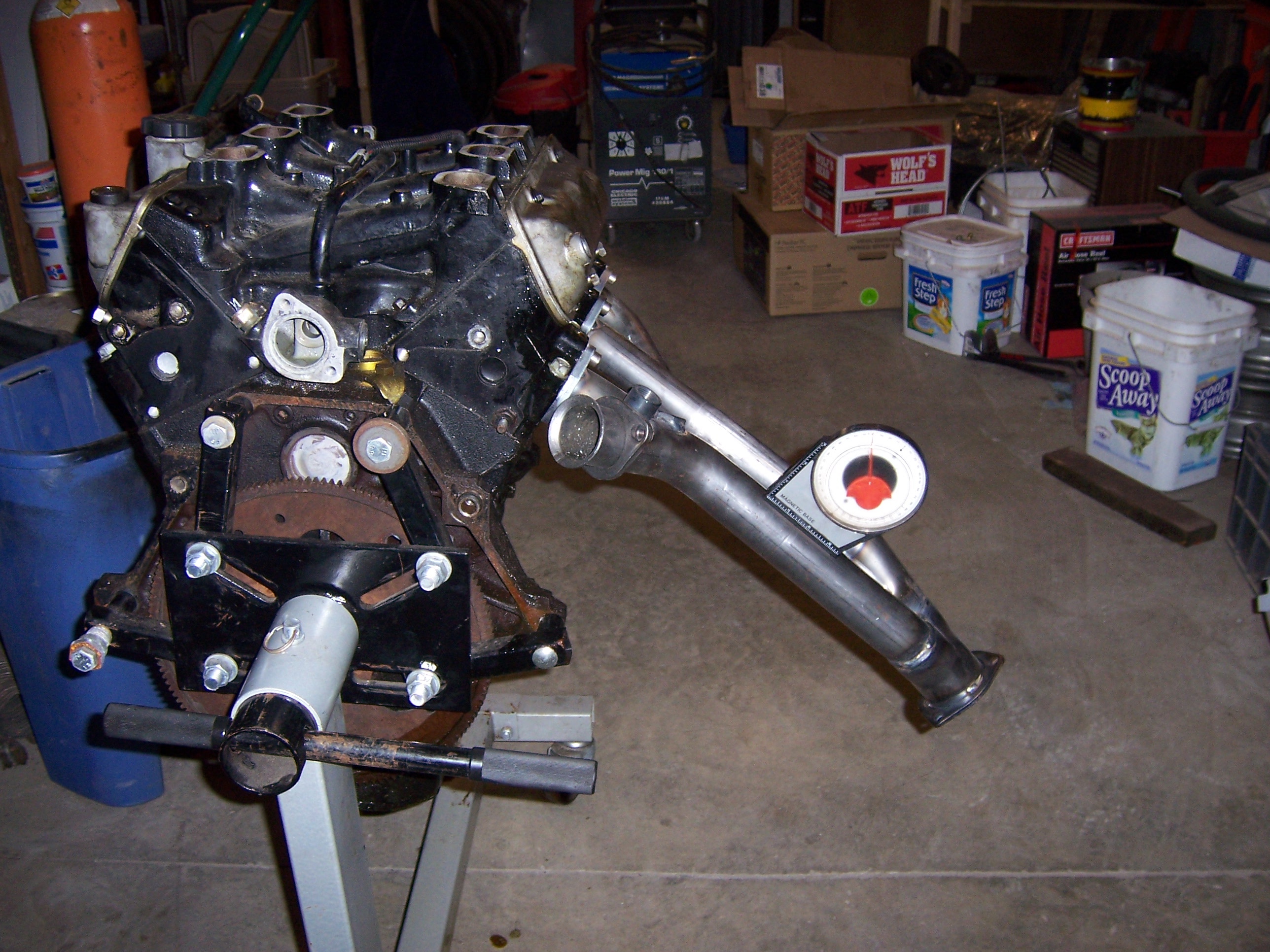

I know this pic had been done before but it was with a manifold and a S&S stock to compare... here is the header that works and a factory S&S so you can see how much I modified it down to fit.
All chopped up!!!
I had to add 20* to get the angle right.
They don't call it a 60*V6 for notin... LOL What I started with Right now the tubes are welded back up and set for a 60* angle on the mock up motor. Remember that's not a definite measurement, that's what it ended up being after I removed the DIFFERENCE... That's all you need to remember and tweak for.
All chopped up!!!
