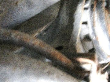

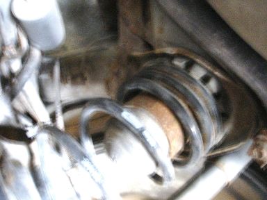

95-96 Guys, how bad is this RUST?
- IsaacHayes
- Posts: 975
- Location: Missouri
Is this stuff just surface rust, or worse? I know the pics aren't great, but from what I can tell it's not completely disintegrated like my 94. This looks like some wire-wheel work and some good primer/paint and it'd be good as new. Am I right? Just cosmetic and not structural or too deep yet right?
What about the bump stop, I don't see those long metal bump stops in Ixion's thread... Are those removable pieces?
From Ixion's thread it looks like the 95+ is a lot simpler and has less pockets both on the side wheel well and up top of the spring to catch dirt and rust out. Looks all smooth and less complex. The frame rail looks bigger and cleaner than older styles... But I figured I'd ask someone that owns one...
Thanks!
Thanks!

Re: 95-96 Guys, how bad is this RUST?
Here are the rest of the pics.
Yours is better than mine. I had alot of shale rust back there. I had to knock it off with a screwdriver and a hammer. Then I hit it with Eastwood's rust converter. All the paint I put on it came off, but the rust has stopped. My 90GT was more like yours. Watch that bumper support. That thing rusts like crazy and fills up sand. I also hit that with the rust converter. I had to clean out the sand twice this summer.
Those were the spring mounts I was going to send you. I still have them. You can pry the bump stops out and put better ones in. It's kind of a pain, but it can be done. Mounts without rust are hard to find. The ones I have downstairs have just spots of rust unlike the ones in the photos. Also the inside has very little rust(they rust out bad in there, they are open on the top). Drop the axle and they will come out with the springs. By the way a 95 Skylark has the same mounts(if you have to look for them).
So you're saying the photos don't look bad at all? MY car is 100x worse than those photos. Those are not of my car but a car I might buy.
So the eastwood paint came off? The metal rear bumper is rusty on mine, but it's pretty thick steel...
Cool so those mounts do come off. I can clean those up I'm sure. If not I'll take those ones from you!
