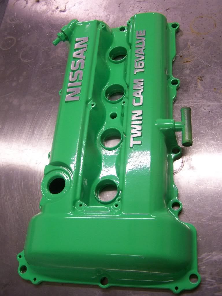

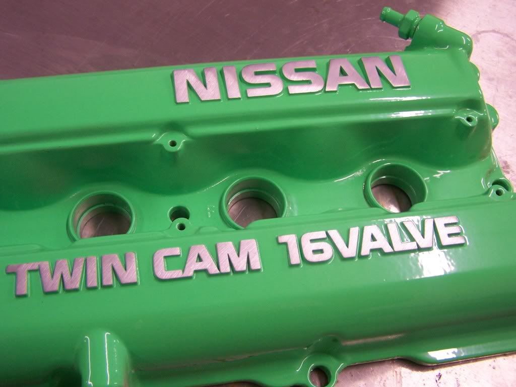

That particular set was ordered with two o2 bungs.
That's an sr20 valve cover, we are turbo-ing a ka24 240 and a Mazda Protege soon. As long as it's faster when it leaves the shop, we really don't discriminate vehicle platforms ;)
Here's what that same valve cover looked like when finished...
