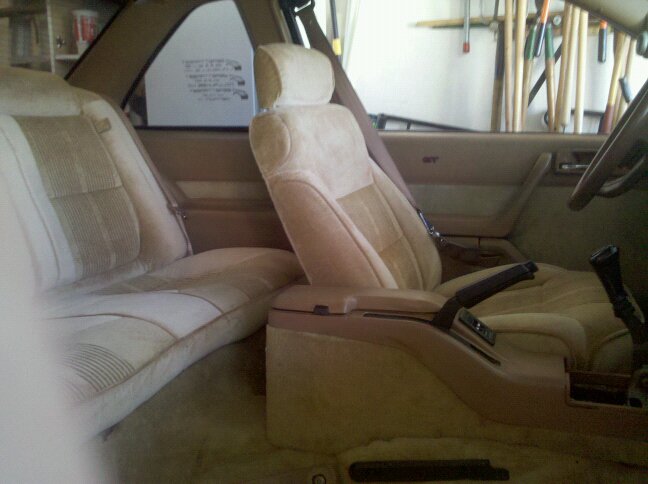

omg... le drool. Oh someday I'll restore my interior. I'm getting there. but not quite there yet. I want my sexy tan seats back.lmnjlo wrote:okay...okay...teaser pic #2!

That interior is very brown... LOL
Re: '89 Beretta GT/U Restoration
The body shop did the work before it was painted. It's all flush and smooth. The old seats were so worn out and faded. This cloth exactly matches the old cloth once we pulled back the seems and matched it up. This new cloth is an exact match believe it or not. Better dark then too light. Lol

fixed3X00-Modified wrote:
That interior is very sexy... LOL
