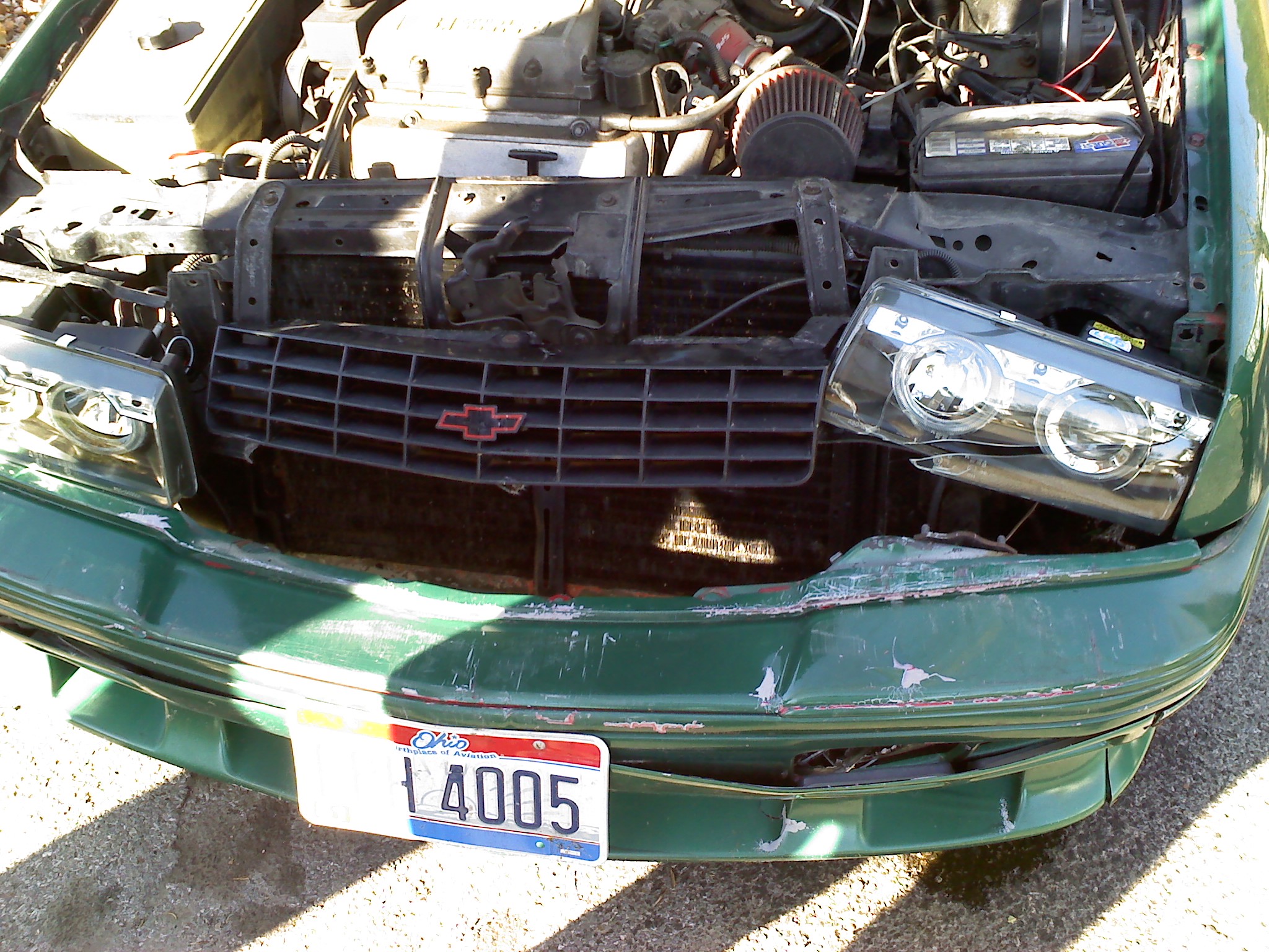

Its so sad i have most of the parts already except the brand new BMW E36 headlights i just put in. I will be re painting Burnout Blue.

Well i hit a caviler but then they drove off
. The core support has some damage to it my car went under neath the caviler bumper so it bent the front bumper support mount down and pushed the driver side core support back a little. I have the compleat z26 kit to put on fog lights, turn signal lights, stock head lights. What im buying tomorrow is the hood with no dents on it for $20 fender in same condition for $10 and the front bumper support free
so all i will have to do then is straighten the core support replace the windshield and new headlight mount/grill mount then ready for paint.

That's actually more work then you think. When I hit a deer with my first Beretta, the shop could not straighten the core support. Its a thin metal and tears when you attempt to fix it. You would do better to weld in a straight one.

When I lost my 90 I looked into fixing the front end. They told me the same thing on the core support. My car was too far gone anyway other than that, there was just no point for me to try. Yours is not even close to the way mine was. I hope to see it straight and back on the road by next year. Ace also had a bad deer hit so talking to him and Travelor would be a great help to you. I know you just hit a Cavy, but the damage is more or less the same.

Well today I bought both fenders, hood, headlight mount, headlights, turn signals, hood latch with mount, plastic cover that go's over the headlights, bumper clips, front bumper support and shocks.
