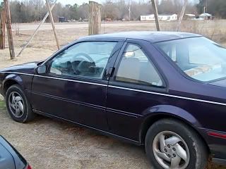

1994 Chevy Beretta
3.1 Engine (6 cylinder)
253,000+ miles
Hello all. I really need your help or advice with this issue. This started yesterday as I was on my way to work. I was going about 55 mph when the car suddenly begin to (I'm going to say) lose power, and gradually slow down to the point where I thought it was going to shut off even though I had my foot on the acceleration. This happened at random times both yesterday and today and it's becoming more frequent. The car will "lose power" and begin to decelerate for about 5-15 seconds), and then it will recover and go back to running normally. It even shut off on me while I was at an intersection waiting for the green light. It scared the crap out of me every time because I thought it was going to die on me. I really want to know what the heck the problem is. What part of the car do you think is causing this issue?
