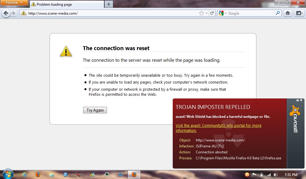

Wanako wrote:
DTMAce wrote:Has anyone even tried opening the website linked on the first post? If not DON'T. Its infected with a virus, my Avast popped a warning and blocked the page, has a JS script virus.
Anyways.
strange. I never did get a virus warning. I just opened it now, and I opened it when this thread first opened.
Still there....
