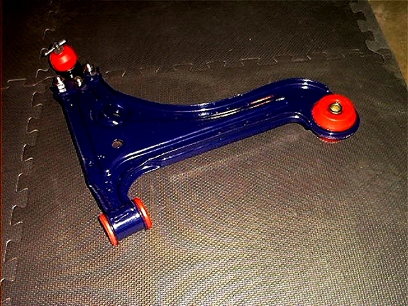

any pix for people to see on this
Re: A-arms bushings
94+ control arms with cavalier bushings installed.
I will be doing this with mine sometime soon... I am already running the fronts, I just need to get another set of control arms and I can do the full setup since what I have is somewhat rough.

Re: 94-96 A-arms Poly Alternative
Post by ErichZ26 »
who's is that? That looks nice. Do those J body bushings work nice?
I have the fronts only now... not sure what happened to this owner of this but when I find a nicer set of control arms im gonna do the whole setup like above so ill let you know then.
Post by ShaneLT(ShaneZ26) »
This may be a dumb question to some but its an honest one.
What is the name of the part that runs side to side in this pic? The shiny silver piece? And is it from a Beretta? If so where can we get new ones?
Post by Wanako »
Shanez26 wrote:Anyone?
the two silver ones? that would be the subframe. Where to get them new? don't know, but you can find them in most yards and are quite sturdy as long as they haven't been eaten by salt.
