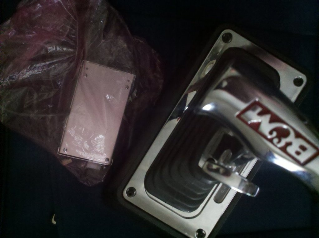

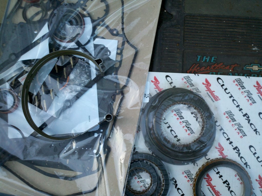

Re: No longer going to support the 3 speed...
After a few delays with parts and other interruptions that comes with life... Probably going to need to push my deadline out a little. Couple pics to stay active.
