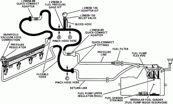

testing the fuel pressure requires a special tool something most places dont have either, unless you make one or order one online. its just a quick connect that plugs inline to the fuel line and has a schrader valve to test the pressure.

i found a pic

Posts: 10916
Re: 94 Quad 4 starting/idle problems
Depends on the quad fuel rail used too. Pauley's quad has a shrader valve right on the rail, Patrick's doesn't. Go figure.
You can see the brass cap on his FPR
And SGR I would agree with you on that one if he did not have this missing and ill running issues after punching out the cat... these symptoms alone will clog and kill a cat in no time, and I'm sure being of 20yrs old that possibly accelerated the process as well.

3X00-Modified wrote:Depends on the quad fuel rail used too. Pauley's quad has a shrader valve right on the rail, Patrick's doesn't. Go figure.
88-90 Quad 4's have the earlier style with the built in valve, and 91+ are like the picture Steph posted.
