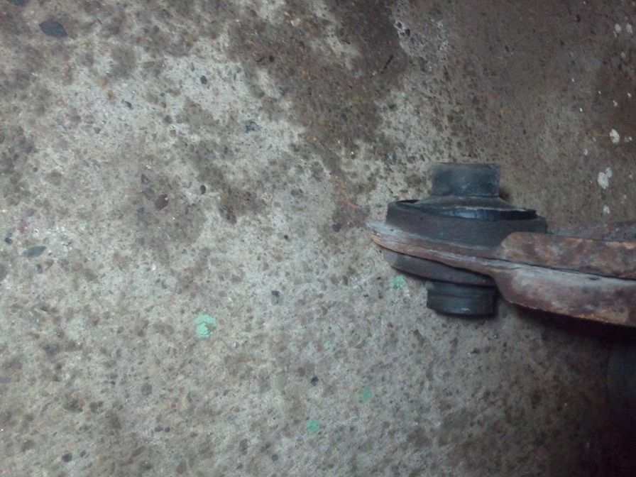

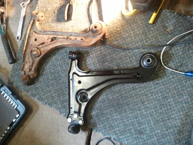

Re: Suspension getting old?
just another update on what to look for in your lower control arms, especially if they are original and you are in a rusty area...
i'd say they've seen better days.
