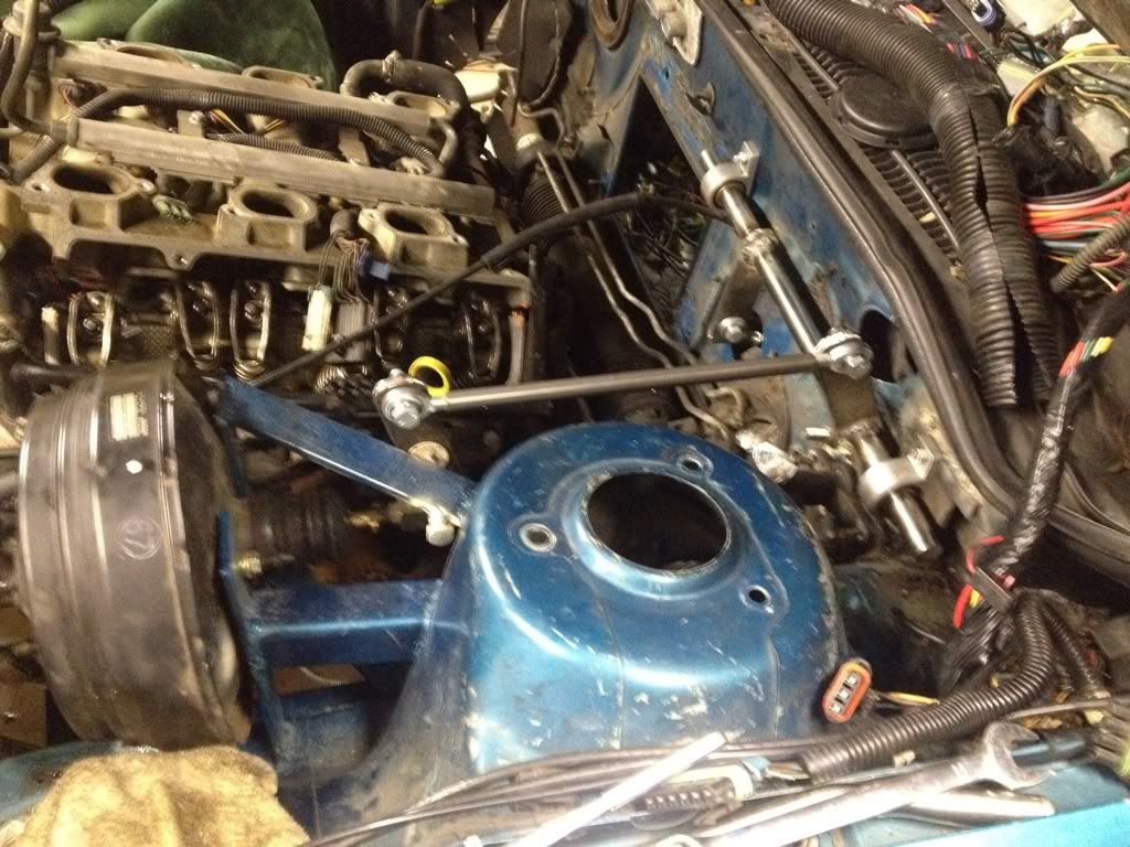

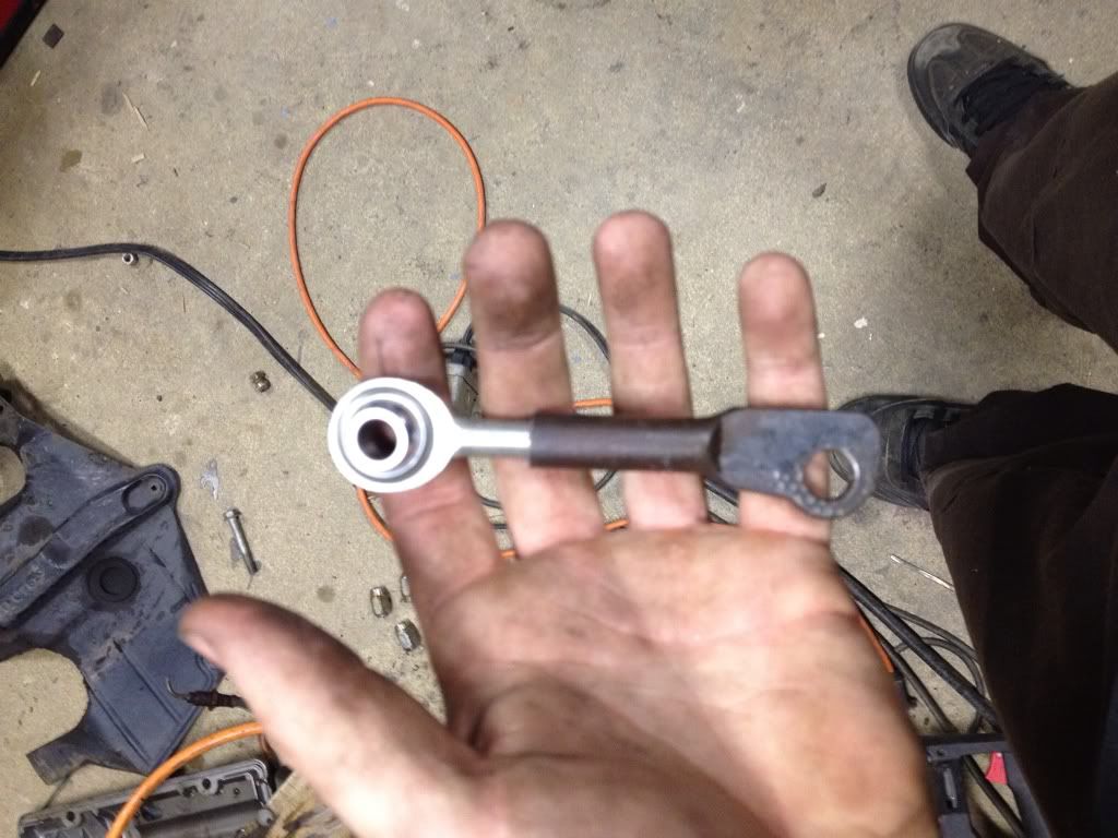

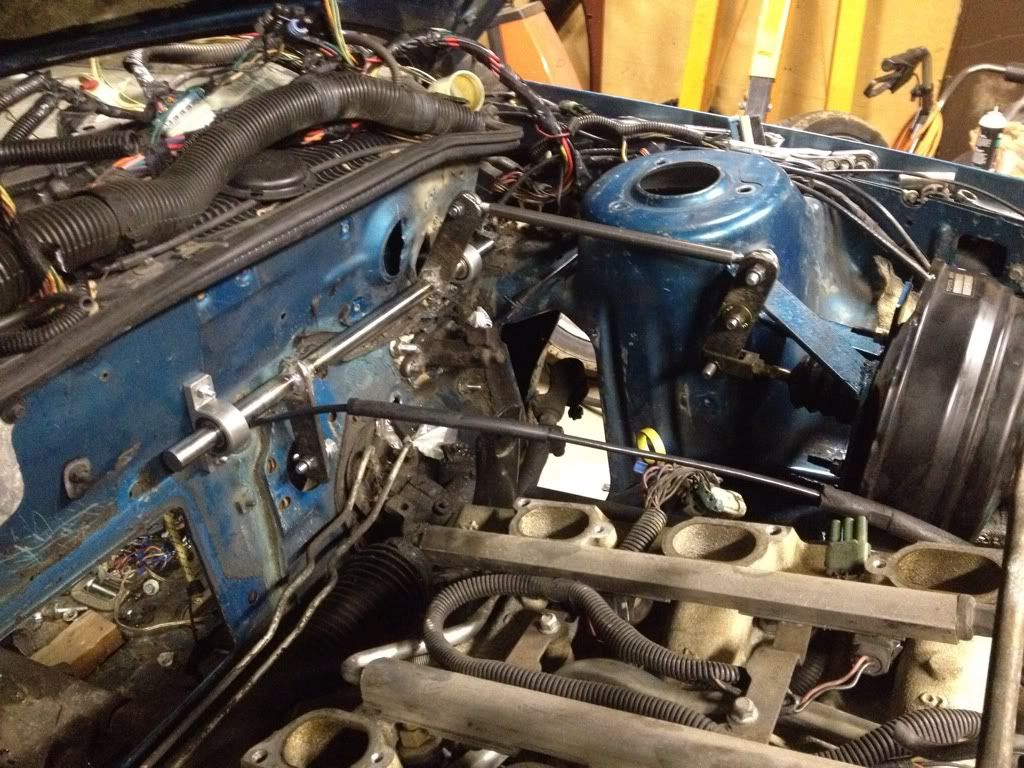

Gutted stock brake booster for its linkage and added a heim joint
A few more shafts, heim joints, and bearings later and TA DA... A awesome brake system that clears the engine hood and clutch master. Much better than the "bent rod" setup the bimmer guys do, everything is linear.

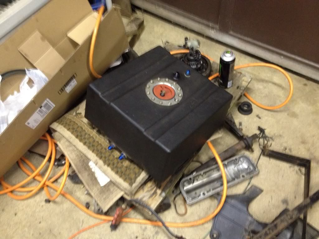

Also picked up a 8 gallon fuel cell and a walboro inline pump for the trunk.

very creative on the brake booster linkage! could that create issues down the road with the added parts involved? more play

The only point that does not have a bearing is the last pivot right before the booster. It only moves a few degrees and this car only gets driven a handful of times each year. Should be plenty good I hope

Looking great man. Really impressed with your setup for the brake booster. Just got to get it side ways real soon. hahaha
