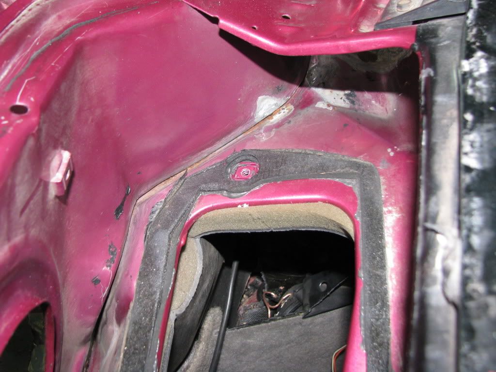

As far as firewall leaks in our cars... this is what I did to mine. Many will say its the seal under the cowl but that seal everyone says to go after is simply the cowl fron to the firewall which is a solid piece of metal from the windshield curved down under the cowl and to the base under the ps rack where the floor pan starts, so sealing that cowl area only stops water from getting under where that part is welded to the firewall itself.
This is where I ripped out all the factory sealant and replaced it with new Napa firewall glue.

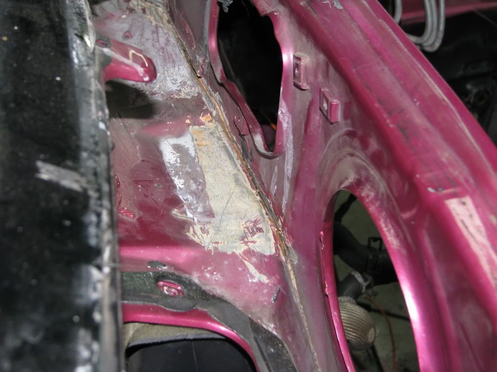

Here is an important seam
Drivers side

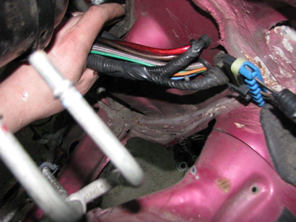

And get all around the brake booster, the drivers side cowl is probably the only cowl area that NEEDS to be sealed since it leads to right were the brake booster seal to the firewall is.
The passenger side leak is typically from the fresh air vent you need to seal that better to the firewall, but the cowl seam there isn't what causes a leak.
It doesnt hurt to seal these area's but they only lead into the engine bay.
