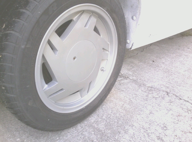

i finished up painting my first wheel today. while the process went smooth and the final result was satisfactory, the color is alot darker than it was out off the can. the clear coat seems to be the culprit. i was hoping for a bright shine very similar to the original but got more of a gun metal look. will polishing them up after a few days bring them up a little?
the cell phone pic doesnt do it justice but you kinda see the difference in the front and back wheel.

Well, you can't achieve the look of polished aluminum with paint unfortunately. But they don't look bad I guess.

yea they dont look that bad but i was expecting something a lot lighter. its obviously not gonna shine like the orignals but i'm split on the gunmetal look. i REALLY dont want to start over. the worst part is i'm going to have to ride with one done and the rest struggling until i get time for the rest!

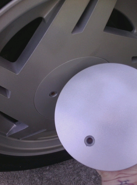

one coat of just paint versus the wheel from yesterday
