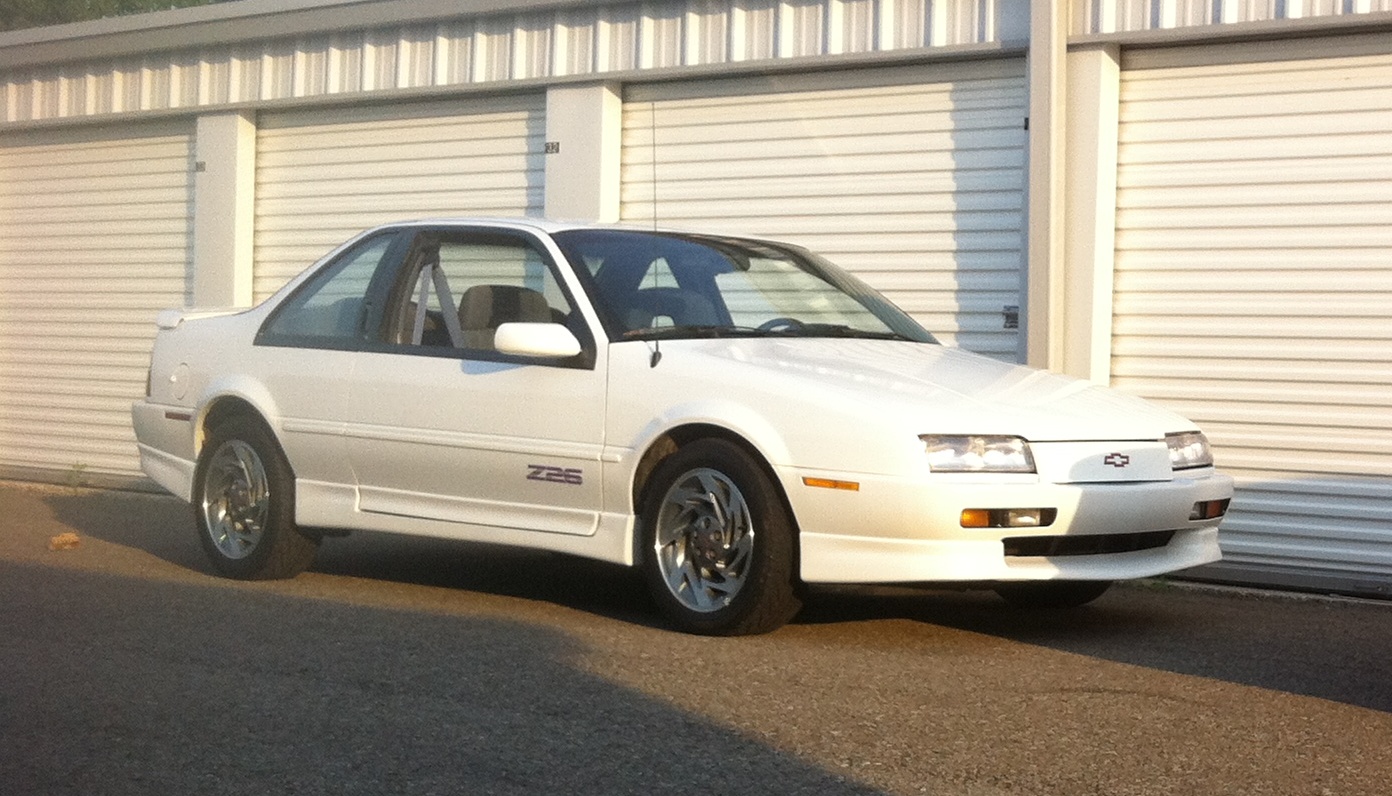

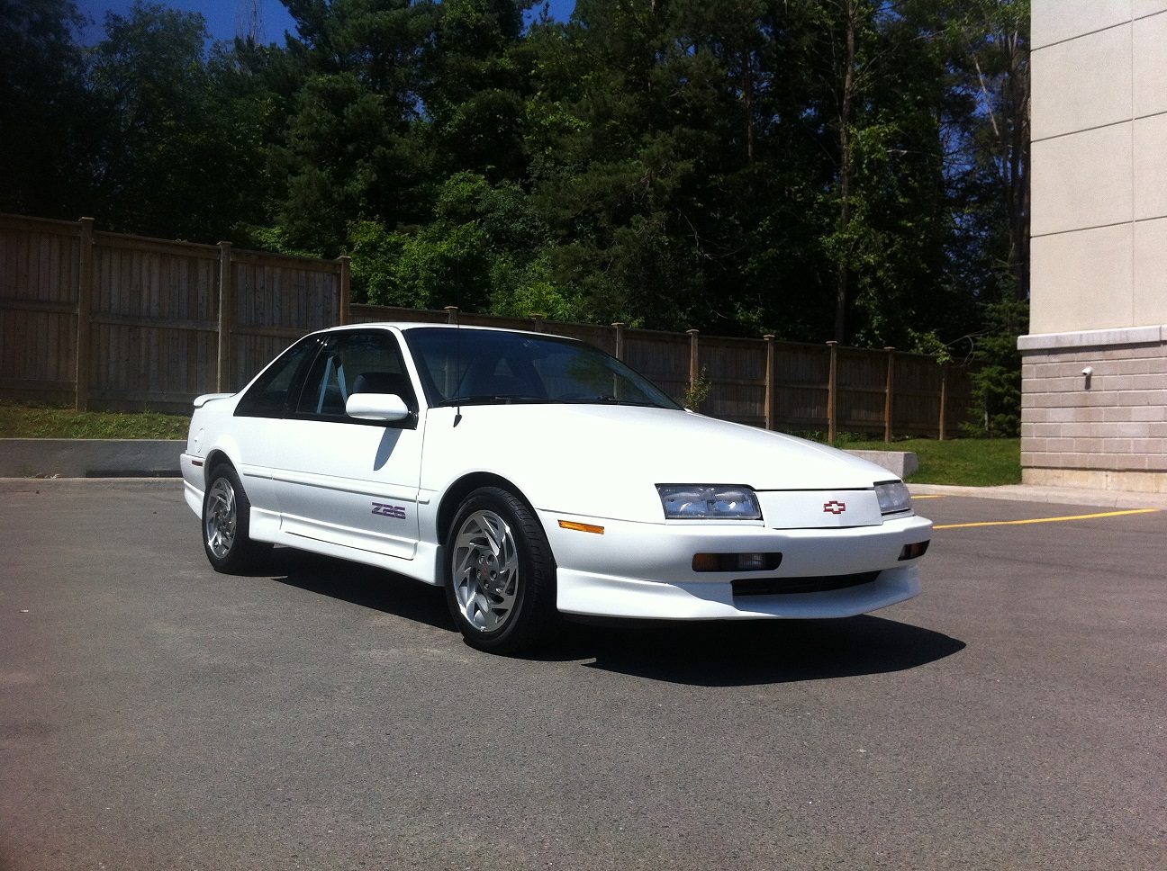

Hey guys,
I wonder if you could tell me how to pick up the sag on the front bumper on my white Z. It appears to sag in the middle and tip forward.
The car has never been in an accident and the front bumper has never been struck on a curb. But it appears that its saggy when I compare it to my red Z. Maybe im crazy but can you see what Im talking about by looking at the photo's?
Second thing, The piece of plastic under the headlights between the light and the bumper appears to bend and the ends. It's not happening on my red one. Do any of you have this issue also?
Is there any way to pick up the sag in the front bumper? (All the brackets are there in the right place).
I attached a few photos for you guys to have a look and one of my red Z to compare.
One last thing, the grill piece between the lights. There is a gap under it from the bumper and not as much on my red one.
I know these might sound nit picky but what are your thoughts?

Re: Front Bumper Lip Sag
The plastic under the headlights and grill on mine are bent as well. Maybe something to do with sitting in the sun?
