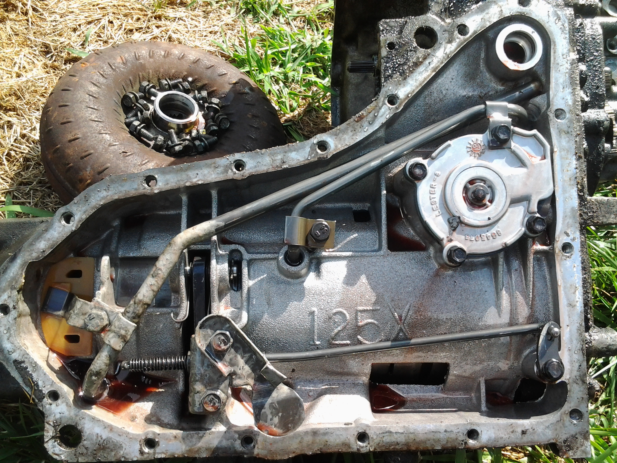

Can you get pics of the two transmissions that you have with out the pan and filter?

I will sometime tomorrow of the 3 SPD auto with TCC because I have that broken one, no fluid and easy access. I will take a photo without the filter.Money pit Beretta wrote:Can you get pics of the two transmissions that you have with out the pan and filter?

A day later than I said I would, but here it is.
Transmission 3T40.
Transmission 3T40.

Thanks. Well my mind is gone for sure then. I have had a THM250,350(two of them) and 700r4(1983) before the 3T40. None of those would have anything like what I was talking about. Sucks to lose ones mind. Well it runs in the family.
