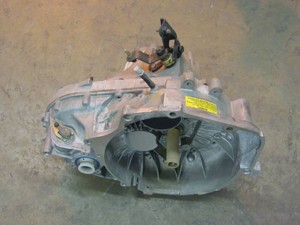

No you can't but an auto trans bell on a manual, think about that one a little harder... There is no bell on the auto... lol And you WOULD NOT want 4 cyl gearing on a V6 and vice-versa anyway, your thought process is completely backwards on that... The only reason the quad and 2.8/3.1 V6 bells swap is because they are both getrag 282 transmissions. If you want a 5 speed, find one out of a V6 GM car.GHOSTOWLGRID wrote: Wait. Pause and rewind.
The bell housing can be swapped out so as to let the I4 manual trans fit the 3.1L v6 engine?
Darn. Now I wish I took that trans from the junk yard.
Sorry if I'm hijacking but I have to ask:
Okay, will the bell housing from the 3.1L v6 automatic trans go onto the I4 manual trans so I can use the manual trans on my v6?
I'm away at school, I can't do anything relevant till I get back home and do things; so I have to ask.
My issue is getting the trans to mount on the engine. The rest is manageable like the clutch parts, other mounts.
(As for the extra torque from the I4 gearing, that will be fun for the occasional burnouts. Plus the way I am with a stick, I tend to stall the engine easily.)
Auto...
Manual...
Also, your Impala cradle swap idea won't work either, especially when you can just use the existing frame rails and mounting locations. All this info is already all over the net, do some research before sounding so silly.

Oh okay, I got the wrong idea about the transmissions.
Thanks for straightening it out.
