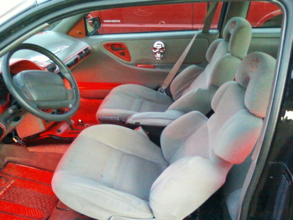

Not racing seats, but perhaps you would be interested in mine:
http://beretta.net/forum/viewtopic.php?f=13&t=9927
I actually had racing seats in my 95Z and grew to dislike them over time.
