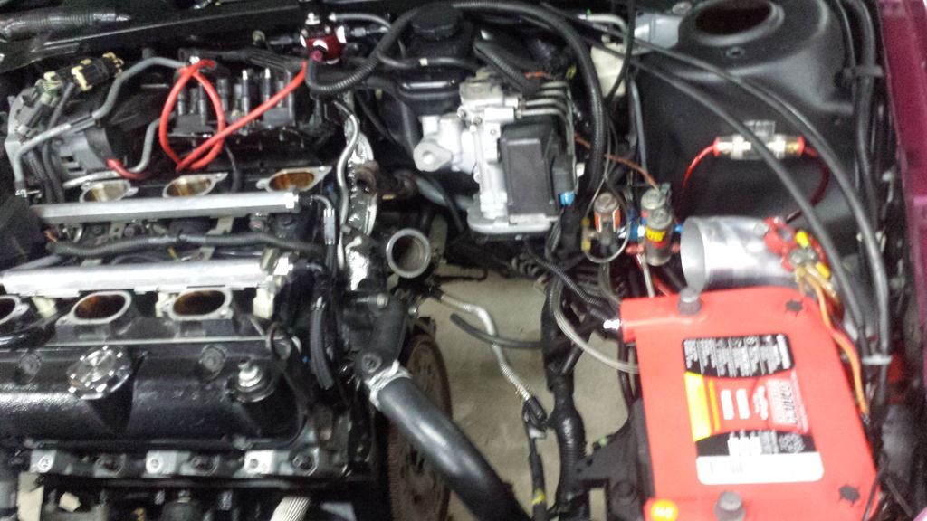

Just use the relay's 87 and 87a pins to avoid feedback to the PCM.3X00-Modified wrote:But I would have to have a diode between the output of that timer and the ECU so it doesn't feed voltage backwards to the output pin on the ECU.

My original idea was to run the factory relay with the small timers 1988gtu posted but it sounds like your suggesting to run the pump itself with the timer. I guess that's a possibility but I think I'll try out that relay timer I found and he posted up first since everything will be enclosed. I can just run that inline on the green white wire and it will come on when the ecu wants it and stay running when the ecu removes power.

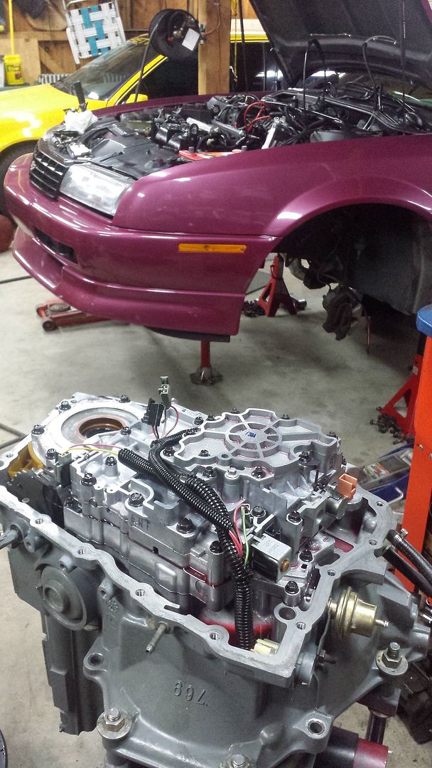

Ordered that relay today... Pulling the trans tonight to find/fix leak on the torque converter area as well as troubleshoot my TCC not working.

What I was referring to was wiring it like this... PCM fuel pump relay control to pin 87a, ground to pin 87 and output to factory FP relay to pin 30. This way when the relay is energized, you're effectively bypassing the PCM control and grounding the output to the factory fuel pump relay, when it's not energized you're following the original factory circuit.3X00-Modified wrote:It sounds like your suggesting to run the pump itself with the timer. I guess that's a possibility but I think I'll try out that relay timer I found and he posted up first since everything will be enclosed.

Torque converter seal was leaking and the TCC wasn't engaging... Have to evaluate the valve body I chose to use and make sure there isn't something wrong with it. Solenoid checks out fine.
The factory relay in our cars is 12v triggered by the PCM though... I'm going to use that timer relay inline on the trigger wire so it will energize the relay when the ECU energizes it and it will stay on as long as it see's that input but when the ECU shuts it off it will be set to run for 30 sec or so... That way upon prime the pump will click on and stay running for 32 seconds
and after the car is shut off the pump will keep running for 30 seconds.

So this whole time the tcc was working fine... Worked the same after re assembly which included slipping over 600 rpm when locked... GARBAGE! So I just spent the last 4hrs removing and replacing the converter with a FD9B that I had lying around. Time to ensure that locks up just fine so I can tear into RevMax... Not sure if I'm going to have it fixed and in before Mississippi or if I will just request a refund and find another shop.
Fuel system also converted back to a flow through rail. The deadhead was causing very hard starts and I can only assume it was due to a huge air pocket because the pump running constant while cranking made no difference.
