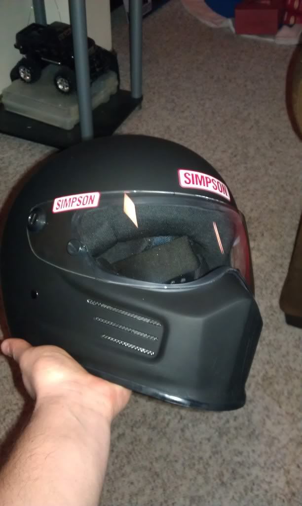

Wrong helmet...bonecrrusher wrote:Its black Stig!
I have the black stig Helmet...

I like the helmet. I need to get one now for my SS
