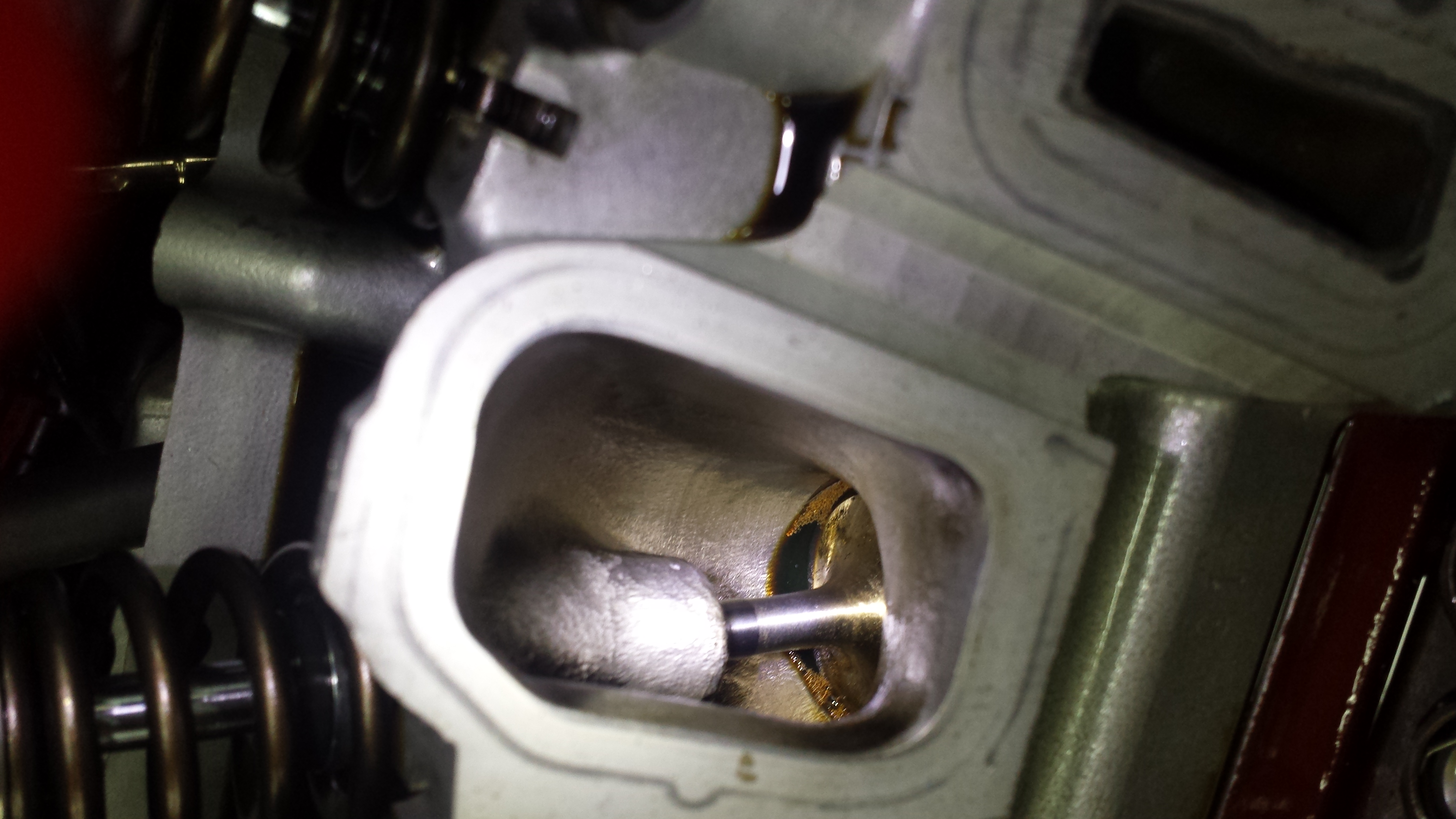

Re: 1996 Mr.Pink
Pulled the LIM off today... so far I can't find anything that indicates that gasket leaking oil in. The head ports are as clean as I remember them being, as for the LIM runners those are where the oil is pooled up.. Still not 100% sure if its JUST the breather system causing this issue but the only thing I can do is clean the upper and lower VERY good re-assemble and then watch it closely. All the valve seals are 100% intact so I know that's not the cause of it.

Re: 1996 Mr.Pink
A whole lot of work for notin... Except for finding which valve was leaking oil and finding the bad seal..... Grrrrrrrrrr
- Posts: 10923

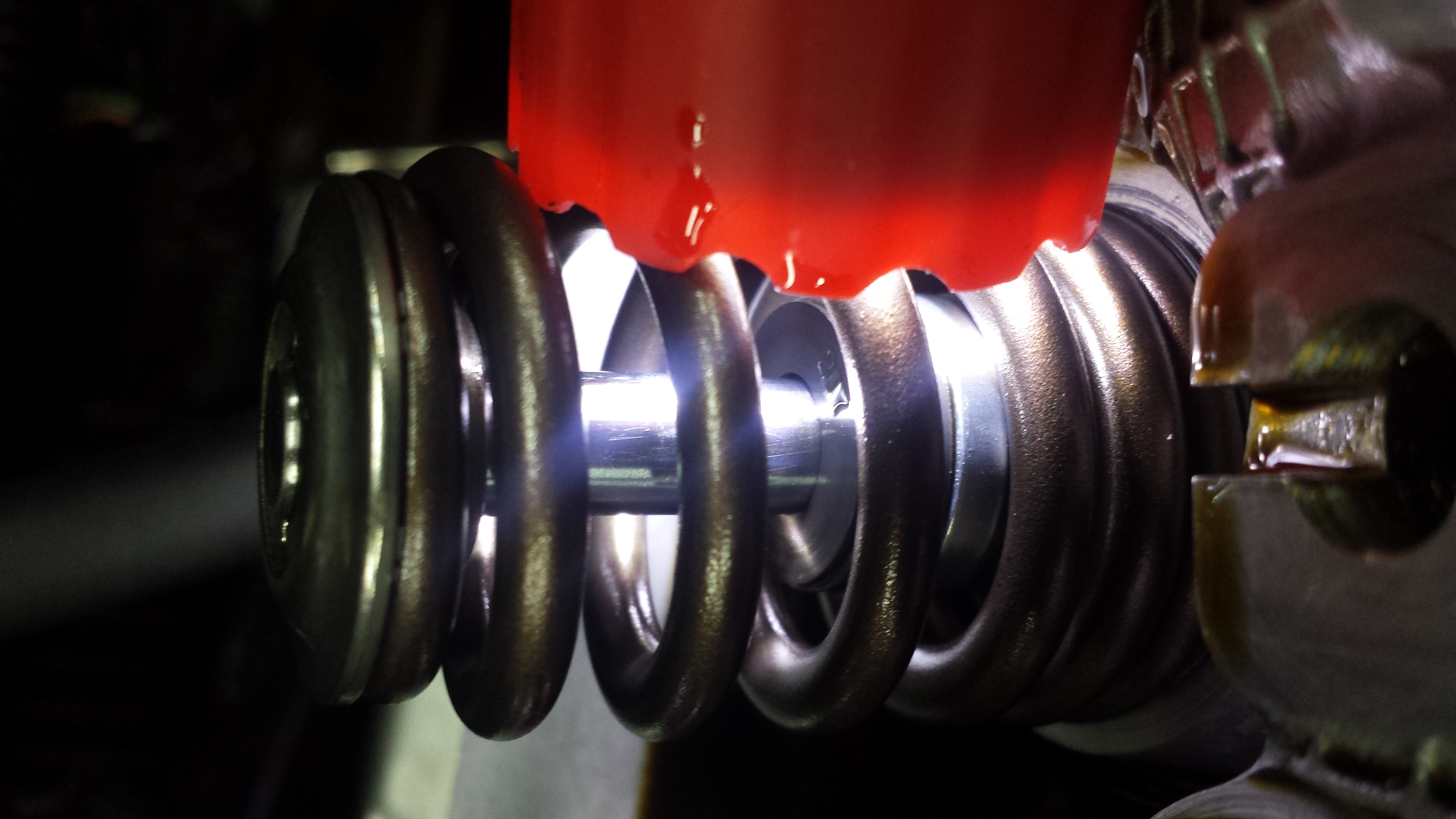

Re: 1996 Mr.Pink
No its the valve seals again... Nothing wrong with the LIM or gaskets.
These 2.2l seals don't sit straight on the seats so they are off center compared to the valve stem. I think I may go back to stock seats and just find shims to get me where I need to be. 0.015 and 0.025 would work.
