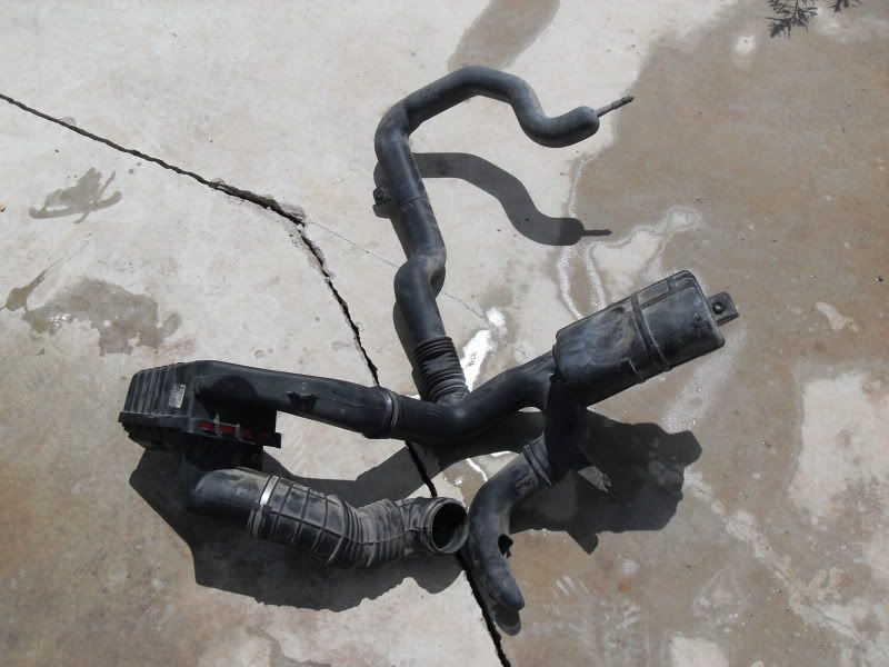

Why move battery... Do you need the room yet? If at all possible moving the battery to the trunk is not a valuable mod unless the space is needed. It will typically cause problems with the voltage drop you will see over a 15ft wire.
SuzukiGhostRider
Posts: 2464
Location: Milan NM
Re: Not a Beretta, but a Beretta engine... Kind of... '93 SCX
Post by SuzukiGhostRider »
Might possibly move it for my WAI. But , I've installed it and it SEEMS to have clearance. Pics.

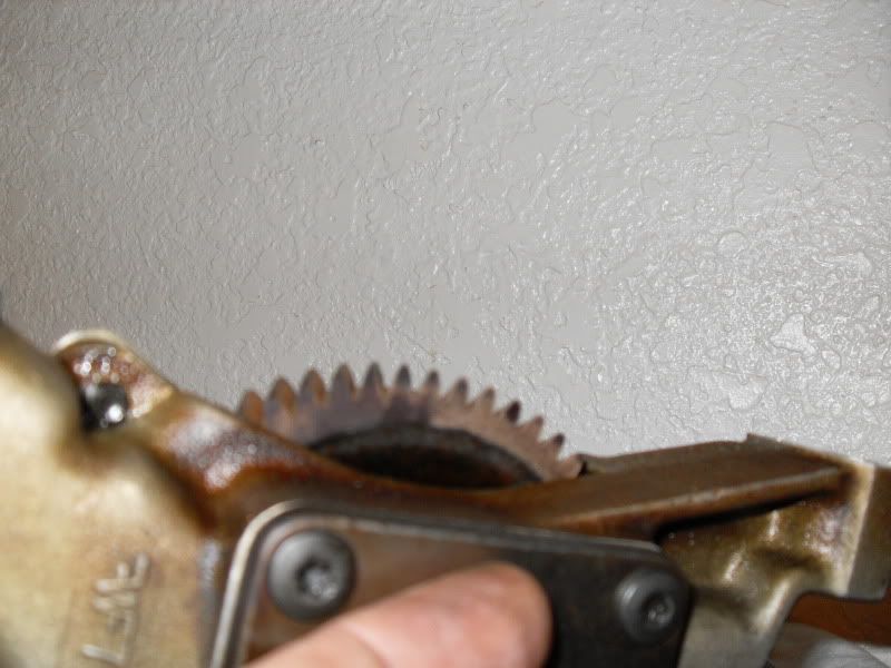

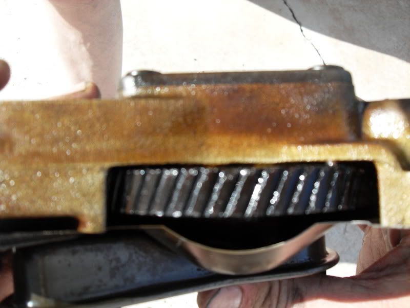

Ok, new oil pump gear pressed on pump, pump re-installed. OP at initial start: 65-70 psi. after warmed up 35-45 psi range after long running, she still likes to 'bleed down' to 25 psi. I'm assuming the pump housing clearances are worn. I will probably need to still replace the pump itself at a later date. I went with the factory recommended 5w-30. I think next week, I will swap that oil for some 10w-30. Thinking that will keep the OP at 35-45psi.
When I say 'bleed down' , I'm saying the further I go down the hwy, the more she GRADUALLY bleeds down, but never below 22 psi. Still, I don't like it. If she sits for a few minutes off and you start her back up, she goes right back up to 40 psi. So, like I said, it IS a 156k motor, we'll see what some 10w-30 does for that problem. Still OP is present and MUCH better overall. Lifters pumped back up fairly quick right away, were still slightly noisy. After shutting her down to check oil level and restarting they were MUCH quieter than they've been since I owned the car. Valve train noise is almost non-existent. :D So , I'm thinking a little heavier oil, and she'll be good to go.
Oh, and below? Old OP gear, new OP gear. See any differences? :D
