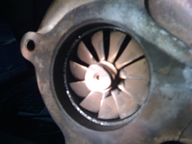

Re: Recomendations on new turbo
Disassembled the turbo and it is definitely leaking from there. I can see it through the blades and it is also on the lip.
Cell phone pic but you can see the oil a little.

Thanks for the info.
Luckily it looks like I will not have have to tear into the motor. The turbo is clearly leaking oil so I ordered a new one that should be here in a week or so.
