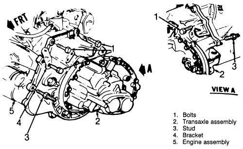

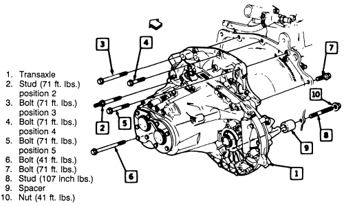

The Quad Getrag and V6 Getrag have different bell housings. BOTH are 282's. BUT... you would have to swap bell housings to mate the Quad Getrag to a V6. The Isuzu WILL MATE to a V6... BUT it will not handle the power of a V6 well at all. It's too weak.DTMAce wrote:Then why does a getrag work with either? Or am I missing something?

And no, it's NOT bs. That's accurate information Barry.

Here's your proof and pics.
First is the V6 Getrag.
Second is the Quad Getrag.
See the differences?
