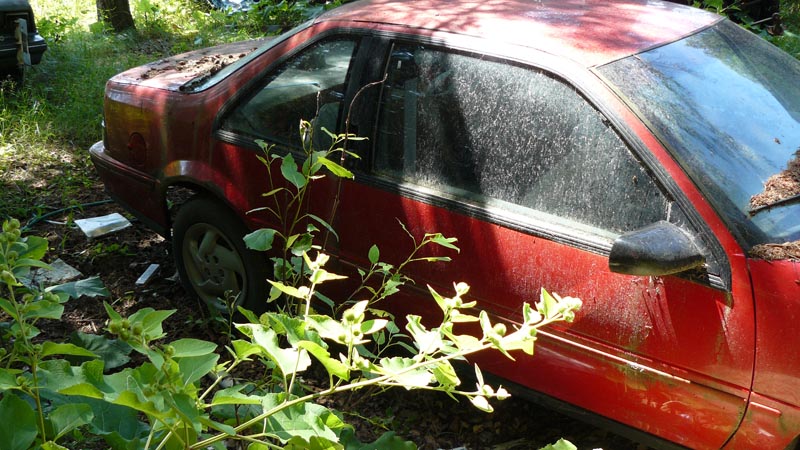

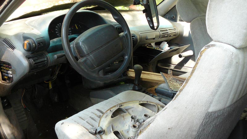

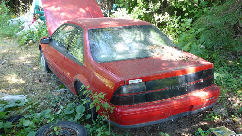

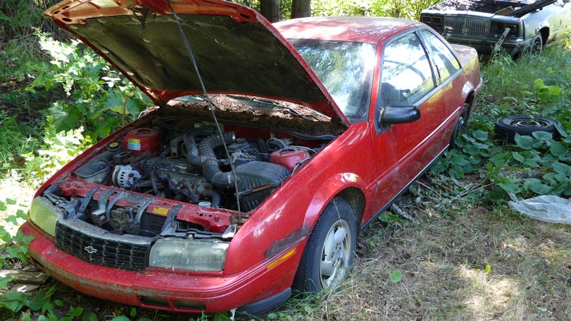

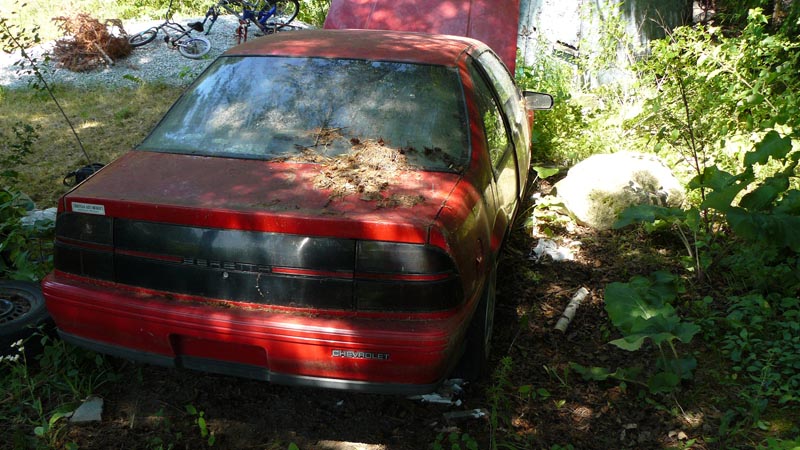

What I want to know, is it worth fixing? Engine overheated and seized we think. Definitely had overheated anyway.
5 speed manual with the 2.2 Bonus. My thoughts were to drop in a 2.3 HO. Is it easily feasible with this car, or is it a lot of work, harness changing, etc? Or would it be better to do a 3x00? I am even tempted to just rebuild the current engine.
Lower front pillars are rusted clear through to the rockers. I might be able to patch that with some metal and a welder, nothing pretty but to strengthen it.....
Pass door handle broken clean off.
Rear seat bent inward. Trunk opens fine with a key though, so no idea what is up with that.
Lots and lots of pine needles. (those are included free)
Interior is a complete mess. Been wet inside a lot too. Big surprise there.
Body wise, its mostly decent (not all beat up) but has rust at the fender lips, and probably nasty underneath I'm sure.
I'm thinking 150... 200 maybe. But wanted to see other opinions. I may have a lot of work to do, to make this road worthy. My other option is to buy it for parts (manual tranny) and sell/scrap the rest.
Talk to me, let me know what you guys think. I would rather save it, and have a DD out of it, but if its going to be a bastard to do much to it and cost me a lot...... Anyway.

With as long as that looks like it's been sitting in the grass/weeds, I'd bet the underside is rusted through BADLY.

What year is it? It looks completly destroyed to me. I just scraped my 95 base 2.2 auto, and it ran and was in much better shape than that. IMO it dosn't look worth the time or money, but thats just me.

Should be an Isuzu transmission on that 2.2L. I don't believe they will just "bolt on" to a 2.3L HO. Also, I'm pretty sure the wiring harnesses are different between 2.2 and 2.3 as well as ECM's , etc. It would be a LOT of work to convert it to a 2.3L Quad, but as you said, anything is "doable".
I would take a HUGE pass on it.
