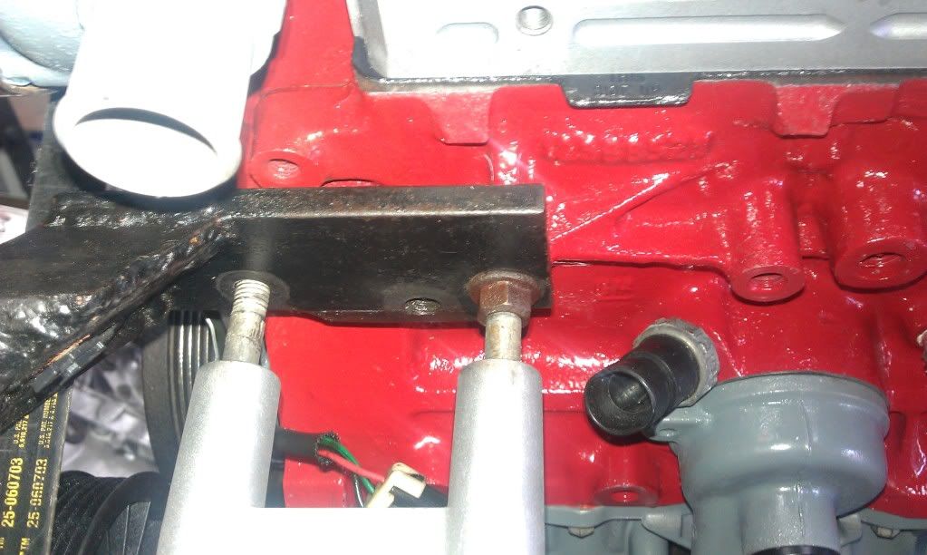

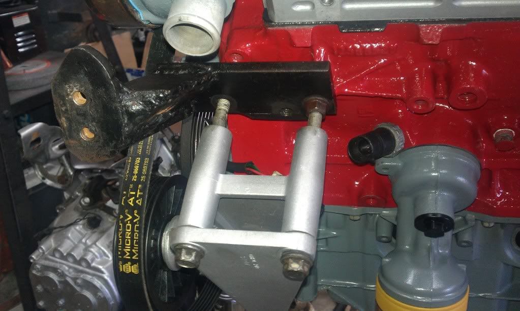

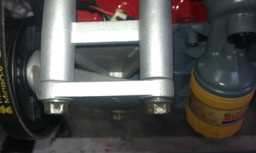

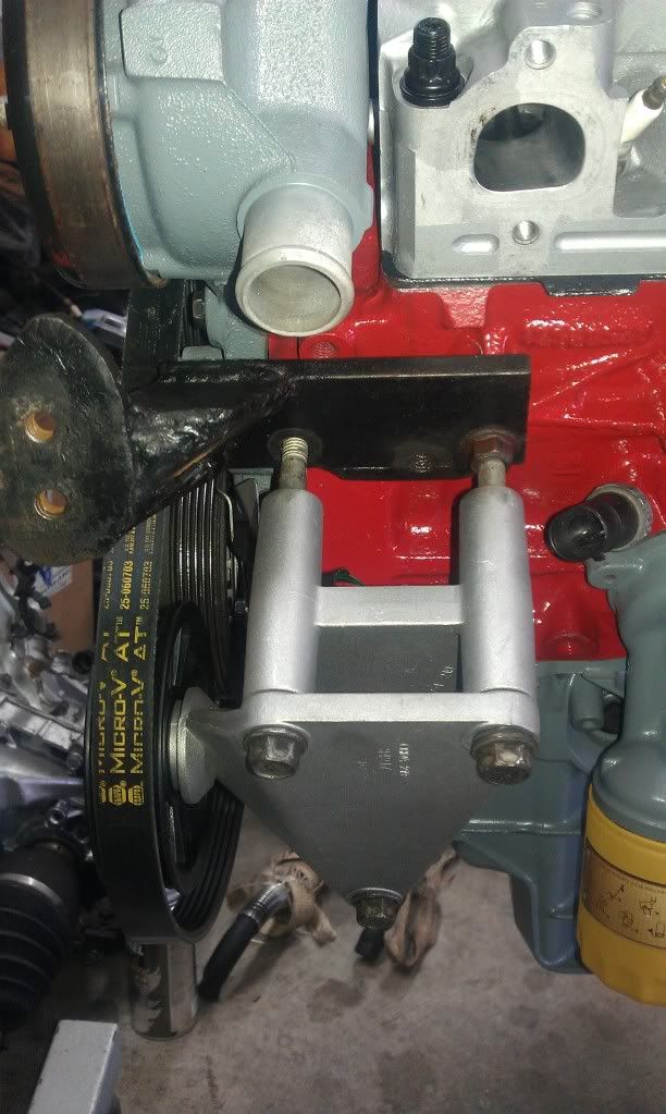

Re: Roberts 89GT Engine build.
scd88ga wrote: Jon, if you want to ignore my posts that's fine, the build looks great so far!
What do you mean by that? I've been busy and if its not during the week, I'm barely online on a full PC.. I typically check on the fly on my phone.
I had a stupid issue with the AC delete bracket but resolved that then Kurt pointed out to me that the front motor mount will not work anymore... LOL DAMNIT!
So I had to get creative.
I figured I could just sandwich the motor mount in the stack and just thin out the stock AC bracket spacer but once I thought about it I figured there wouldn't be enough clamping force on the motor mount to hold it solid and I was not about to risk it moving or making a clunking noise... So I quickly tested putting a nut on the threads since there was enough space and then I can treat the long bolt as a stud and clamp the motor mount with a nut then put an appropriate spacer after that to space to the AC delete bracket.
I am going to try this with a different set of nuts and washers and it should work out just fine, otherwise I'll go with a threaded rod in place of the bolt.
Test fitting with a nut
Just needs a washer to space properly or I can add 1-2 more threads on the bolt with a die...

Wonder if the radiator hose will be ok with that bracket there?

Robert 89gt wrote:Wonder if the radiator hose will be ok with that bracket there?
Don't jinx it, but it should be ok.
Scratch all that mount mumbo jumbo... I just got the right delete pulley from Advance auto that appears to use his existing bracket that will bolt right back on.
