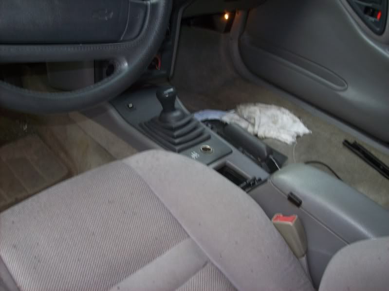

Well slowly but surely, im doing little things with the car. I had a shift lever from a Fiero i have been meaning to mod to use in my car as it is unique in its own little way. The lever positions the cable pin way out on the drivers side, so i had to do some work to relocate the pin to the inside of the shift lever. Now its not 100% perfect, but it is fully functioning and nice and short. The lever was modded before i bought it out of a junked car, so its in the ideal position already and shortened, just needed the pin for the Beretta cables.
The height between it and the shortened Sunbird lever that i have been using is about 1.1" shorter. Its so short i have to change the shift boot so that it wont interfere with shifting into 1st and 2nd. The funny thing is, this lever makes it use only the lower left 25% of the shifter boot and hole. I may have do some other modding, but we shall see. I have a shift boot that is a thinner material im going to try and see if that helps.
Here is the shifter after i removed the stock cable pin and pushed in a pin from an interior selector arm.
This is the Fiero lever with the Sunbird lever, you can see how much shorter the Fiero one is. Also to note, the sunbird shifter has already been chopped 1.2" from stock.
This is how tall the knob was before the Fiero lever
And after
You can see how much the boot is now bunched up around the base of the shifter. So changing the boot is a must! Also, the difference in the throw between the two levers is about a full inch. So its a very short throw now!

Im starting to think i will start modding shifters and selling them if there is enough interest.

The boot wont press down in so it's like inverted like my subaru shift boot?

Jon it didnt before today cause there was so much bunched up. I have a thinner material boot in there now and im gonna take a pic and load it up later this evening to show. At the time of that pic, i did have alot of it tucked down in. I have to learn the material around the base of the knob so when you see a rubber band around the top of the boot dont worry, its only there for a couple days then i will remove it.
This thing is so short now i swear my total shift throw is 3" or less. The side to side is really short too as i also have the shorter linkage from the 94 grand am on the trans mission. Makes for one fast shift!

Okay prepare for massive amounts of pics lol Why i took so many i dont know but its all good i know you all like pics.
Okay, with the "new" boot on, in 1st
2nd
3rd
2nd
3rd
90GTZHO
- Posts: 1068
- Location: Paulden, AZ
Re: My W41 GTZ --Update 4/30
4th
5th
Reverse
ANd finally a shot to show you how much the shifter is confined to the lower left quarter of the boot area, this is the shifter up in 5th gear
All the gear ranges are right there close to the drivers leg, makes for easier shifting on me as i have long legs and short arms. This is a very notchy shifter now, and does feel hella tight, like brand new! So yeah, im lovin this thing even more now!
