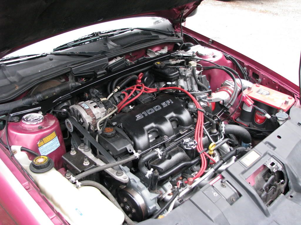

There is no hole in the 3500 LIM for the coolant temp sensor, its in the side of the head.
If you have an older setup where you have a 2 pin sensor and the 1 pin sensor this doesn't generate many issues, You just use the stock 3500 2 pin sensor in the head and then either re-locate the 1 wire sensor to the back of the block with a thread adapter, or you drill and tap a hole in the corner of the head like I did on Roberts car.
For a 96 style harness you can re drill and re-tap the hole on the side of the head to fit the 3pin sensor, but it's hard since you need to re-center the hole, if you just open it up your making one area of the head very thin... not good for warping issues. I had a 3 pin sensor turned down and re-threaded, but it makes that itself very fragile too, since your turning it very close to where its drilled out on the inside, so it has to be done carefully.
OBDII beretta's are 3 pin sensors located in the LIM, OBDI.5 Beretta's are a two pin sensor in the LIM and a 1 wire sensor in the corner of the head, Neither the 3400 or the 3500 has that hole for the 1 wire sensor on the head corner, so if you go with a 3400 you can re-wire your harness to have the three pin sensor like the 96 and just put it in the LIM, or you can do the above on the 3400 head as well and just use the two pin sensor in the LIM as before.
You can see the 1 wire sensor on the right head on this pic, as well as the stock sensor right in the side of the head.
