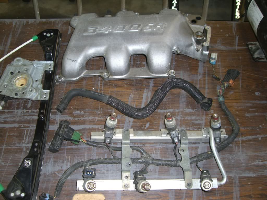

If it's not a 99, and you need the 99 setup, I have one! It's complete with fuel rails, wiring harness, MAP sensor and injectors! It came off my friends 99 GAGT that I parted out for him after it was hit in the rear a few years ago. The car ran great and had only 65k on it!LOLVTEC wrote:Thanks ron, i'm fairly certain the motor is out of a 99... I suppose theres a code of some sort to check on the engine?
Does anyone sell or make said bracket/mount?
If you or anyone else are interested in this (or any other parts for that matter) let me know!
*I no longer have the 99 3400 UIM in the picture.
