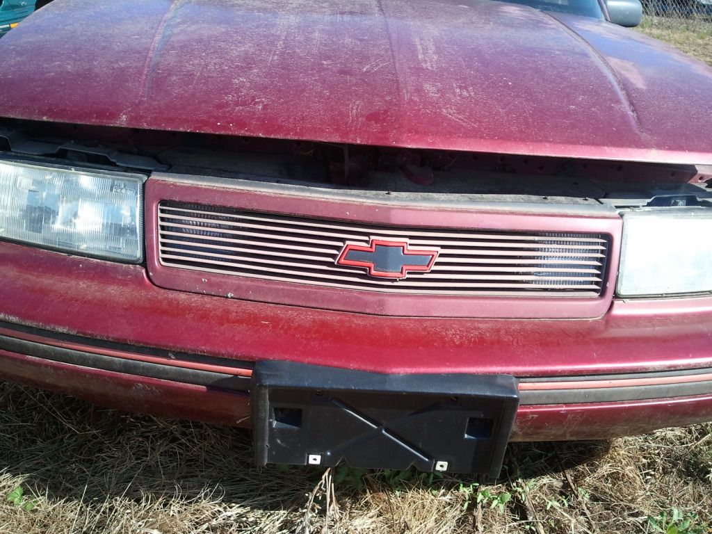

I dunno, I think you should pick up this rare 1990 "ONLY" Lumina Euro grill I found at the yard today and paint it to match! I think it's sweeeeeet!90GTZHO wrote:The Z34 grill was planned for this, but now im just gonna leave the stock front grill. I like how it accents the vents on the top of the hood.
I like this better than...
This...

Yeah while those are kinda rare Brett, im not really a fan of them. Plus, they dont really flow well with the Z34 vents. You also cant shave the badge on the grill like you can the other two

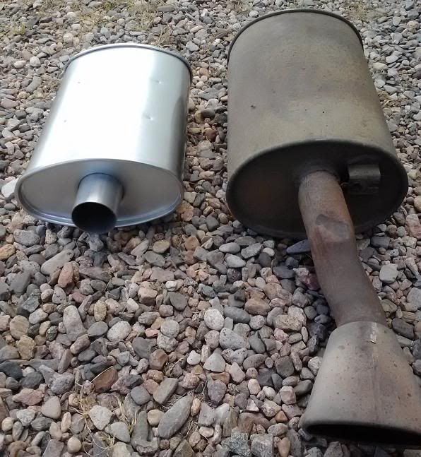

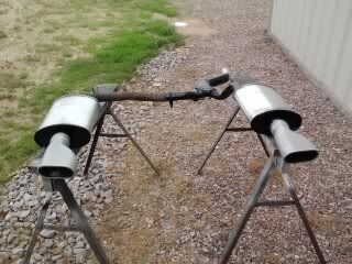

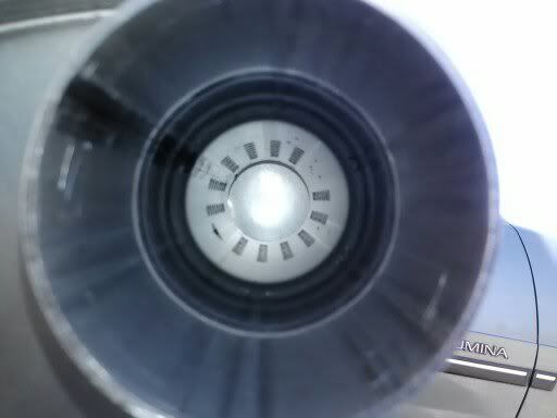

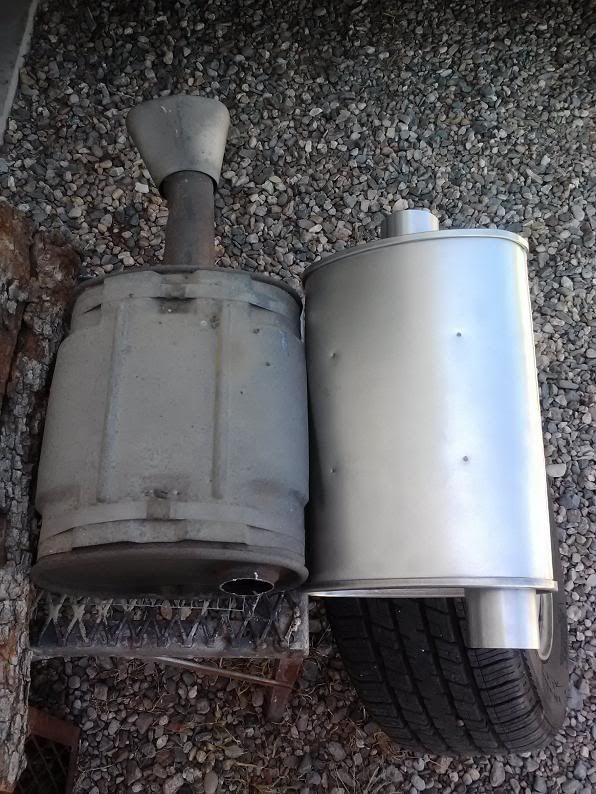

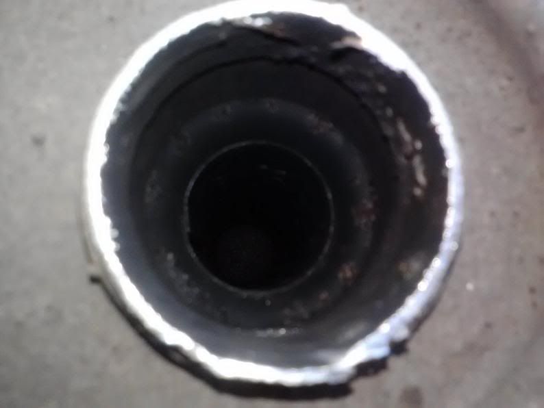

Yesterday i finally got the rest of the exhaust on this car done. I went to O'Rlys (lol nice) and bought a couple of Flowtech Raptors on a gamble. Since the stock Z34 mufflers suck balls, i changed them out with these. Overall, im very pleased with how they turned out. Later today i wil try and get a vid of it, but it sounds pretty mean for a 3.1 i think.
Old vs New, drivers side)
Passenger side
Stock insides
Raptors Guts
Pulled the Y-pipe back out after i get the mufflers tacked on and finished the welding off the car, made things so much easier! Install my 98 Firebird Formula tips i have had for a while and get it all a quick spray with some paint.
All done
Passenger side
Stock insides
Raptors Guts
All done
