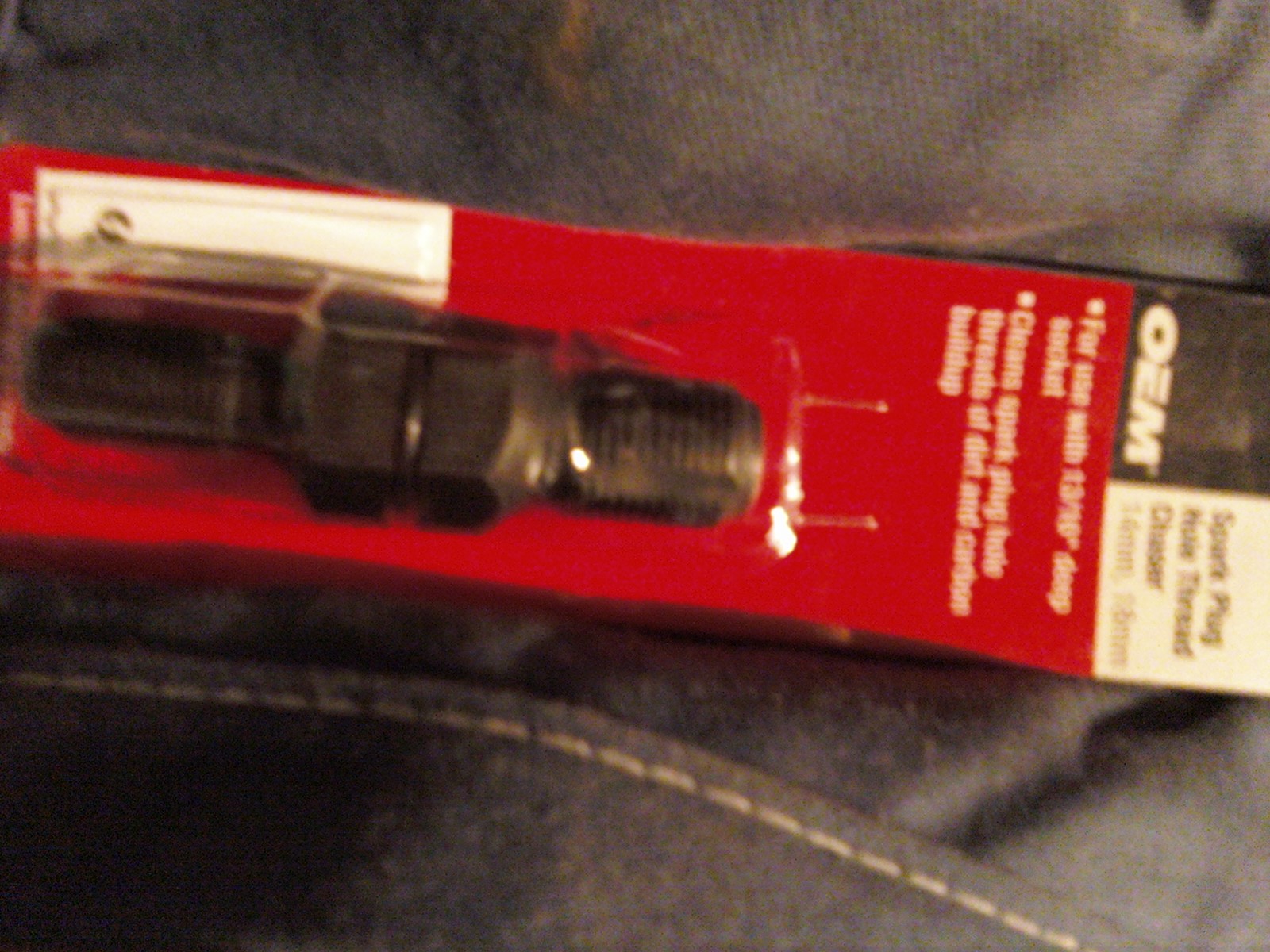

Thanks.. I found a cheap chaser at the part store, don't have any saw to cut the threads on the old plugs anyway, wasn't sure what else to use (for future reference, or for anyone else reading, what else could be used to cut those old threads?)

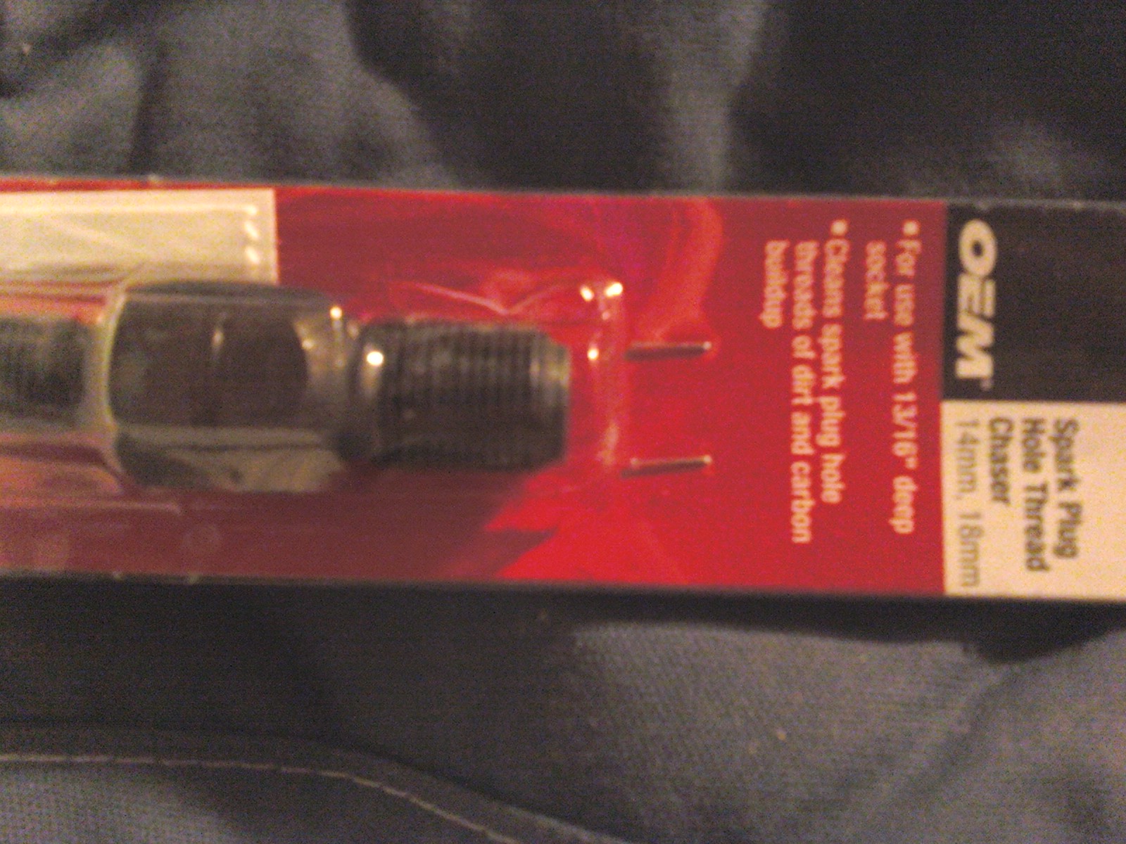

I've attached a pic.. please confirm i got the correct part.. loads into a deep socket..
am i using this chaser like mentioned before, where you grease it, go in until it's snug (i'd feed it by hand to make sure it's right), then add 1 or 2 turns with the wrench, take it out, clean it, and re-grease and repeat?
Or is there no need to worry about filings in the cylinder when chasing as opposed to tapping so don't keep stopping?
thanks very much..

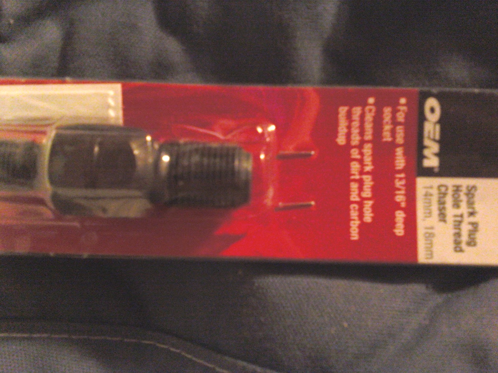

thanks very much..
Re: 95 Beretta 6cyl- intermit rough idle/run/stall
The grease should pick that stuff up. Remember that your are not making new threads, just redoing the old ones. The problem is that there will be grease in the threads, clean it out as best as you can. Yes, 14mm is the right size.
