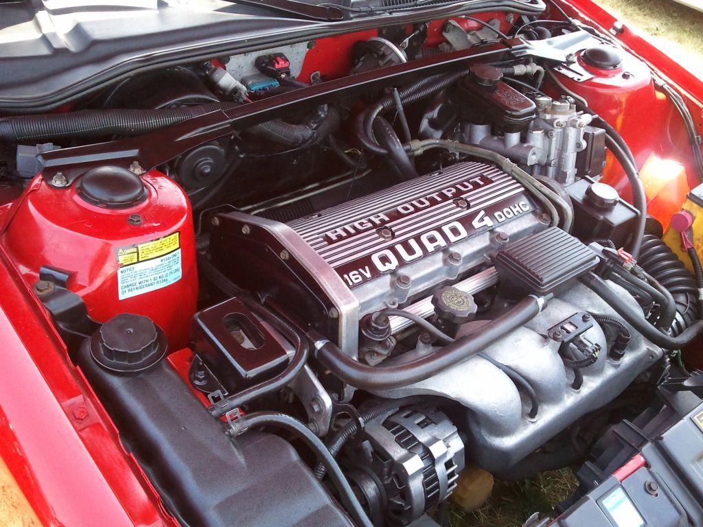

^^^ This is how I did EVERY piece on my car and well as tons of parts for customers! Either with a drill or my bench mounted unit. I did every piece on my motor with a drill!3X00-Modified wrote:may I recommend

God I want your motor Brett!!! Can't wait to actually find one in my price range used that runs and I'm gonna make her look like yours except I can really decide if I want to go with the cast iron block paint look or the black like yours or chevy engine orange which would be my favorite choice idk yet

It was torn down to a bare block, I did one piece at a time.berettaboi wrote: yeah, you did a great job on the quad there! it's much easier when you're standing over top of the thing doing it as well...

What did you do with your timing case it has a nice shiny look to it, did you polish it?

Nope, it's just wire-wheeled like everything else. You can use thin wire brass wire wheels to get a smoother finish if desired. The aluminum won't stay as bright as it does initially obviously, but this is how it looks after 2 years including Winter driving!1990BerettaGTZ2.3L wrote:What did you do with your timing case it has a nice shiny look to it, did you polish it?
