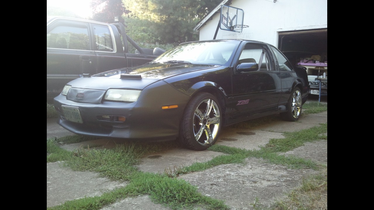

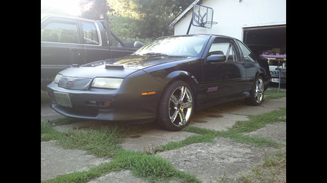

Re: Looking to get low pros and up Rim size any specs?
18"s fit pretty well. 225/40r18
