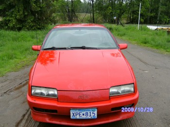

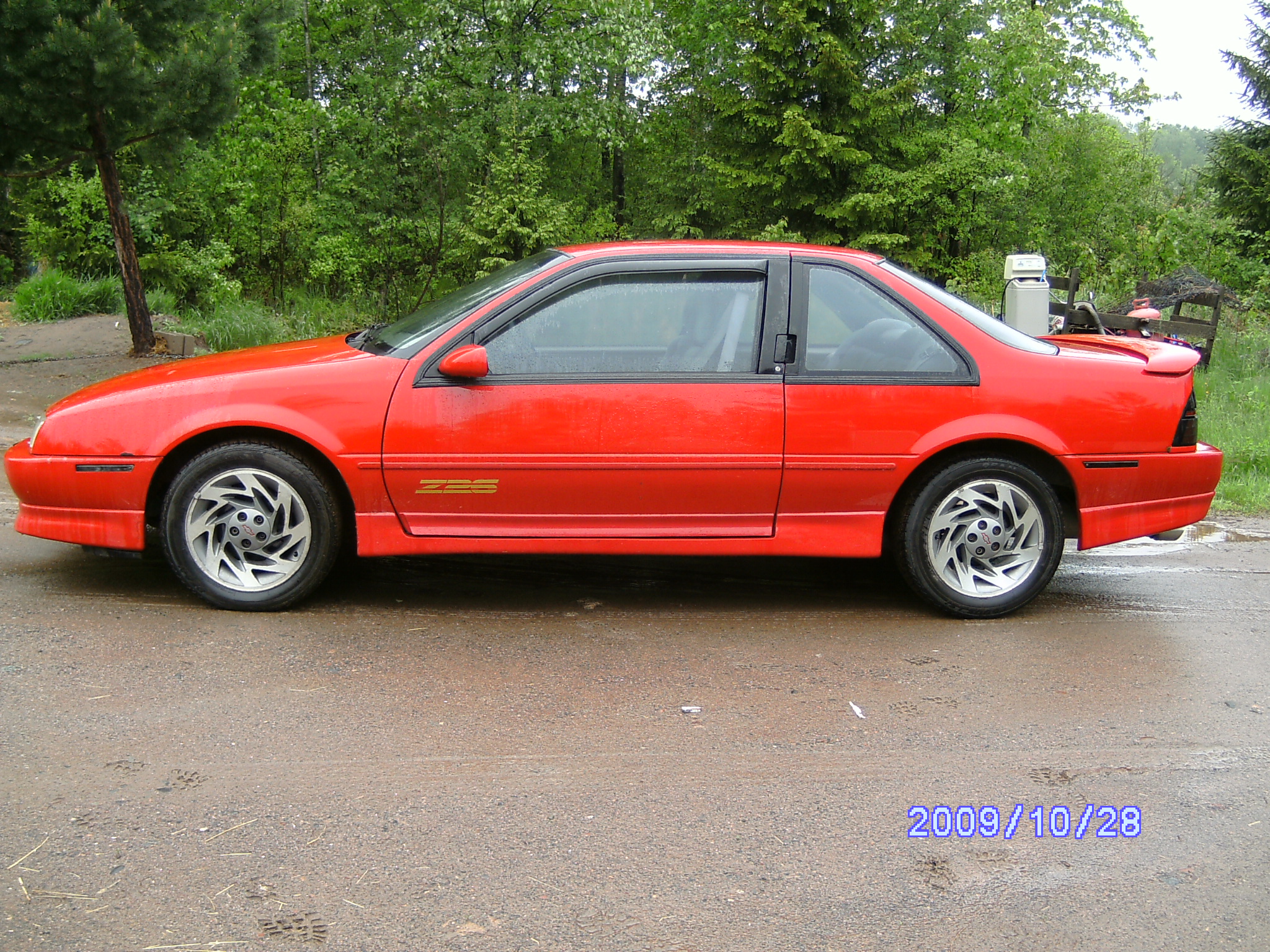

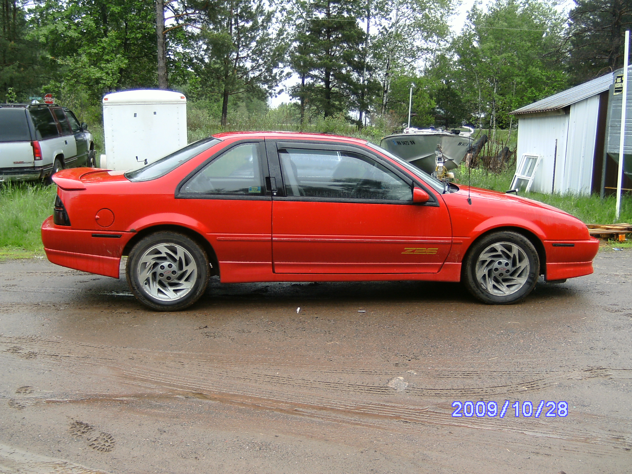

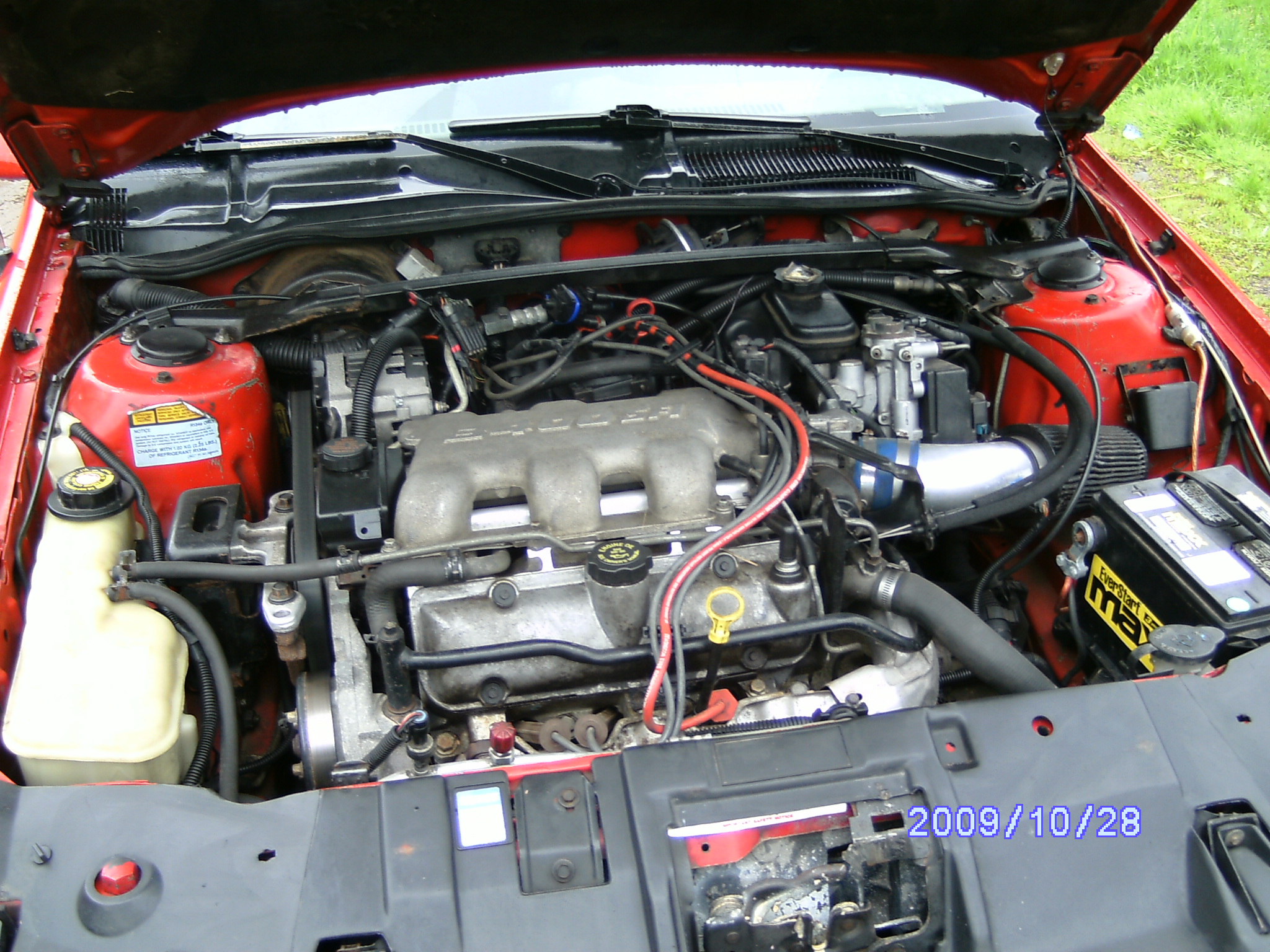

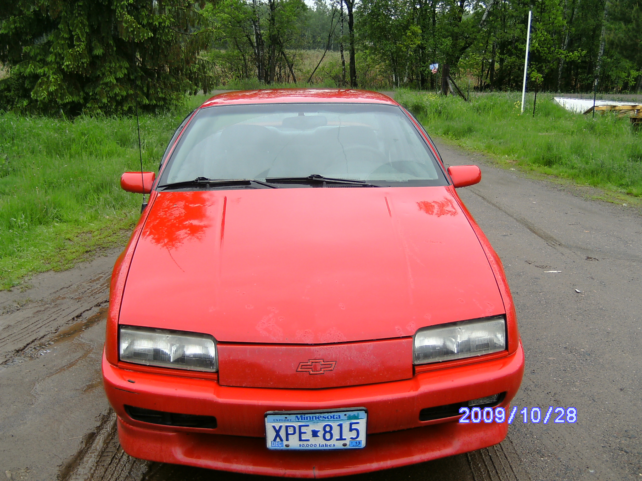

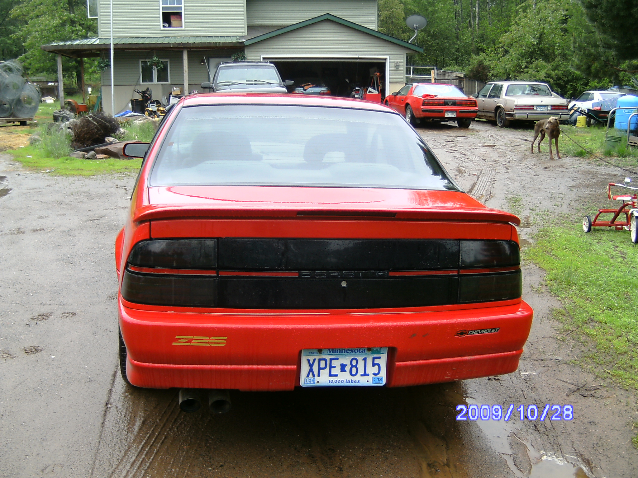

here is some picks of my z26 is has been in Minnesota all it life. The body has 231000 mils on and the engine and trans head 60000 in it win i bout it at 212000 miles. He put the engine and trans in at 195000 win the 3100 blue up and the engine and trans head 50000mils on them sens i bout it iv dune intact calipers intact CV shafts tune up and normal matins

Very nice clean looking car. Like 3X00-Modified said, check for the rust area common on these cars. There isn't really an economically feasible way to strengthen the Cavalier 2200 transmission, it just is what it is. I'm not saying it will disintegrate the first time you go WOT, in fact, I have a '97 Cavalier Z-24 with an intercooled turbo that probably isn't far off from the torque output of a 3400 (the 3400 is rated for 205 foot-pounds of torque, while the Twin Cam in my car is only rated for 155 foot-pounds, but the turbo certainly adds some, and HP output is a toss-up for who has more, but it is torque, not HP that eats transmissions), and it has been fine after a few years of driving around with this set-up.
