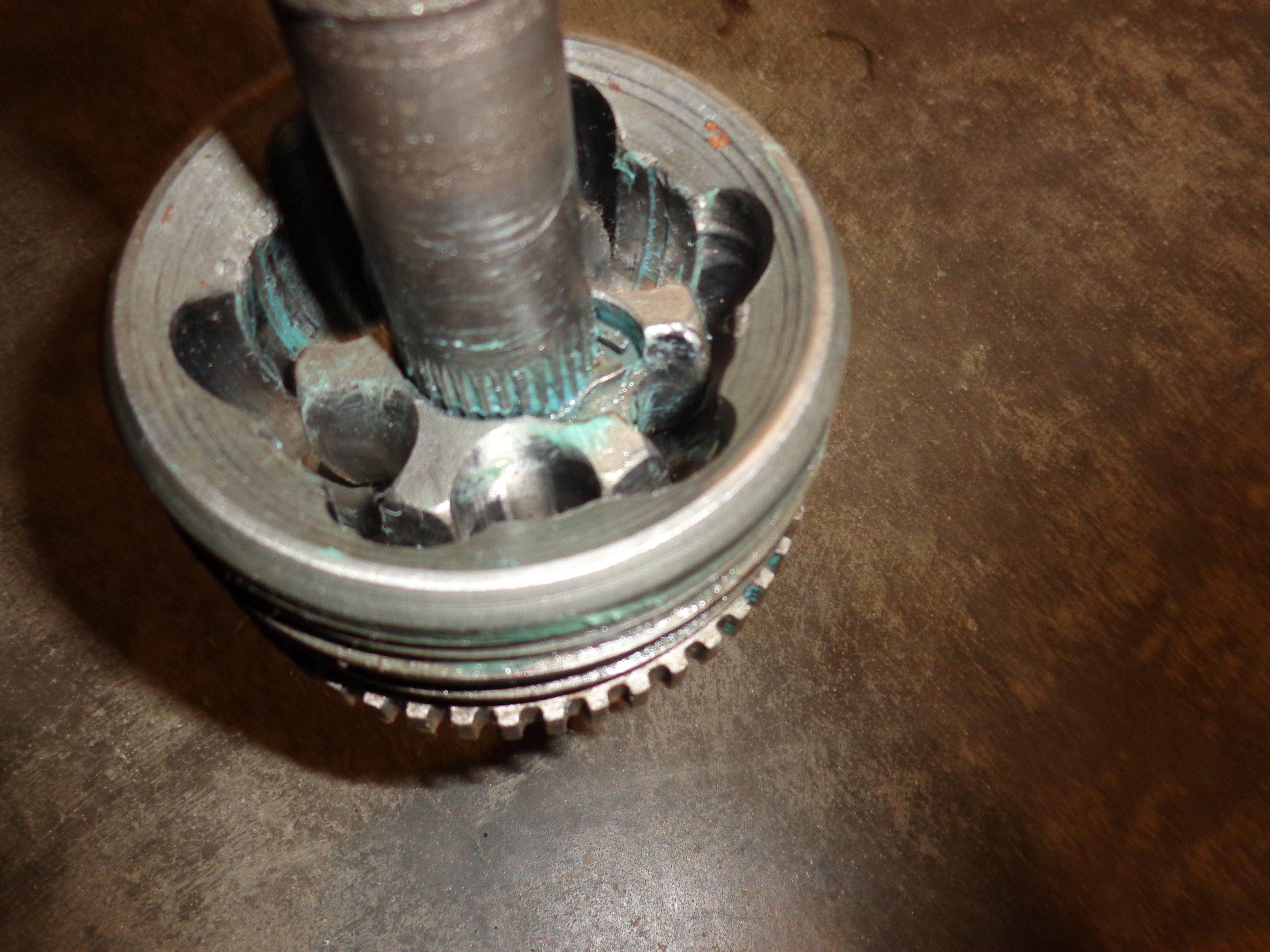

Yea its the 3 speed auto dss axles are way too much money to put into this car. But I seen that it didn't actually break it pulled out of the cup at the wheel. I got a idea but not sure how it would work. Since my car sees no street time all dirt and on the track im thinking about pulling the boots back as far as I can them and welding the splines from the shaft to the cups solid that way it couldn't pull apart.

Ok hopefully those pic attachments work. That's what I have am I missing a piece or is it just warn out that much? What my idea was to weld those fingers or teeth whatever you want to call them to the slots they ride on in the cup.

No. That would not allow the joint to move at all. You should have six giant ball-bearings and a cage that holds them in there. You COULD weld that six-pointed star-looking inner part to the axle shaft itself, but other than that, no. Wow, that thing is busted up... If that is where your joint keeps failing, I don't know if even trying to hybrid parts from a manual transmission's half-shaft would help, since I think the ball-and-cage part is about the same (the shaft diameter itself is bigger from the V-6 manual trannys) as yours. Definitely check to see if your suspension is over-traveling, or if it it somehow swinging outward (worn-out A-arm bushings, maybe?). That isn't normal...
