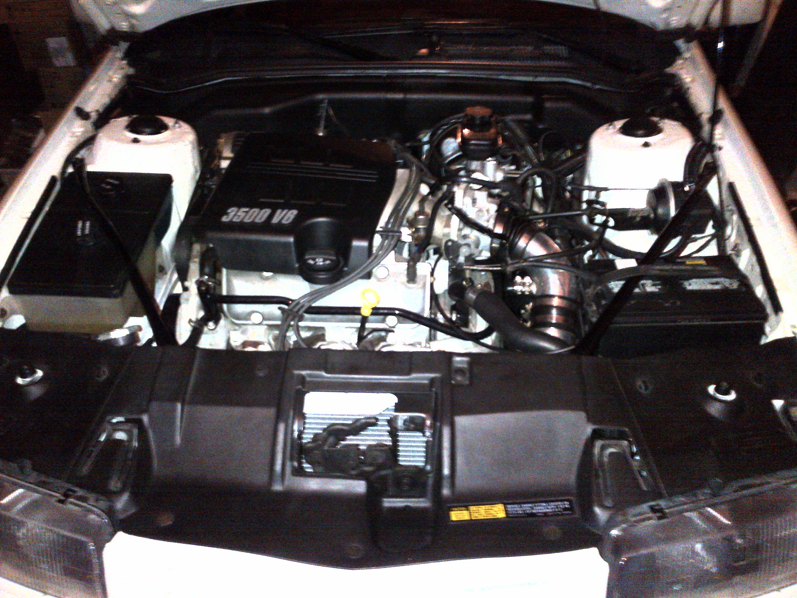

Sooo I bought this car.. 96 Z26 that was already 3500 swapped (still Automatic) and a few "progress pics"
The previous owner had a 97 venture 3400 upper intake and 3100 TB on it.. talk about a starved motor lol.

Then from a local yard.. picked up manual trans parts from a black 92 3.1 5 speed GT
Putting the Getrag on the 3500..
Here's a closer look at the motor (which only has 54k on it supposedly) and updating it with metal lower intake gaskets and '99 3400 timing set. IF you havent checked the timing chain on your 3500.. DO IT! Even with the low mileage of this motor the chain still had quite a bit of slack.
Heres a comparison of the stock 3500 chain and the much much better 3400 timing chain and gears..
Installed..
Here is how clean this motor is!
Installed..

Now to get rid of the nasty spray paint!
75% re-assembled! It may look like alot of silver.. but the alternator bracket and the motor mount bracket will be black (they still need sandblasted) and am still waiting on the 3500 upper so I can install that with the 3.5 olds tb and adapter.
That is all the progress caught up, hopefully starting on "tearing down" the black Z this weekendNow to get rid of the nasty spray paint!
