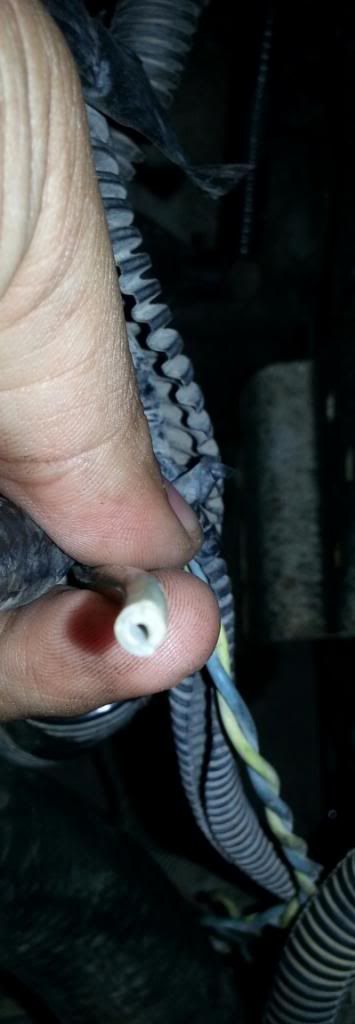

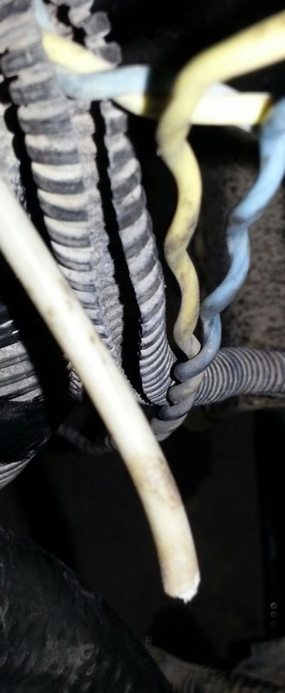

Now for another question, where does this little hose go? It comes out of the engine harness but I have no idea where it goes!
Heres some pics
'14 C7 Z51 7SPD
Re: Engine surges then stalls...
Looks like the vacuum hose that goes to the inside to run the HVAC.
