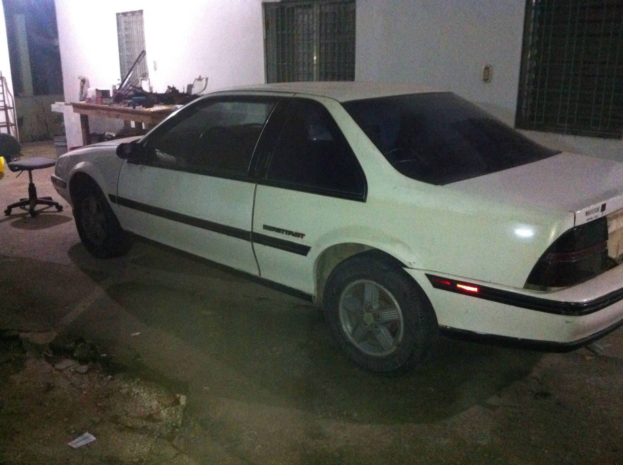

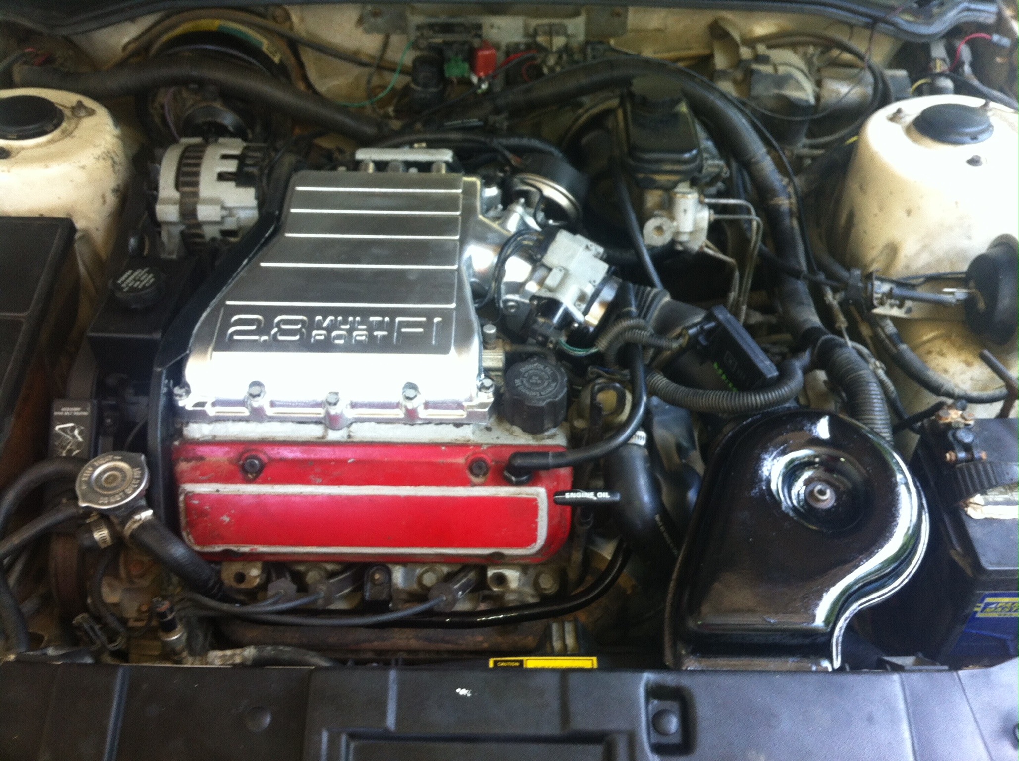

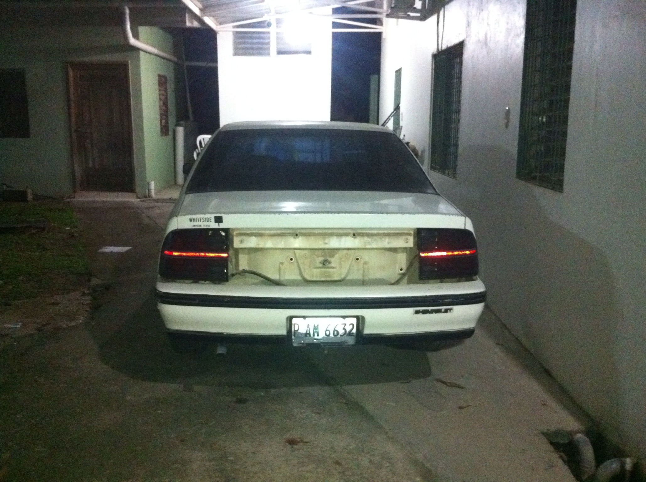

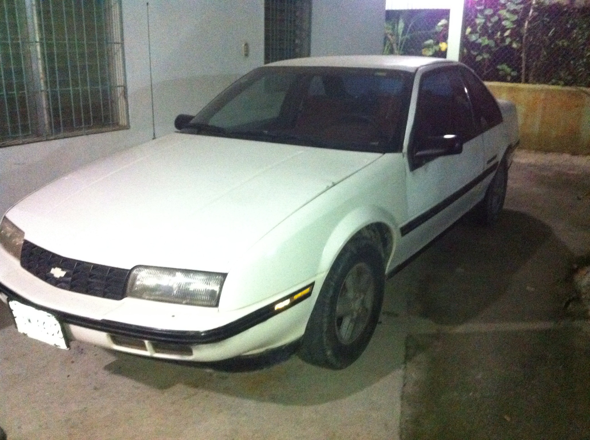

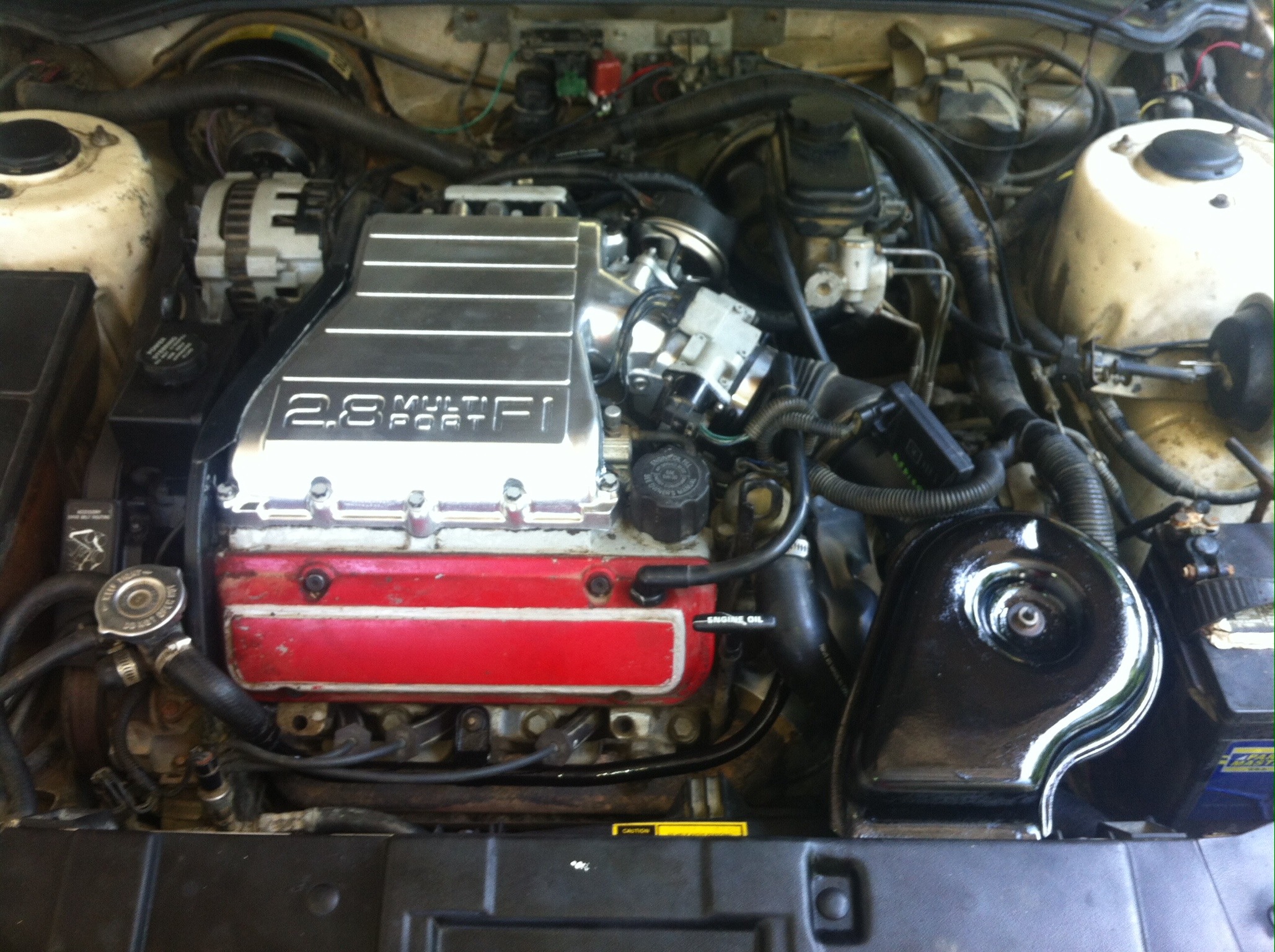

This my stock 1988 beretta gt and is also my first project car.
Heres my to do list:
Change color from white to red
Replace suspension
Add front and rear sway bars
Change tires and rims
Remove maf and replace it with iat + k&n filter
Bmw e36 headlights
Gtu spoiler
Replace all the split loom tubes on the wiring harness
Replace broken filler panels
Replace and repair brakes change discs etc
Repair dash as it is very damaged or replace it for a 91+ dash
Led lights on the interiors
Install a decent stereo with a good sub
Repair floor mats and seats maybe change their color
And the list goes on but for now thats all i can remember.
Also i would like to replace my current "single" turn signals for the split turn/fog lights ive seen on gtz' though for that i would some of your help.
Now to some background on the car itself:
My beretta has 103k miles on it and belonged to my grandad, now im fixing it for myself and have found so much trouble getting it to work correctly, and now the i have managed to fix most of the engine problems im heading towards the rest of the car so if any of you guys can give me any feedback on how to do things and what to buy etc i would appreciate it a lot.
I am perhaps the only user from Honduras(google map it
) and things are very hard for me to get in here so i just have to import stuff from the us luckily i already have that covered
so now im begining my journey into the beretta world!
Ill be updating the thread as i work so expect lots of pics soon

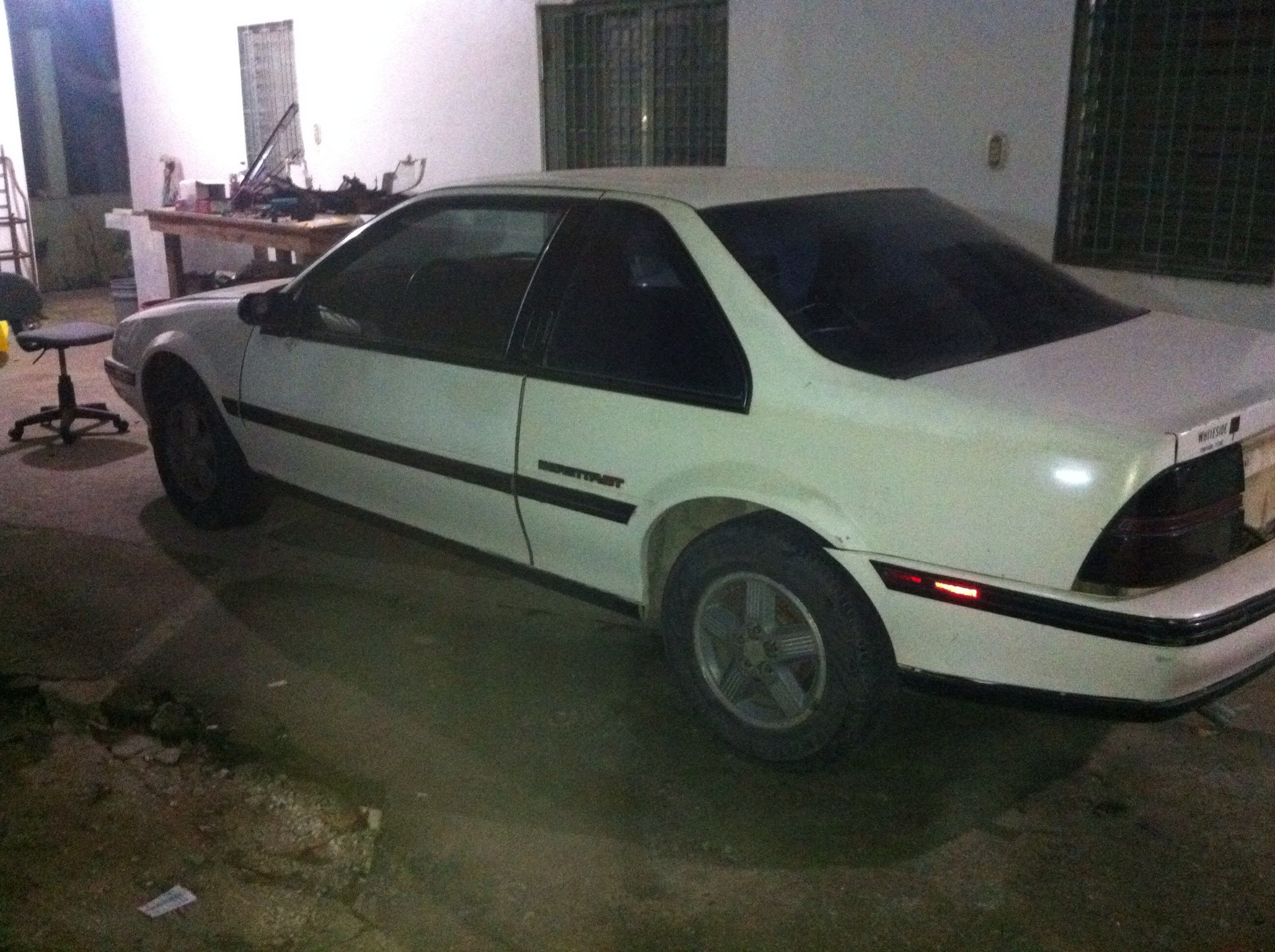

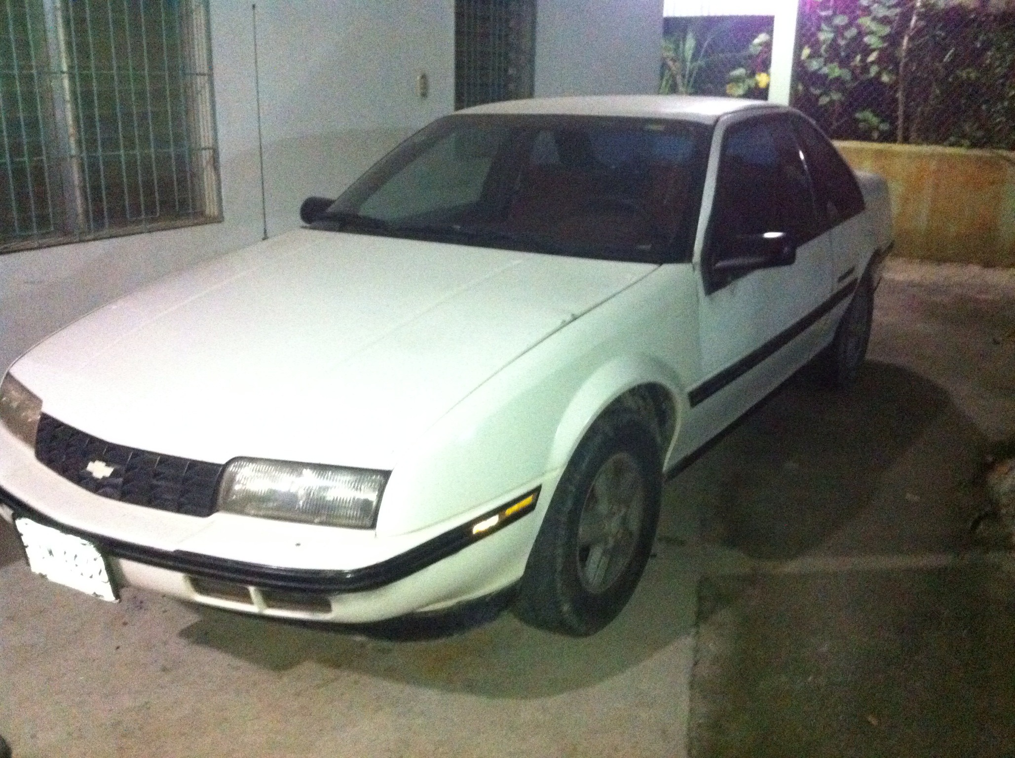

And theres a lot still to do, at least i changed suspension, brake discs, tie rods. Added the plastic dash cap, got my spoiler, installed stereo and alarm, plus subwoofer.
I have yet to install the new fuel sending unit, fuel pump, harmonic balancer and belt tensioner pulley.
