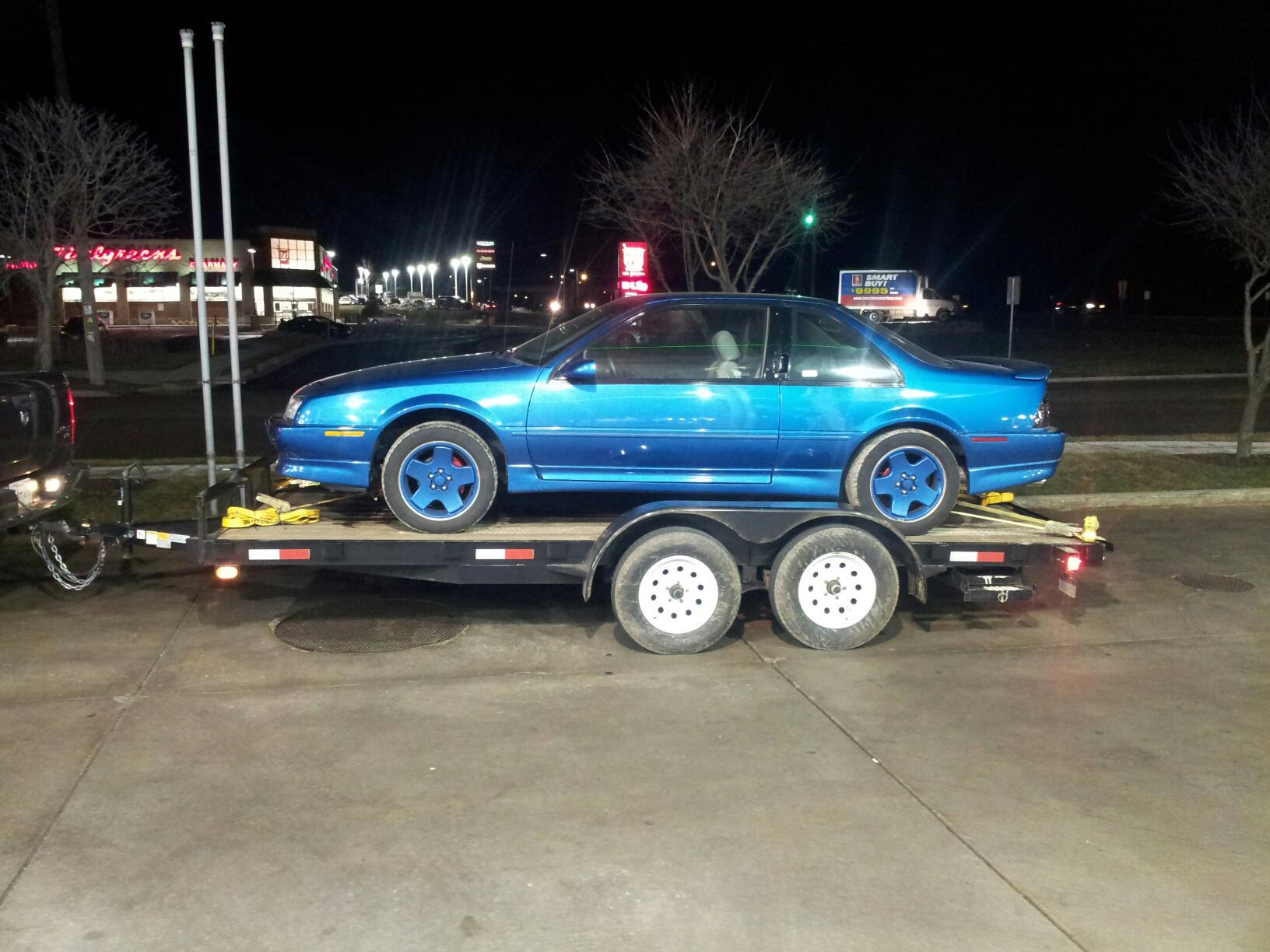

Where to start... I bought my current 1993 GTZ in Wisconsin. The engine was removed and mostly disassembled but the seller claimed it was all there. I got the car back to Tennessee and began to work on it. I found many things that were not consistent with a 1993 GTZ. The axles didn't have ABS teeth, the intermediate shaft was for a pre-92 car, the fuel rail was for a pre-92 car, the intake was wrong for a 1993 (and much more). Apparently, I was sold a 1993 GTZ with a bunch of parts from some other Quad4. The car also came with a 'rebuilt' cylinder head.
