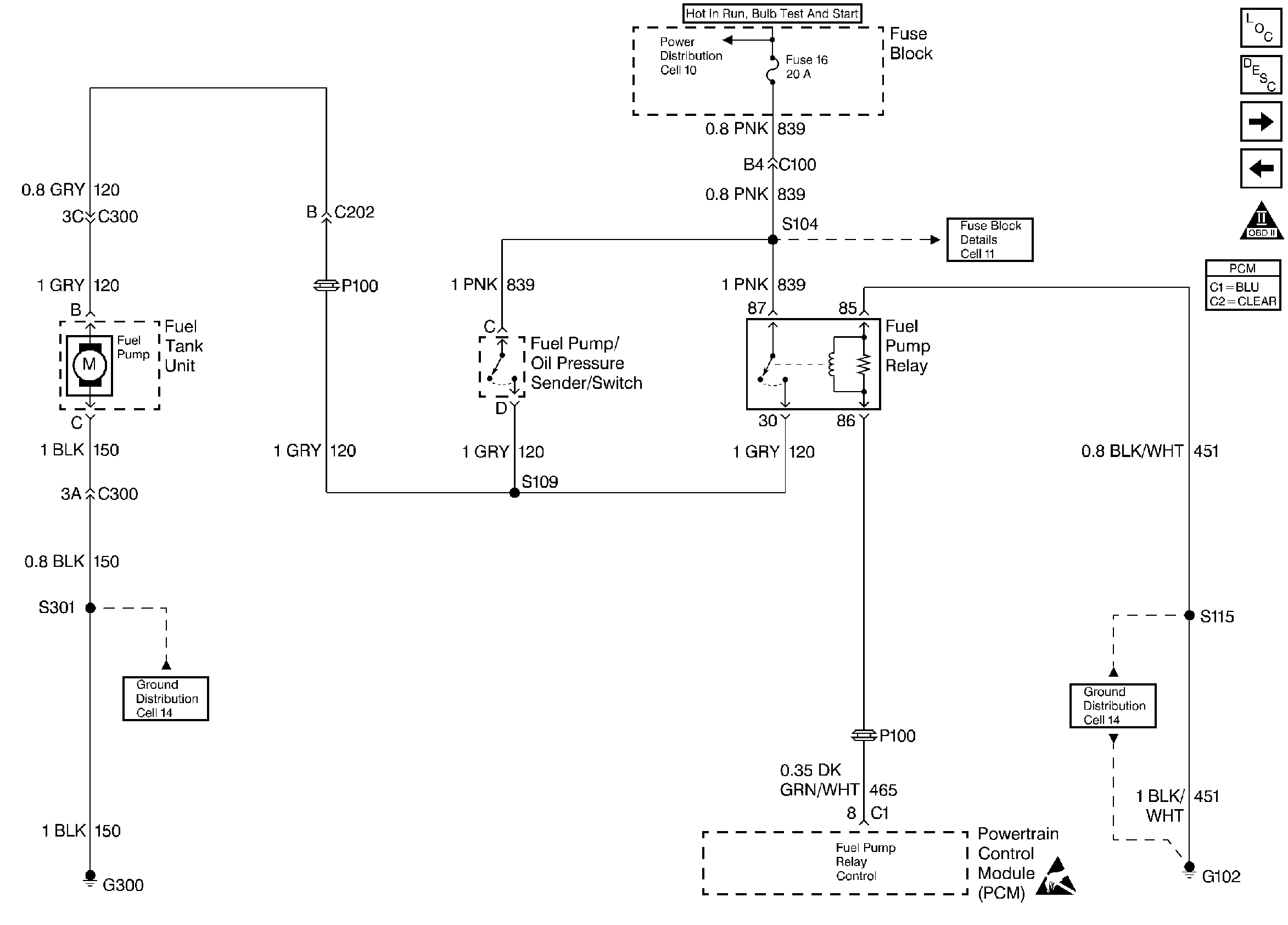

Post by Cliff8928 »
This might help

I assume you checked the fuse?
Posts: 10923
Re: '96 fuel pump does not come on with key
If it runs when he has oil pressure then it's definitely something up with the relay.
